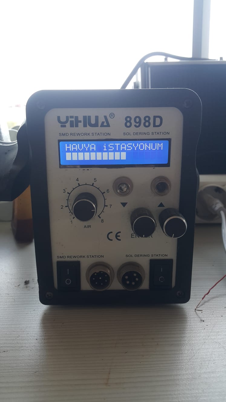

    I replaced my broken soldering iron station with this pcb. For anyone who needs it. I did i use

      Hello master ivica,
      I have been using the device on the connection for years, it seems there is no problem.
      I don't think you need expensive equipment.
      Best regards

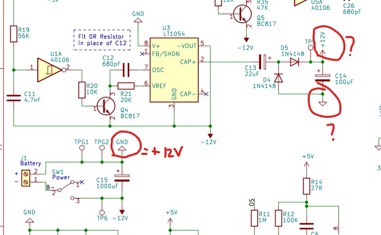

          Hi friends,
          can anyone hint this rookie to electronics to depict this?
          ground is +12V. right?
          and this C14 is connected +12V and Ground (+12V)?
Name:	Screenshot 2022-02-18 .jpg

            sorry, disregard previous post.

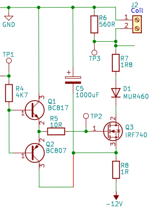

                        Hi Olly,
                        schould not be the connection of R8 & C5 in the TX driver circuit like the red connection in the image below?
Name:	Beachmaster TX Driver.png
                          Hi Olly,
                          [ATTACH]56849[/ATTACH]
                          Hi GeoMax,
                          It wouldn't make any real difference if it was connected as you indicate, although it would still work fine.
                            Hi Olly,
                            yes, I have no doubt that this makes a difference. Its ony not 100% correct drawn.
                              Hi GeoMax,
                              Actually it is 100% as I intended so not really an error unless there's a good technical reason to change it.
                                Hi Olly,
                                for sure it will work as intended. The resistor R8 also limits the TX current. In your circuit, the current has the possibility to bypass the R8 throughout the transistor.
                                In my TX circuits, I draw it always as seen in the previous uploaded image.
