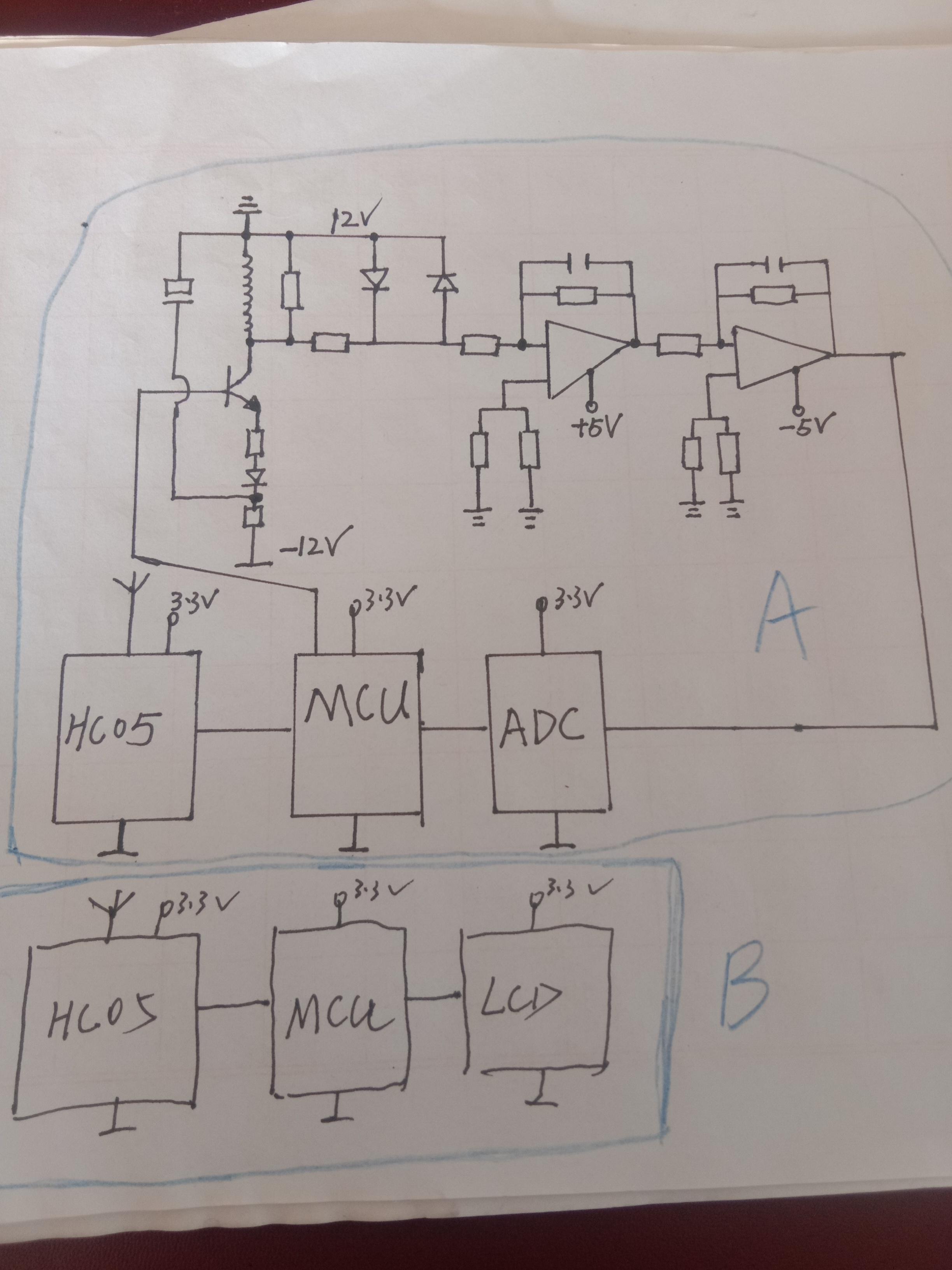

Perhaps these queries should be in a thread of their own?Originally posted by jeep6789 View PostHello! I want to make a wireless detector with Bluetooth and single-chip mechanism, because the op amp is required to ? 5V level, single-chip microcomputer and Bluetooth 3.3V, then in this circuit, how should I generate ? 5V and 3.3V?[ATTACH]57089[/ATTACH]
Hi jeep6789,Originally posted by jeep6789 View PostHello! I want to make a wireless detector with Bluetooth and single-chip mechanism, because the op amp is required to ? 5V level, single-chip microcomputer and Bluetooth 3.3V, then in this circuit, how should I generate ? 5V and 3.3V?[ATTACH]57089[/ATTACH]
You just need to extend your main board or build a small board with regulators that will give you power in; +12v, -12v, 5v and 3.3v out.
Beachmaster (and any mono-polar PI design) has single-ended sensor so a differential amp won't help. However, we can take a late sample and subtract it to suppress interference. This is another form of differential amplification.
No, it's correct where it is, its purpose is to decouple the Mosfet Coss from the coil and facilitate a faster flyback falling slope.Originally posted by jeep6789 View PostIs Mur860 to reverse, should it be placed between the S pole and -12?
The MUR460S would probably be a slightly better choice as it's max reverse recovery time is a bit quicker but the 860J seems easier to find in SMD.
