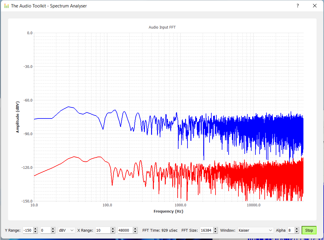

          Very clean with input shorted, around 12mV pk-pk noise on a scope trace.
          Here is the noise spectrum of the preamp output with input shorted, the blue trace is the preamp output, the red trace is unconnected.
          -60dBV is 1mV.
          Do you use the figure 8 as a mono coil?

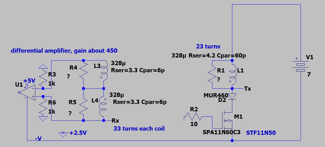

            Figure8 Rx, separate Tx. R1=pi*L*SRF (after shielding with cable, located at circuit board). R4 and R5=pi*L*SRF (before shielding no cable, L3 and L4 not connected, located at the coil)*(1.5 to 2).
            Haven't tried direct sampling with an A-D.

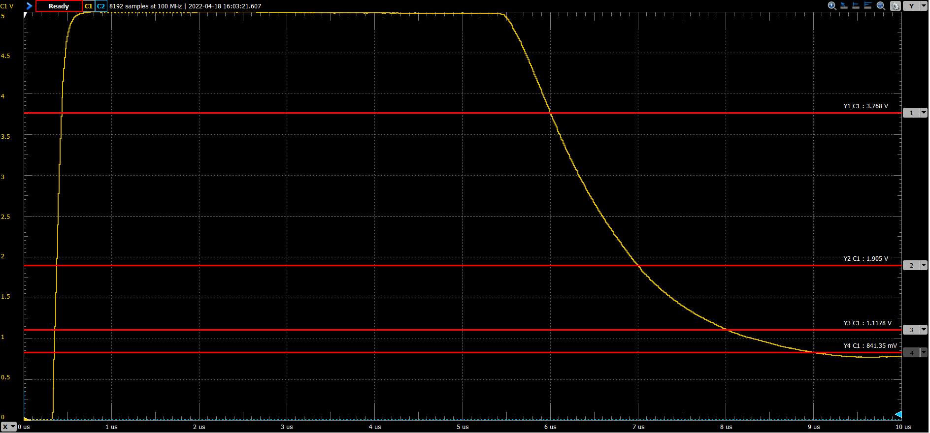

                I haven't got round to trying a Fig8 coil yet, but have discovered that these opamps don't like the DC offset being adjusted via the non-inverting input.
                I get far better results when employing the standard method of grounding the non-inverting inputs and applying the DC offset adjustment via the inverting input of the first stage, will amend schematic and PCB layout accordingly.
                The good news is that the configuration of Diodes D2 and D3 to only give me a positive going output for the ADC works very well.
                Using a 3DSS coil and timing my capture to a lull in the radar generated noise, I get the following amplified decay curve which allows me to sample as early as 6uSec.
                Will assemble the ADC converter circuitry next...
