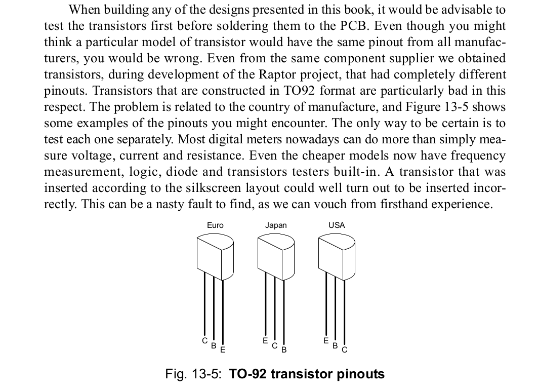

                            What are you seeing on the scope at the collector of Q1?
                            Are you sure there is a sync pulse there?
                            Depending on the origin of some of these transistors they may have different pinouts than expected.
