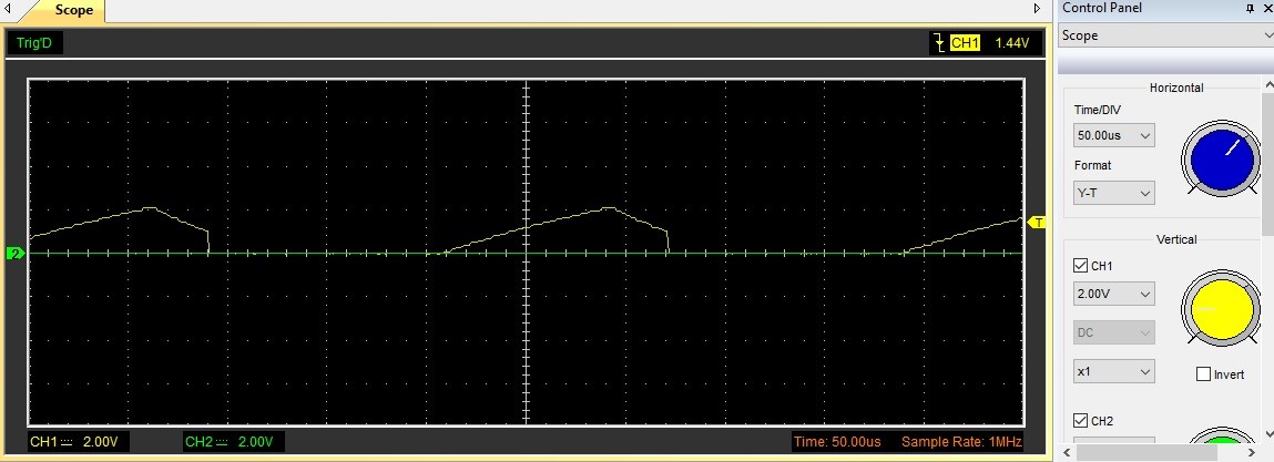

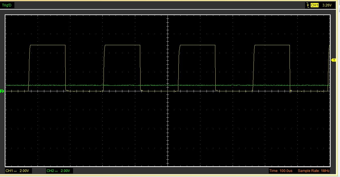

    i think its the OSC pulse being shared is causing the problems if you lift one of the OSC pins it works this is what i get on the OSC why do you need to sync the OSC anyway ?
    Click image for larger version  Name:	work.jpg Views:	0 Size:	89.4 KB ID:	434867
    • #62
      If you don't sync the voltage converters, and allow them to run with the internal oscillator, then any switching noise will be asynchronous.
      As you can see from my measurements, there is no problem with sharing the OSC pins.

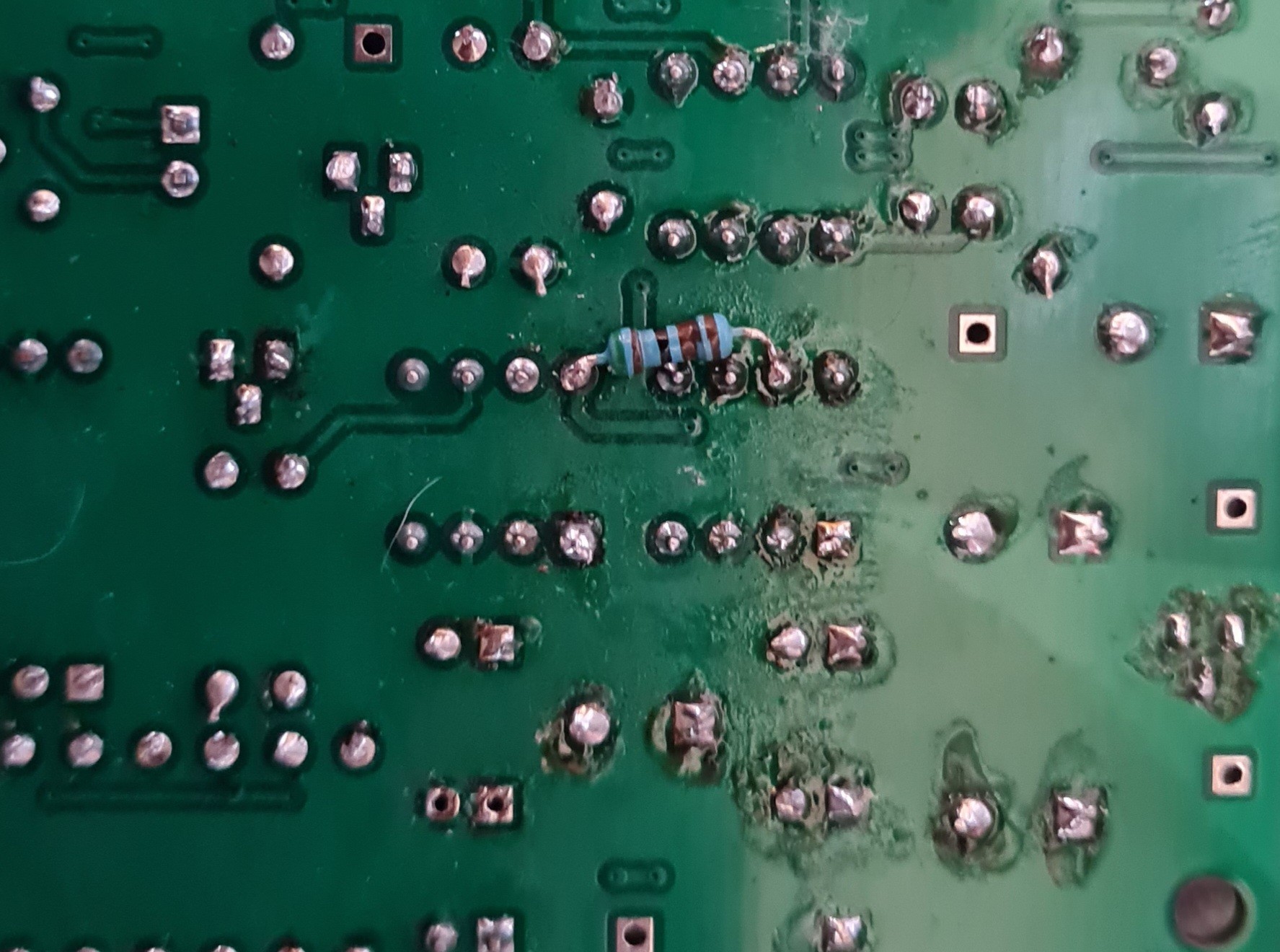

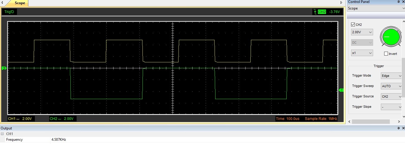

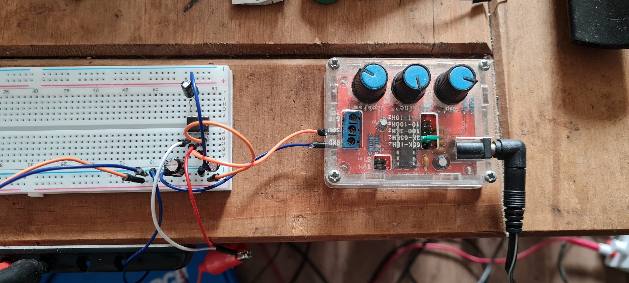

        Click image for larger version  Name:	bread.jpg Views:	0 Size:	499.4 KB ID:	434957 Click image for larger version  Name:	testbre.jpg Views:	0 Size:	82.7 KB ID:	434958 Click image for larger version  Name:	test.jpg Views:	0 Size:	89.5 KB ID:	434959
        same frequency voltage when i test on the breadboard it works fine i put the same chip in the detector i even used the 5v on the Arduino with a 10k pullup attached to the OSC to make sure the clock is fine but still no negative voltage as you can see also i have bought chips of 5 different vendors i just cant work it out

        i even tested that chip by exchanging the output capacitor for a resistor so you can see it syncs

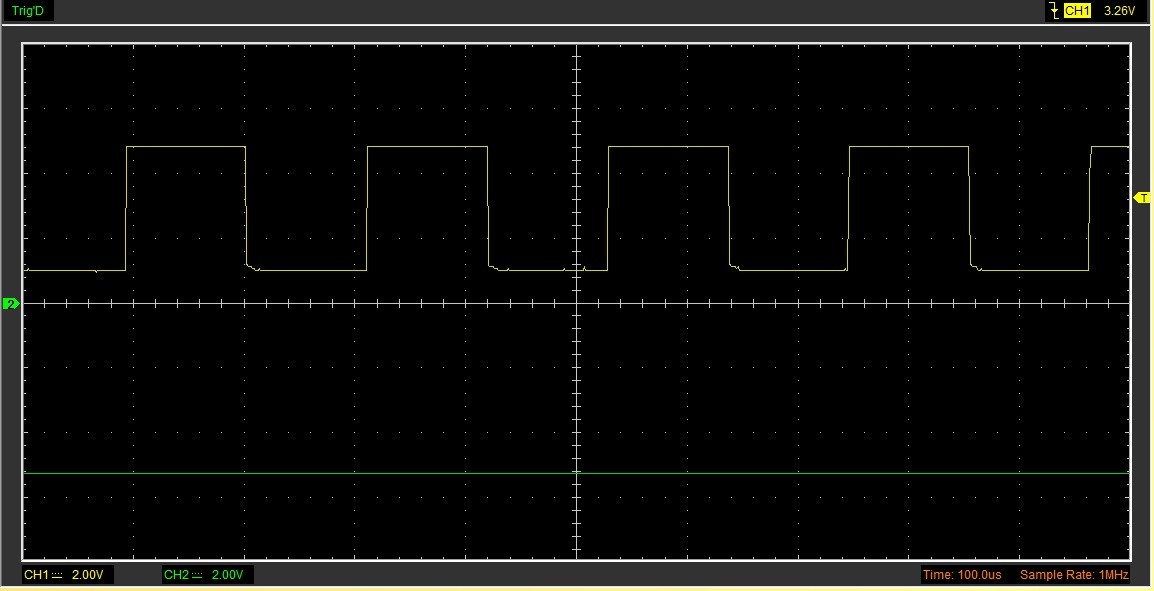

        • #64
          ok i have worked it out the OSC needs a stronger signal to work so pulling it up to 5v is not enough so i used pin 8 +12 and pulled pin 7 OSC up with a 5k resistor

            • #66
              Oscillator frequency VCC = 3.5 V to 15 V so 2.5 is not enough i tried with the 5v pullup that wasn't enough it needed just over 5v so i pulled up using the 12v it might be something to do with a 5v pwm 50/50 only gives you 2.5v just at the lower part of the trigger

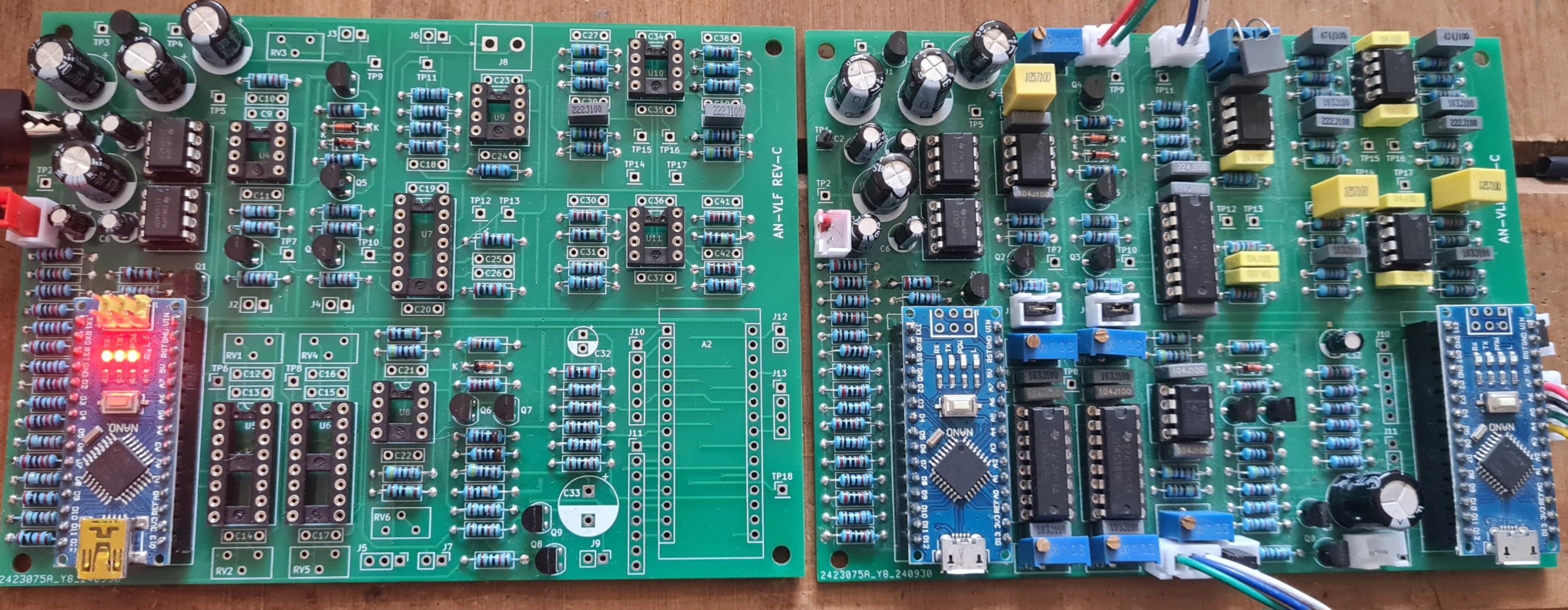

ID:	441184 5 diffrent batches all not working unless it's the garret ace sketch
                        • #72
                          Originally posted by kosacid View Post
                          As GeoMax said, did you build it step-by-step?
                          It certainly looks like you just populated the whole board before testing the -5V supply.
                          • #73
                            In the left image, there are already too many components installed for my taste. I would first place only the components relevant to the power supply and only continue once the correct voltages are measured. It's possible that your second batch of LT1054s is also fake.
                            • #74
                              5 different batches all the same what's the chances ? 2 different boards one fully build one just the sine wave and negative voltage
                              • #75
