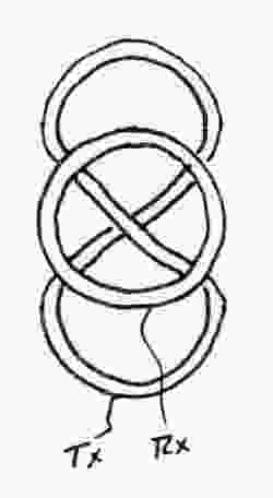

Differentiating coils will give a negative signal half the time. These coils have a figure 8 winding and have a signal null along the centerline of the coil. On one side of the null the signal will be positive, and on the other side of the null it will be negative. In some coils the null runs from front to back. In this case as you sweep left and right all targets cross the null and produce both + and - signals. In the Bigfoot coil the null runs side to side so targets under the front half of the coil give a + signal, and targets under the back half give a -.
