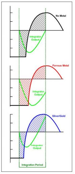

                      Moodz, I'm not sure how you establish your discrimination but I picked up something from the web that may be of use.
                      It's based on sampling around the zero crossing and integrate a section of the X and R component of the signal.
                      Well, probably best way to explain is to have a look at the attached pictureClick image for larger version

                        Achillion, I have seen that one before but thanks alot anyway .. if it is the one I am thinking of with the box car integrator in software it is OK in air but needs more work to track the ground and still discriminate. The difficult part is doing it with weak targets eg at long range or small targets.
