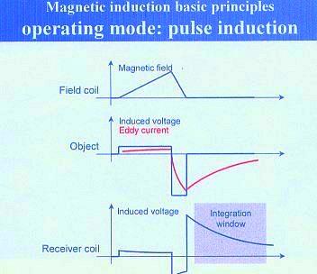

      I think eddy currents begin to flow in the target at pulse switch off, or when the magnetic field begins to collapse, as shown in these pics.
      • #63
        Can you give source book?
