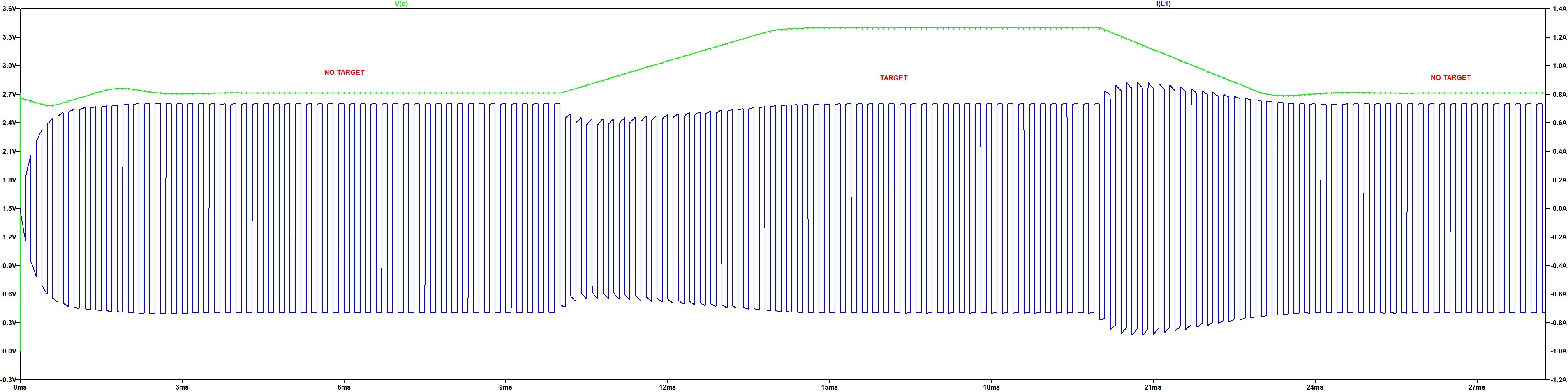

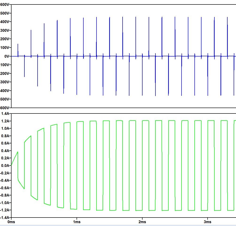

    I posted a bipolar current pulsing scheme with tilt correction for a monocoil TX a while back in the bipolar alternative H bridge thread
    https://www.geotech1.com/forums/foru...628#post410628
    So basically that circuit CCPI used current sensing in the TX coil to drive a feedback loop with considerable gain to correct "TILT" in the TX current pulses.
    It would seem that this tilt is caused by losses from the TX coil energy and mostly due to energy lost during the flyback transition time .... which kinda makes sense if you think about it.
    However it then follows that not only must tilt be corrected but also the amplitude ( which is also effected by energy loss ) of the current pulses in the TX coil.
    The assumption being that either a change in Tilt and/or Amplitude will cause a change at a recieve coil.
    Its easy to show ( using the CCPI ) that a target / ground losses in proximity of the TX coil will cause tilt and / or amplitude variation of the current pulses in the TX coil.
    Observing the tilt correction feedback voltage it can be seen that the feedback voltage will vary with ( tilt / amplitude ) so what this means is that a target may be detected by monitoring the change in value of the feedback loop control voltage as the coil is moved near a target.
    Thus this is a means of detecting targets and ground condition using only a monocoil with continuous bipolar constant current pulses. ( aka CCPI )
    Likewise by varying the frequency and/or duty cycle of the bipolar pulses other information may be determined from the tilt loss ratios at different pulse / duration rates.
    Dont worry I will also include a RX coil so in case the mono coil sensing does not work out.
    moodz

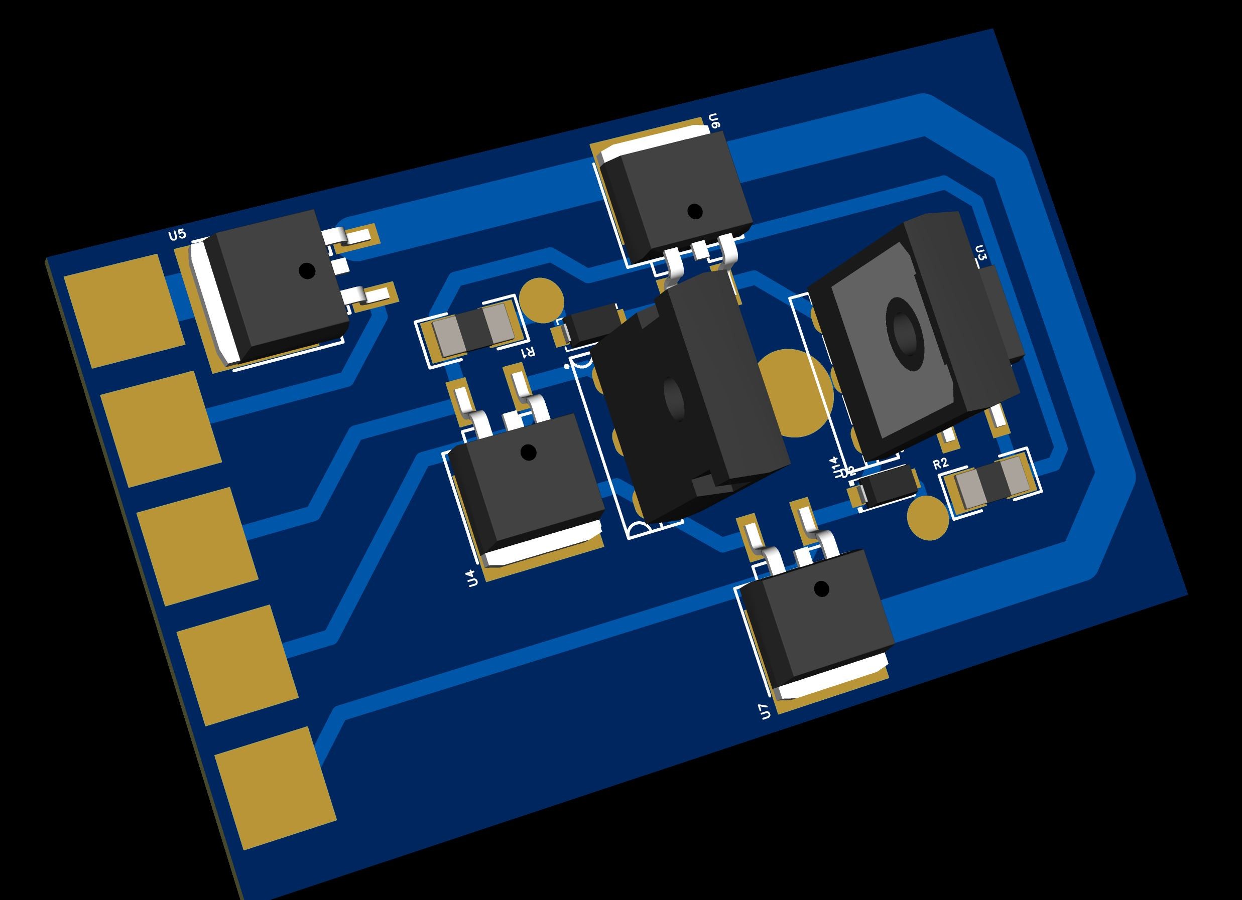

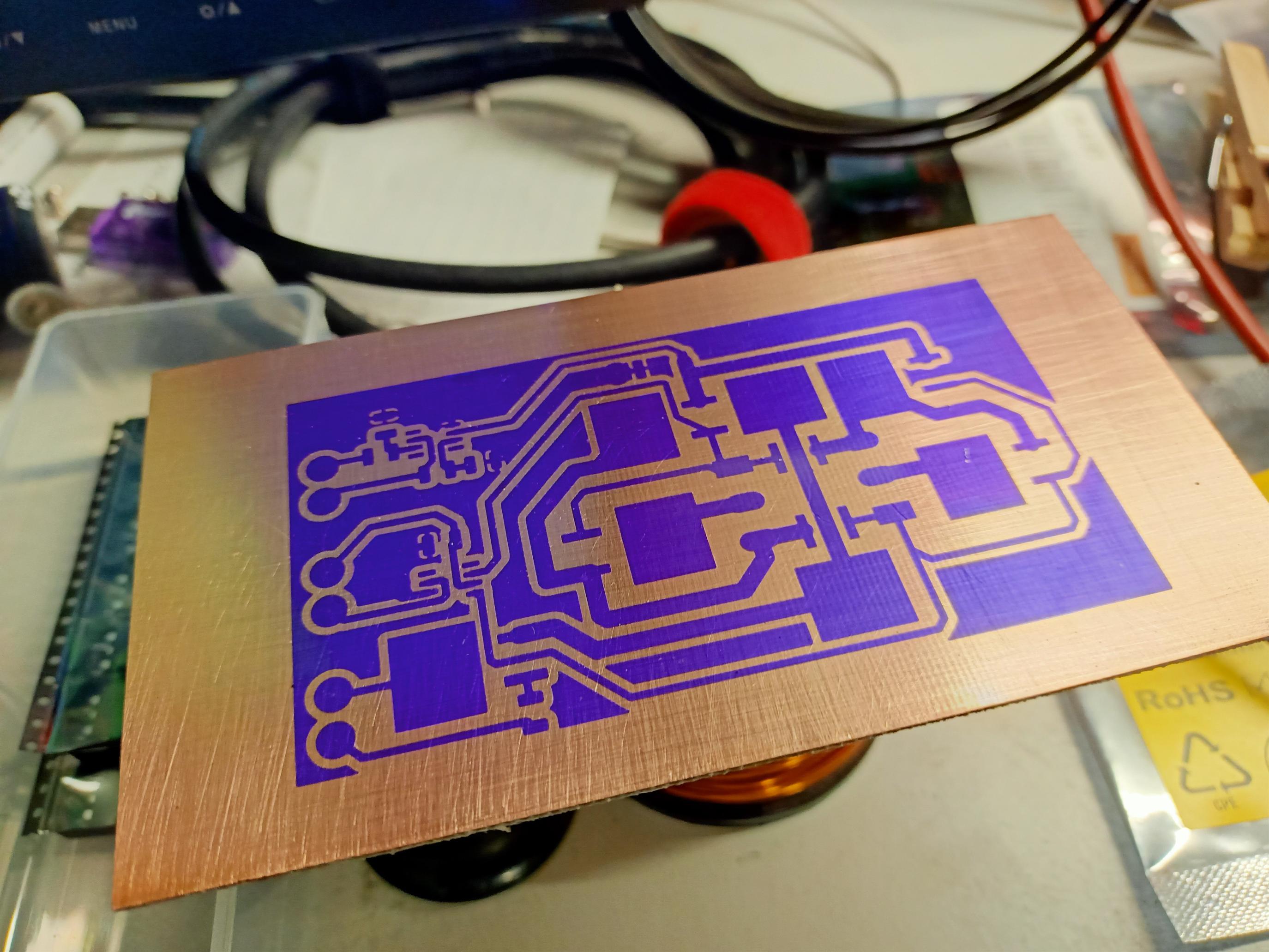

            ...TX test board scheme. ( with tilt control mosfet )
            [ATTACH]n412635[/ATTACH]
            .. PCB layout
            [ATTACH]n412636[/ATTACH]
            .. 5 minutes later from the resin printer
            moodz

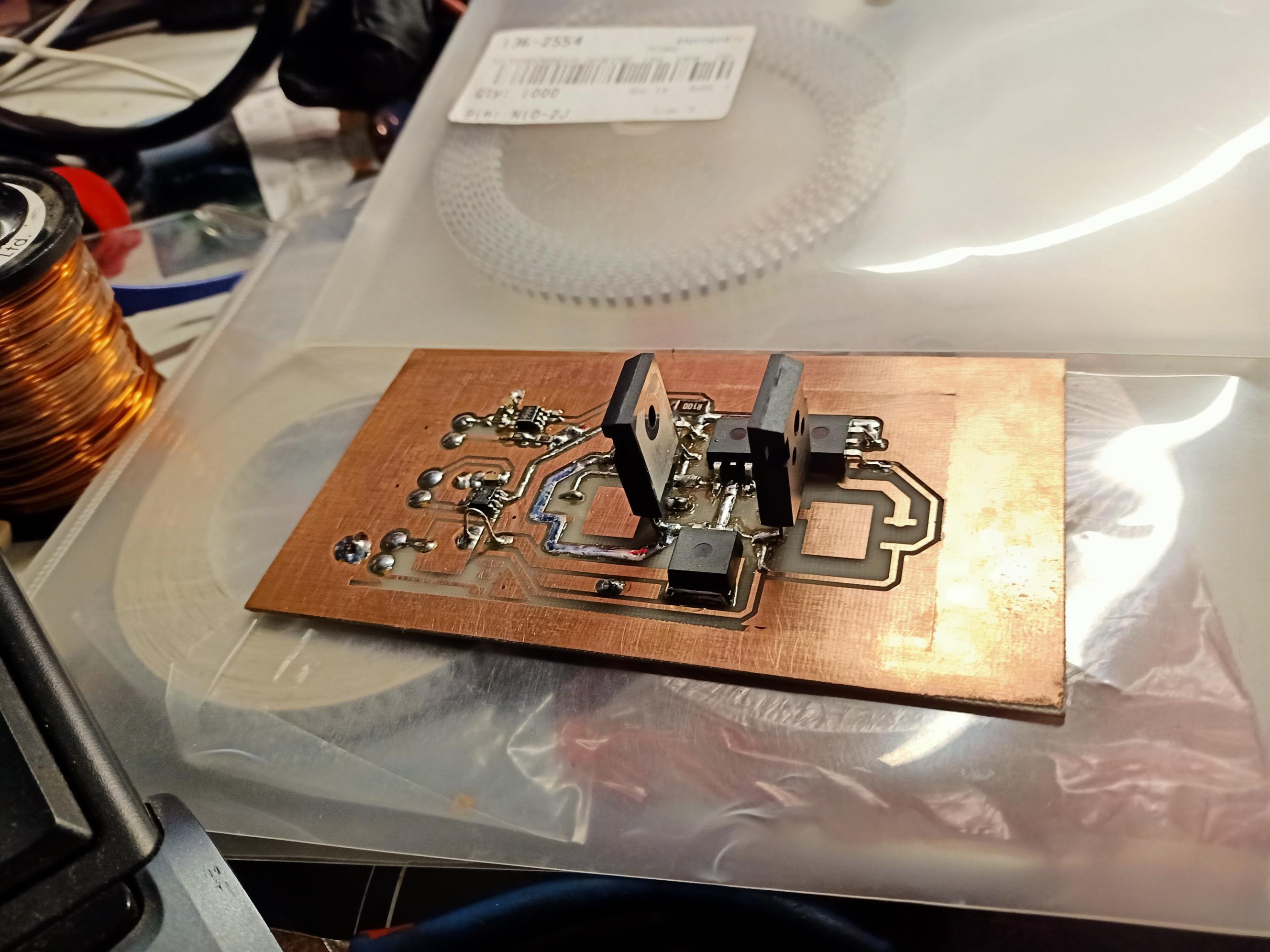

              .. and the built up board. Its all single sided with a ground plane for simple fab.
              The tilt control FET is not fitted ( thats on the other board )
              I will smoke it tomorrow ...

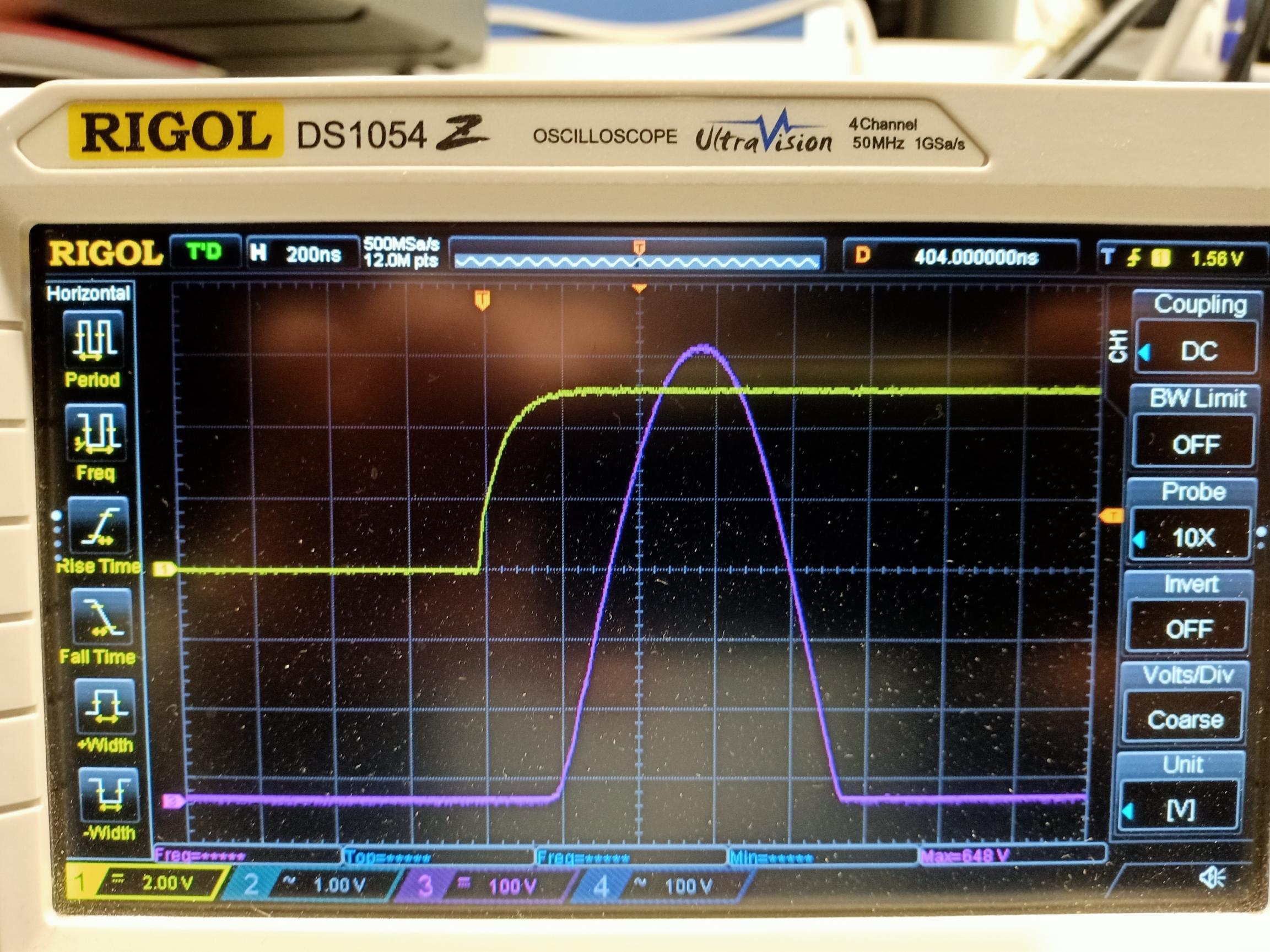

                ... managed not to let the smoke out.
                1 amp peak to peak and 650 volt flybacks with about 700 nanosecond transition.
                The coil is a fast basketweave litz wire 0.5 ohm mono.
                Slight Tilt but nothing to write home about .... I am starting to think DSP will take care of it

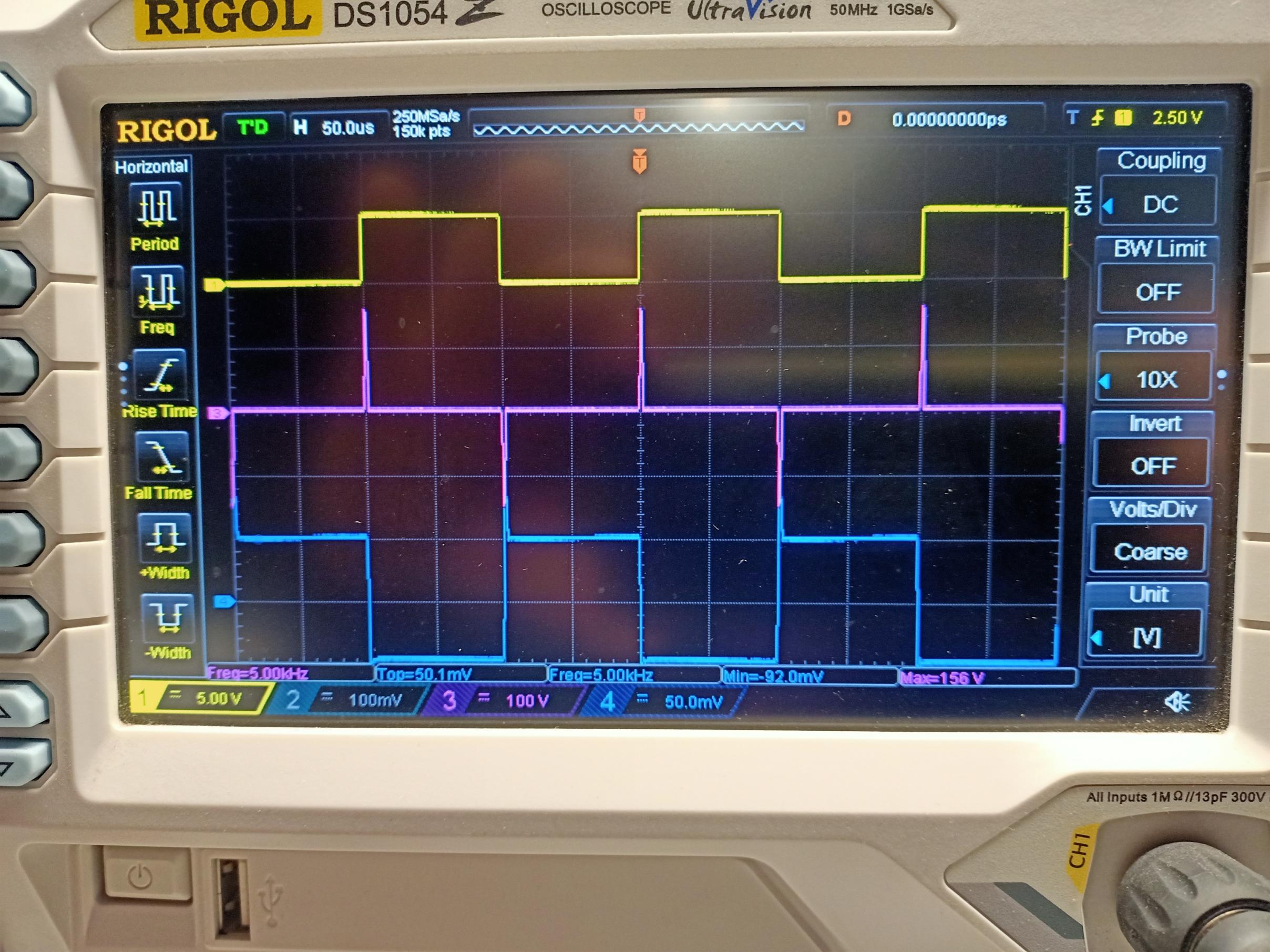

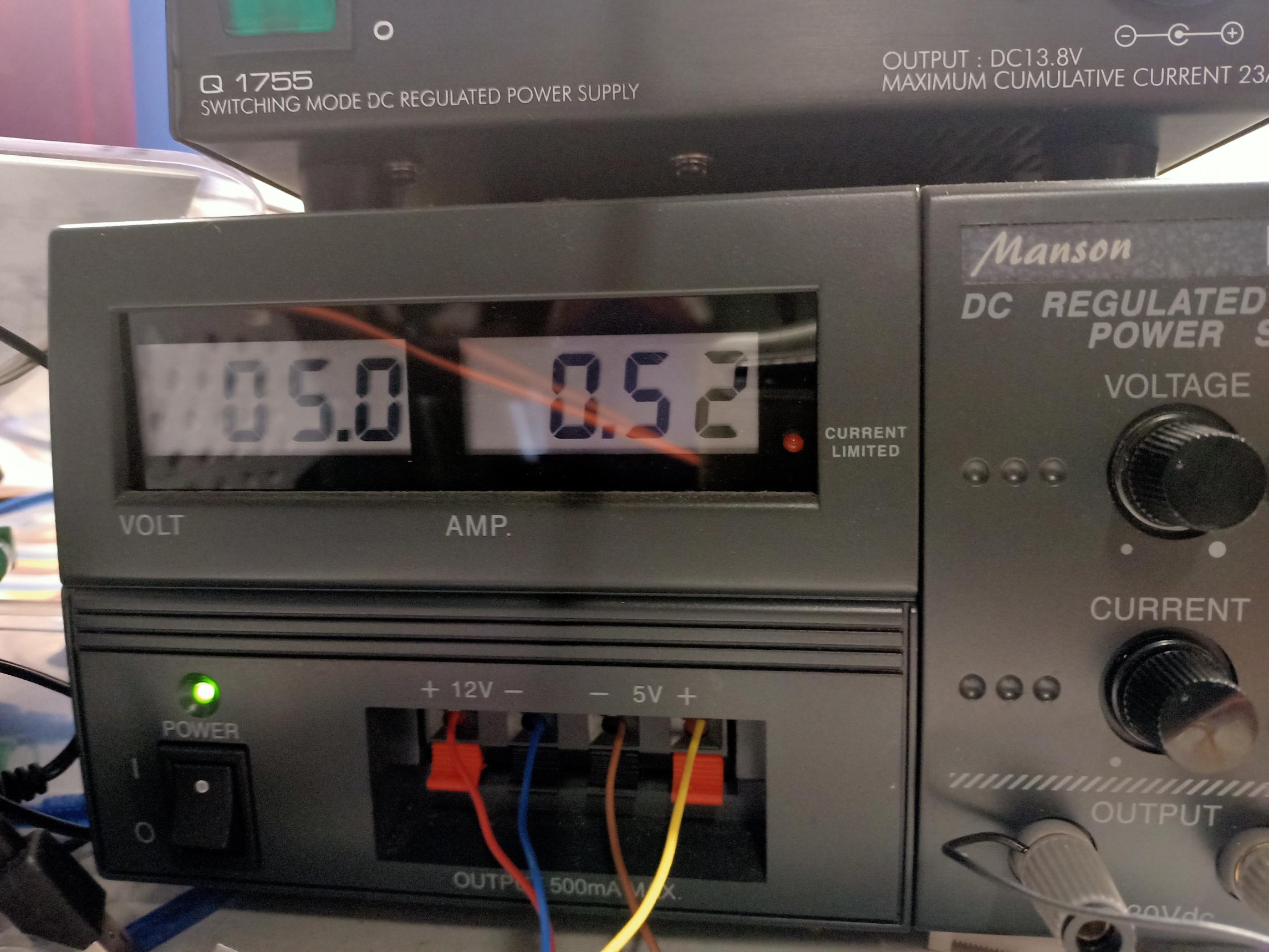

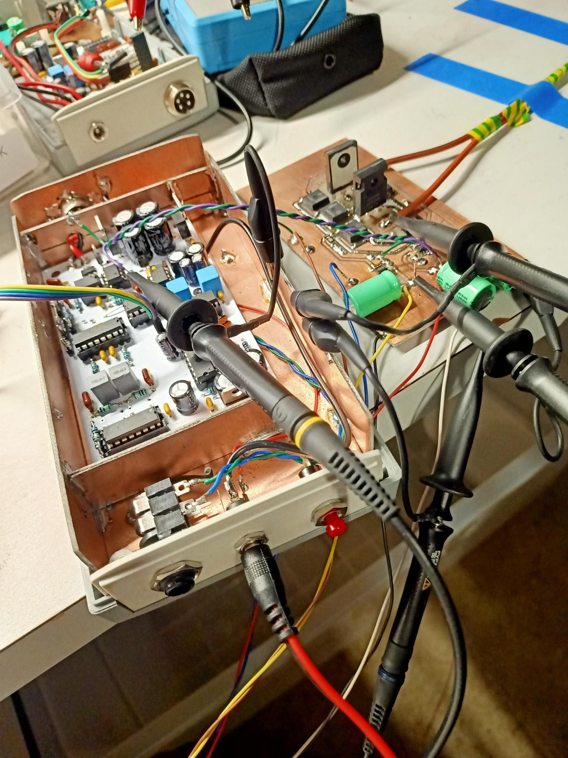

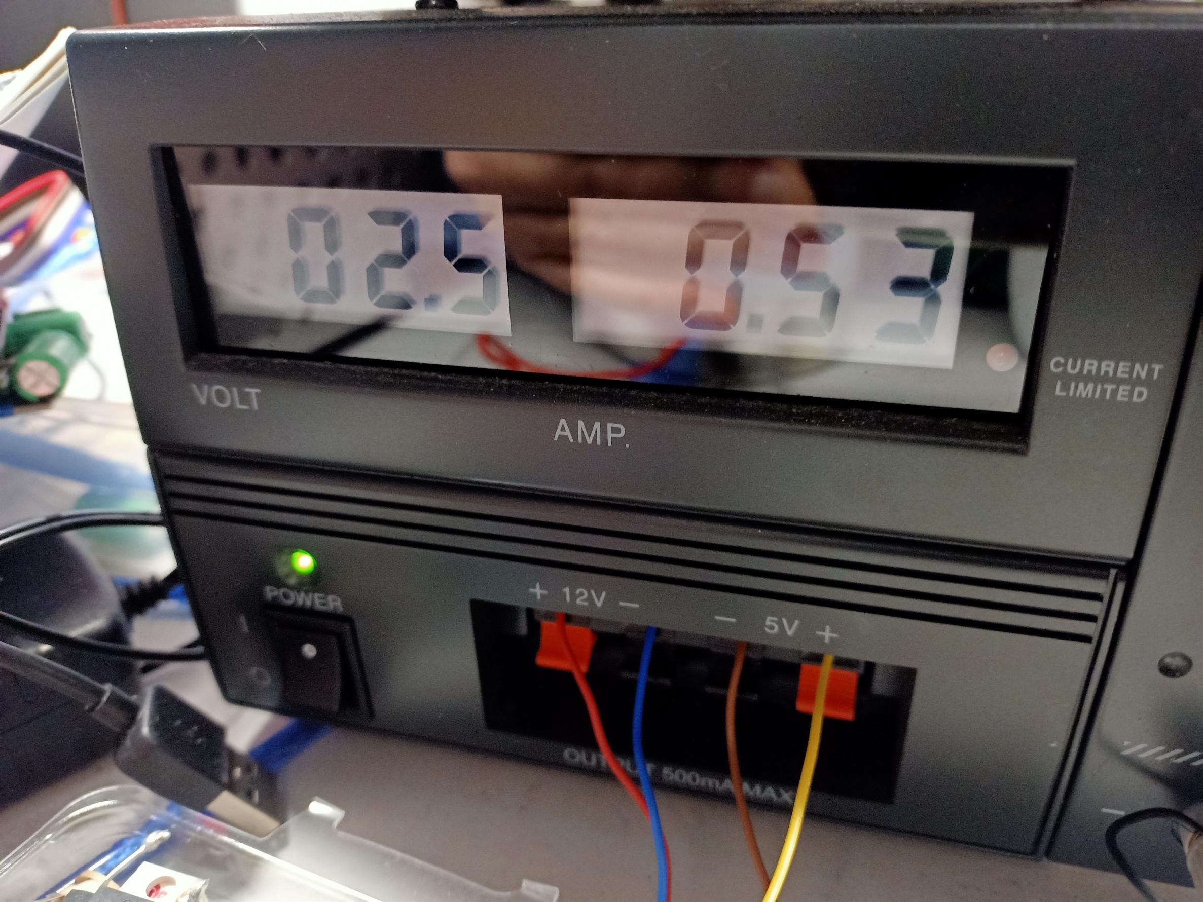

                      ...slaving over a hot soldering iron all day has resulted in the intial results for the transmit circuit and so far it is matching or exceeding the simulation results.
                      with moderate settings ( to avoid smoke )
                      In PI mode ...
                      0.5 ohm TX coil / 300 uH ( your fairly standard PI TX coil )
                      1 amp peak to peak with 3 microsecond transitions and power supply = 2.5 volts @ 500 ma = 1.25 watts consumption.
                      Yellow trace = gate drive
                      Pink trace is flyback at TX coil
                      Blue trace is 0.1 ohm current sense resistor.
                      Notice that tilt correction is applied ( very simple solution ).
                      next I will be testing the VLF mode
                      Click image for larger version  Name:	mono_power.jpg Views:	0 Size:	478.8 KB ID:	412790
                      Click image for larger version  Name:	mono_power2.jpg Views:	0 Size:	393.6 KB ID:	412791

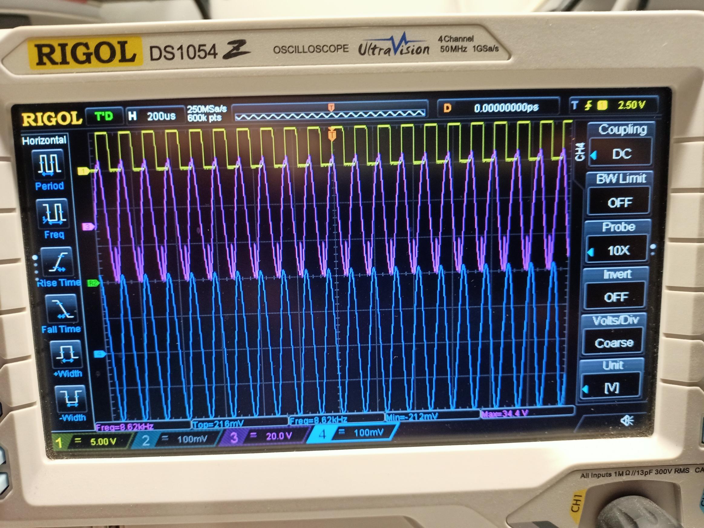

                        ... and VLF mode TX ...
                        Same coil but this time crank up the voltage to 5 volts to see what happens !
                        We end up with a sinus current waveform in the TX coil of 8.62 Khz ( other frequencies can be set .. )
                        The power supply is 5 volts @ 500 ma = 2.5 watts.
                        The TX coil current is 4 amps peak to peak @ 60 volts peak to peak ... very nice.
                        Yelllow trace is the gate drive.
                        Pink trace is the coil voltage.
                        Blue trace is the coil current sensor ( 0.1 ohm resistor ) 100mv / amp.
ID:	412796 Click image for larger version

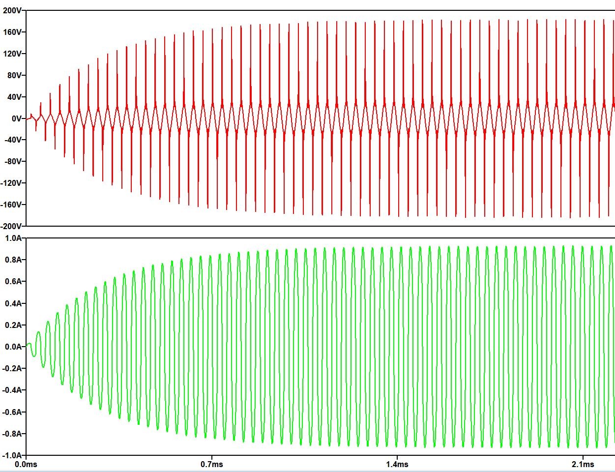

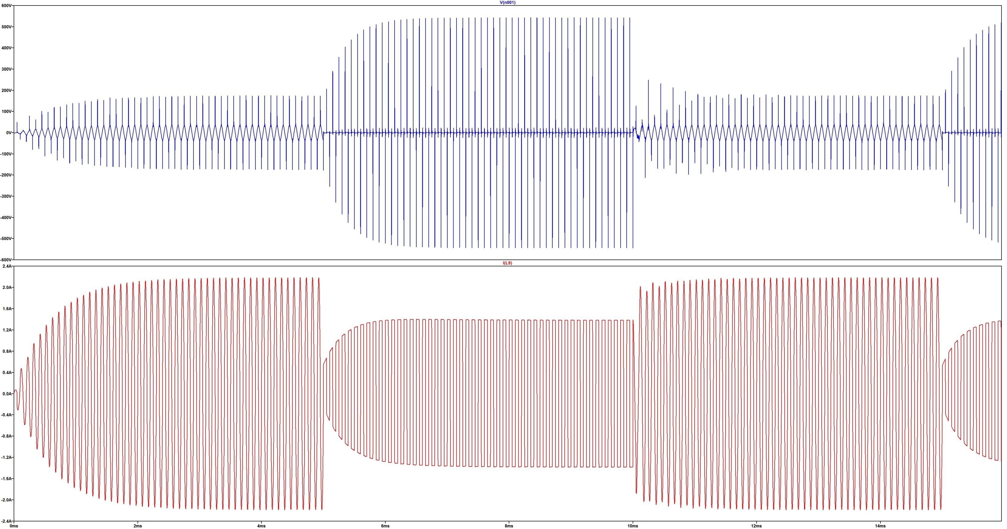

                          Is it possible to combine VLF+PI mode in alternating cycles. Because repetition rate is so high you could have 50% VLF 50% PI of the total time but is it possible to switch in and out the capacitor to achieve this?
                            It certainly is possible ... I was exploring it ... not sure if a mechanical relay is suitable as it would be buzzing and short lived ... an electronic switch is required should be relatively simple.
                            I have a sim that switches does 5 milliseconds of VFL then 5 milliseconds of PI ....
                            Its all synchronous so the RX should be able to track OK its just the first couple of milliseconds where the waveform is "winding up" in each burst ...
                            but I figure even this will be useful information.
                            The effective "sampling" rate is 100 Hertz ...( 50 bursts of PI and VLF per second ) should be fast enough for reasonable swing speeds ?

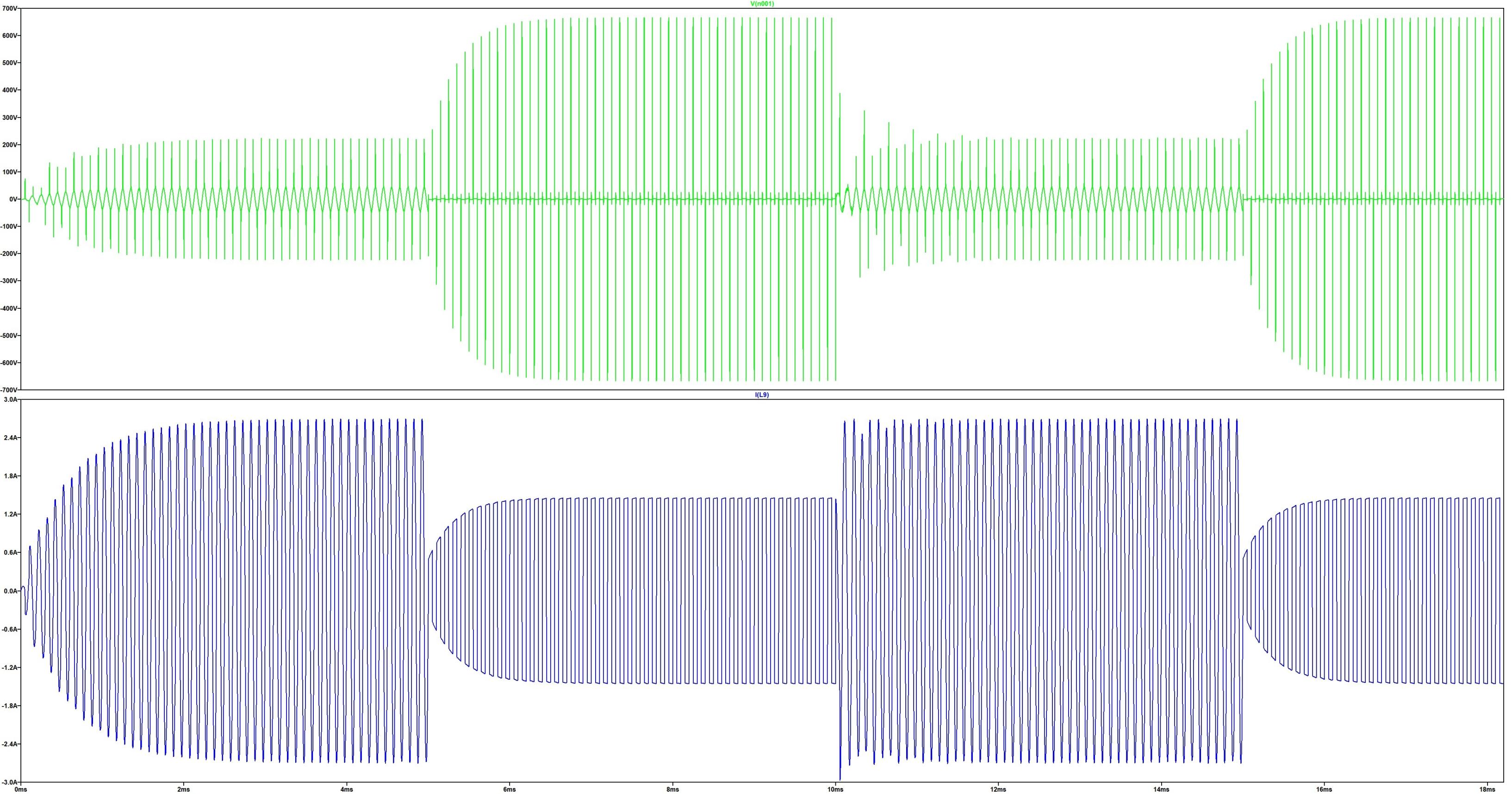

                              I have designed a solid state switch to alternate between VLF and PI TX modes and it worked first time ... better than I thought it would.
                              Tweaked the component values so we are at about the peak voltage limit of the SIC mosfets internally at 1.1 KV rated at 1.2 KV ( for a +500 to -500 swing at the TX coil in Pi mode ).
                              We get 2.77 amps peak to peak in PI mode and more than 4 amps peak to peak in VLF mode. The power supply to achieve this is set to 3.3 volts @ 1.5 amps = 4.95 watts ... I can wear 5 watts for this amount of TX goodness.
                              waveforms at the TX coil below
