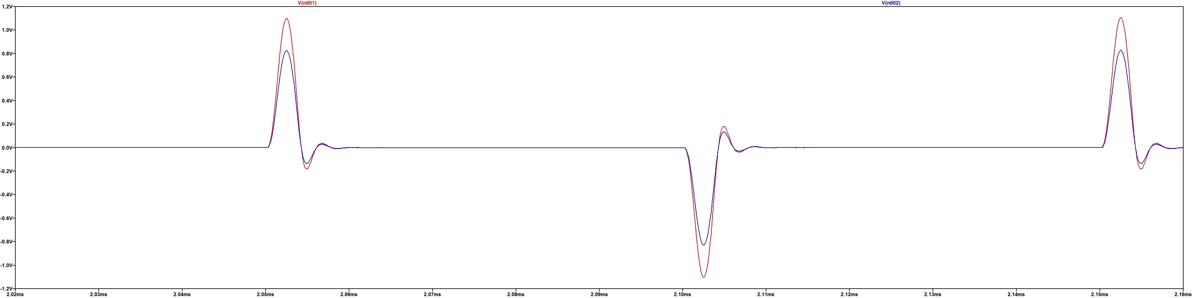

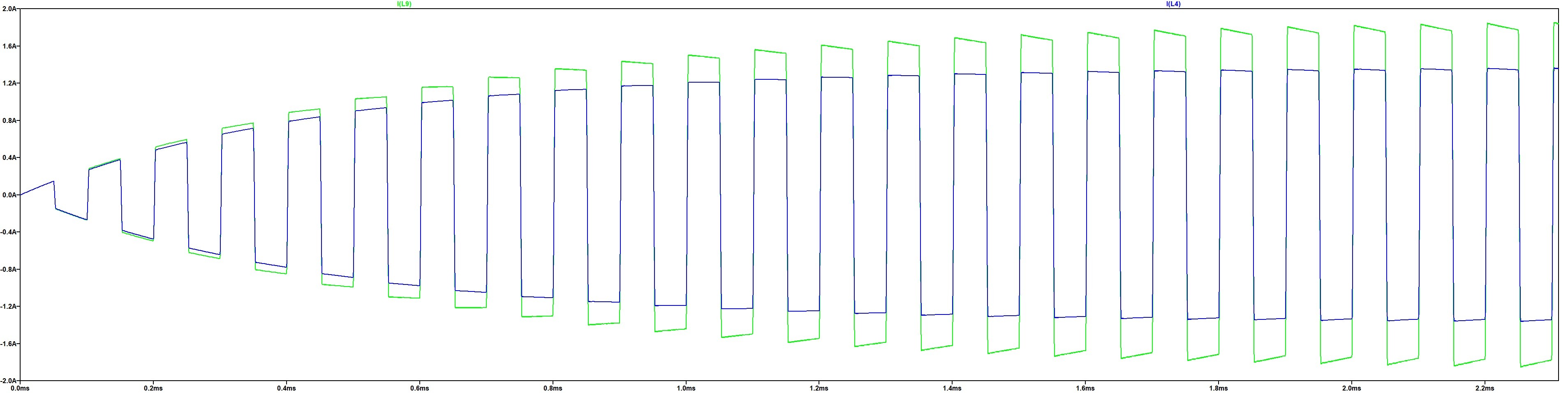

                ...This circuit is not a regular PI circuit ... its a resonant system that ping pongs the coil energy at each current transition. The energy builds up in the circuit like a flywheel.
                You can see this effect from the start up from power on. The Q of the resonant circuit on my test bed is about 100. ( there is no damping resistor )
                The presence of a reactive ground will affect this Q and thus the energy stored in the coil each cycle.
                This is where the current sensing comes in useful ... I am thinking I will use it to ground balance.
                Below is a pic of the current waveform in the TX coil ... with (blue) and without(green) reactive ground.
                The presence of ground causes a decrease in the peak coil current.
                The RX signal shown below also shows the expected result for ground during the coil transition.

                    Is the tilt polarity correct for the green trace post #22? Why less tilt for the blue trace?
                      I will try your method first though Altra .... noting also the other comments from G.
                      In theory it is possible what I proposed above. But after a second thought it may be a challenge. The very narrow sample window during the transition (<3us ) could be a limitation? A THS pi can have a typical half sine width of 30-200us to sample from, so lots of signal to work with. If anything, you may be able to do fe/non-fe determination? Worth exploring. Thanks for posting your projects
                        With the ground present the viscous matrix absorbs energy from the H field but does not return it during flyback. Any energy losses ( or returns ) will affect the tilt.
                        Thats my understanding anyway.

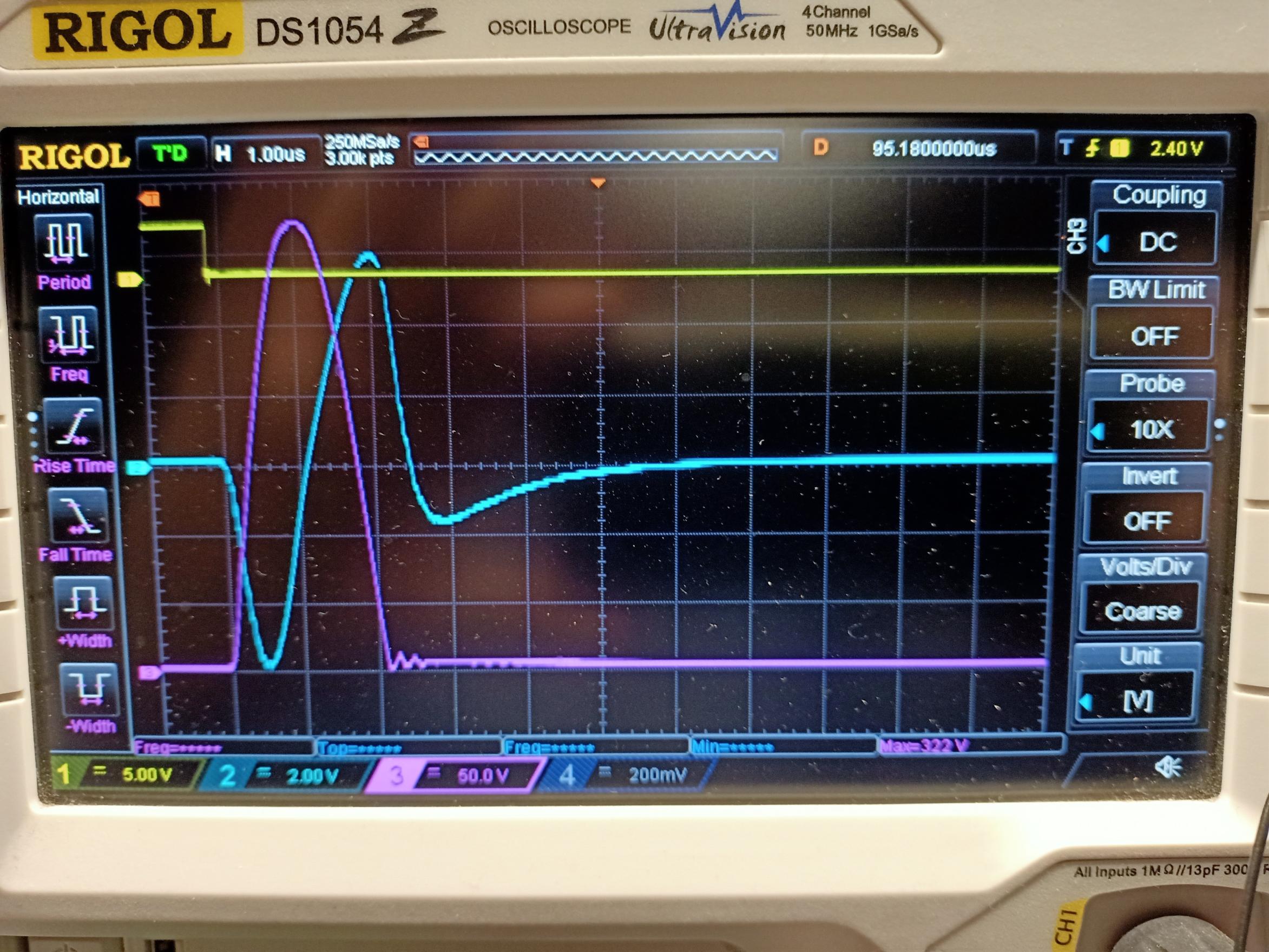

                          I have modified a MAGPI 3 board to act as a controller / RX for the BPCCPI TX and can sample down to 100 nanoseconds minimum width with 20 nanosecond timing resolution.
                          Have breadboarded the circuit ... The pic below shows the gate switch ( yellow ) the output of the first preamp .. gain = 10 ( blue ) and the flyback voltage ( pink ) at the coil.
                          The sampler is followed by a high gain diff integrator and 12 bit ADC into the micro.
                          Will see what happens.
