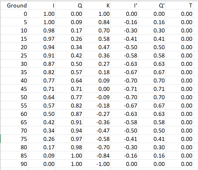

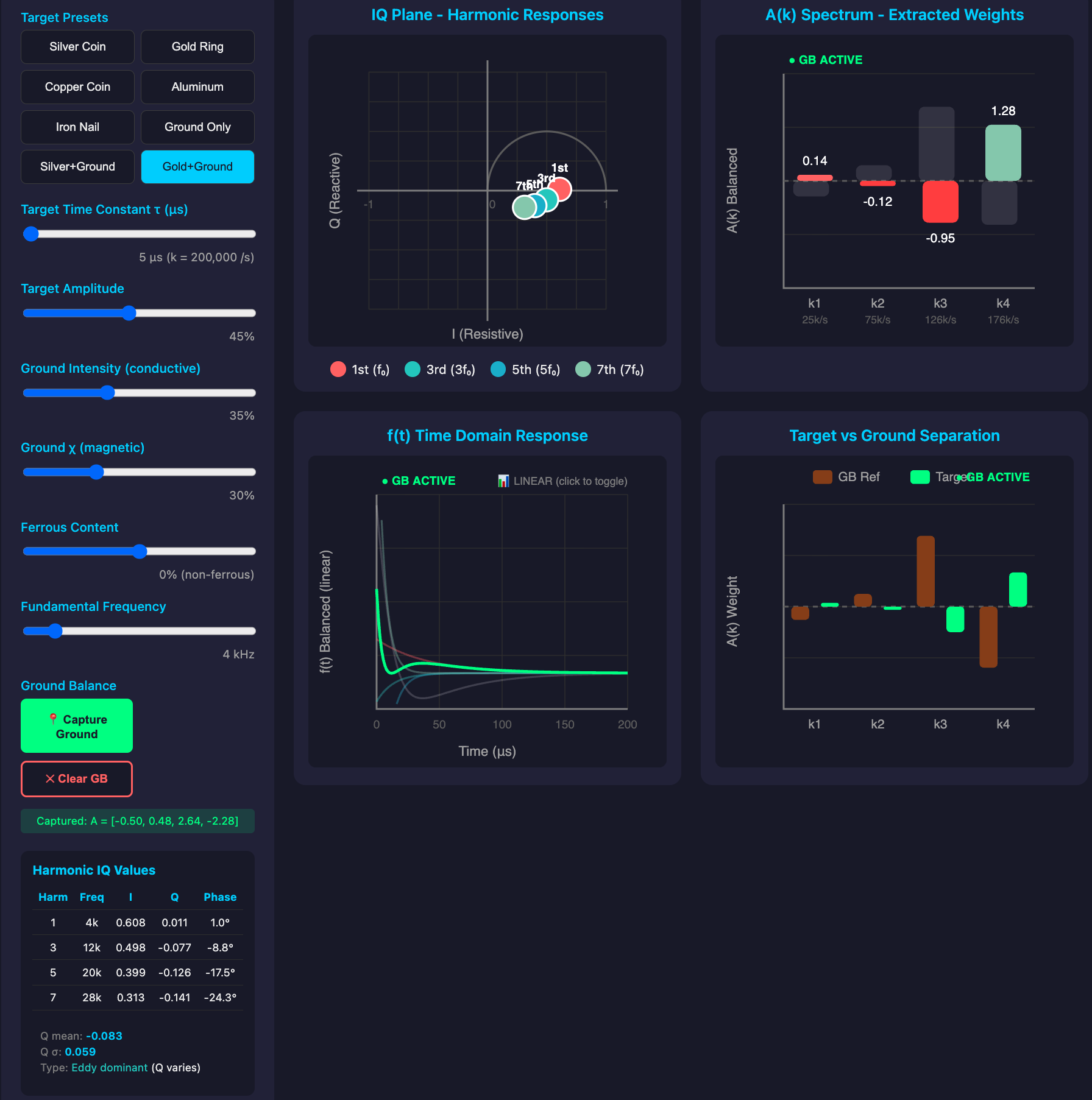

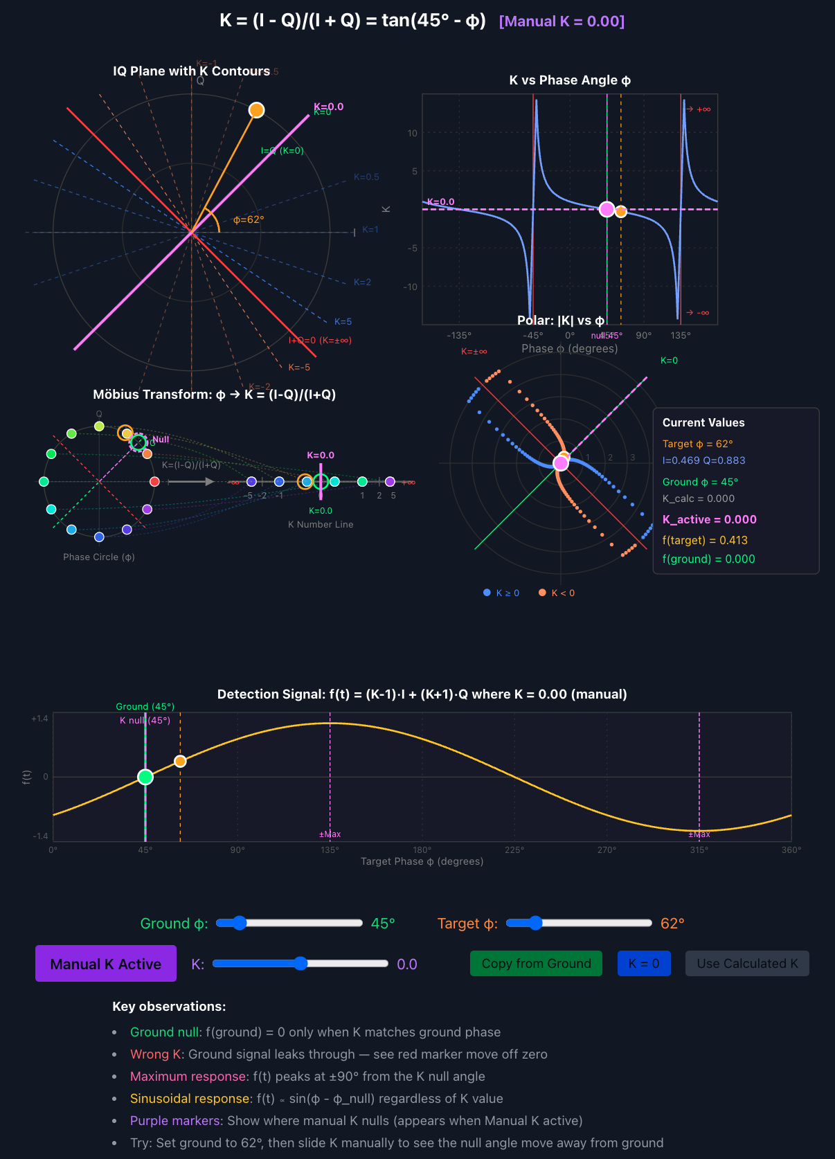

    ...well here is my whitepaper on ground cancellation and discrim for review.
    Screenshot from javascript framework that animates the method.

      Sorry to say, but you've re-invented the standard digital metal detector. I know that the DFX and V3 used something very similar, and I suspect other companies do as well. Beyond that, it has the same flaws as other methods. For example, "...while preserving full sensitivity to targets at different phase angles" isn't true. It has the same sensitivity roll-off as any other GB method. Here's why.
      Ground loss angle is normally 0°-20° but can extend all the way to 90° in salt water. So we can generate a table of K vs loss angle:
      Click image for larger version  Name:	image.png Views:	0 Size:	32.7 KB ID:	444943​
      K is then applied to the I&Q signals and summed to produce the targeting signal T (what you call f(t) in the paper). And, yes, regardless of loss angle and regardless of amplitude, the targeting signal is always zero. This is exactly what other metal detectors do.

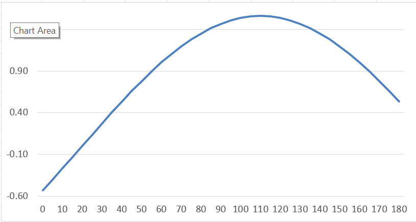

      But now let's apply a particular K to a range of target signals. Let's say the ground loss angle is 0° so that K=1. Targets can effectively span 0°-180° so we can now create a table of target signal strengths vs phase:
      Click image for larger version  Name:	image.png Views:	0 Size:	41.8 KB ID:	444944​

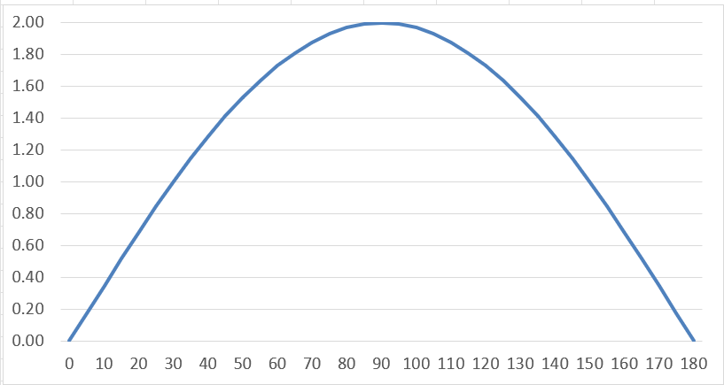

      It's more enlightening to plot T vs phase:
      Click image for larger version  Name:	image.png Views:	0 Size:	24.4 KB ID:	444945​
      What this shows is that targets at 0° produce a zero targeting signal (which is good, because that's our ground) and targets at 90° (small foil) produce a large targeting signal. But as you move toward 180° (Big Silver Coins) the targeting signal is again attenuated. If you were looking for Atocha bars you might be out of luck.

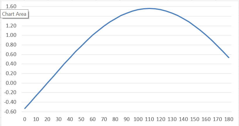

      Let's say the ground is 20°; the resulting target-vs-phase plot is:
      Click image for larger version  Name:	image.png Views:	0 Size:	24.5 KB ID:	444947​​

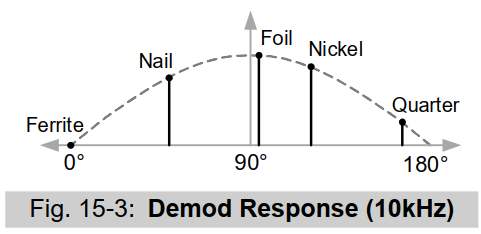

      Again, ground @ 20° produces a zero response but now targets at 110° (maybe a US nickel) produce a maximum targeting signal with diminishing results elsewhere.
      If you think this looks like part of a sine wave that's exactly what it is. This is covered in ITMD3:
      Click image for larger version  Name:	image.png Views:	0 Size:	25.0 KB ID:	444948

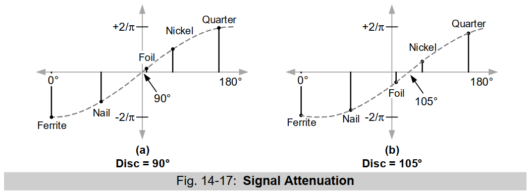

      And you get the exact same drawback when you use this method for discrimination:
      Click image for larger version  Name:	image.png Views:	0 Size:	52.3 KB ID:	444949​
      If, for example, you set the disc to minimize foil (say, 95°) you will also attenuate other low conductors (gold, cupro-nickel coins) while Big Silver Coins are largely unaffected. This is how discrimination was done in the 70s and 80s. And if you then multiply this result with the GB result
      f(t) = f1(t) x f2(t)
      you end up with a double hump where there is a null at ground (say, 0°), a null at 95°, and a null at 180°, with everything in between attenuated. This follows Carl's No Free Lunch axiom, and is why no one does discrimination this way any more. They all do it digitally by looking at the target's phase and either passing it or blocking it, producing a brick wall filter that has no effect on undiscriminated targets. Also, your K goes to infinity at 135°, which is about where aluminum screw caps end up (assuming 10kHz).

      ​One of the things ITMD3 didn't cover very well is digital detector design. Partly because I'm still working for a detector company and even though the techniques we use are probably universal, the boss would still look at it as proprietary information. Also, the book was getting really big and I was getting really tired. In the future, I'm think about splitting it into 2 volumes where the second volume covers digital design and more cutting edge stuff.

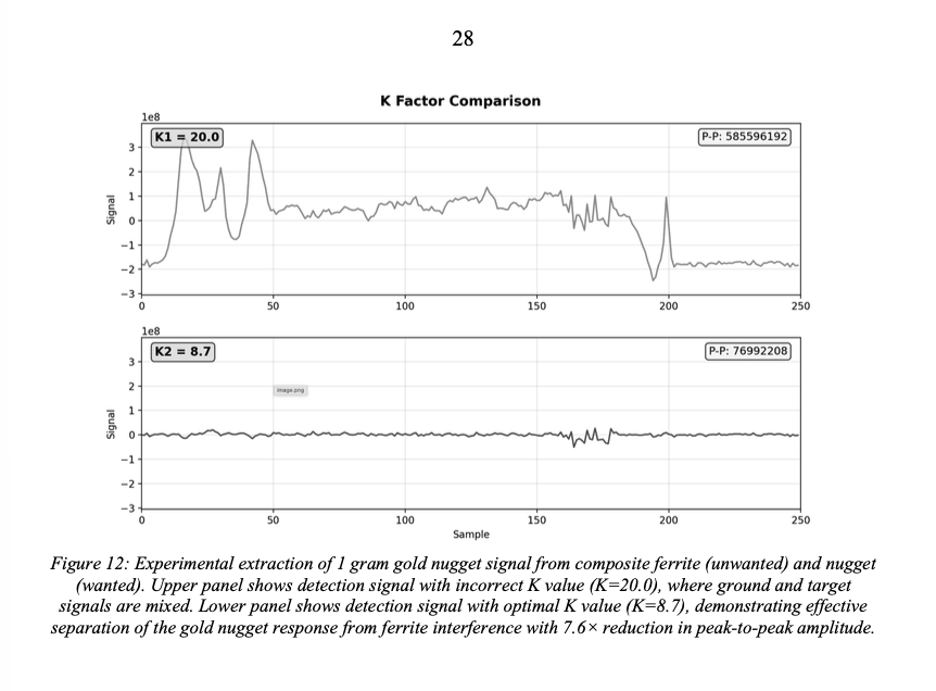

        Hi Carl as usual the proof is in the pudding ... I built the detector before I nailed down the maths. Below is an image from the patent but based on real data. It is the detection of a 1 gram gold nugget in a ferrite matrix. The data is taken from the detector buffer and shows the effect of application of correct K. aka instantaneous ground balance. This was a very difficult target for a PI to find ... and VLFs just said no target. The 7.6 reduction in peak to peak signal without ground reduction equates to a target gain. This target could not be heard at all with the ground excursion .. the big spikes are fast coil sweeps so everything is moving.
        I would be really interested if you can reference a detector that uses a Cayley transform method to reduce unwanted signals vs wanted signals ( the implementation of a Cayley transform method "is" the patent ).

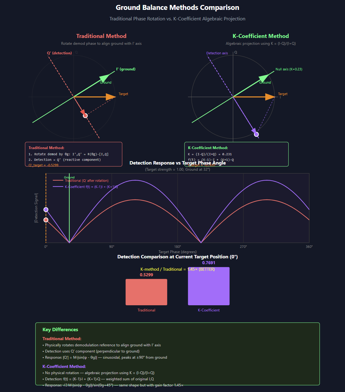

        ​You're right about the sinusoidal rolloff - the paper actually derives that explicitly: f(t) = √2·M·sin(φ − θg) / sin(θg + 45°). But here's the thing - yes, target response follows a sine curve, but if ground noise is removed then target signal-to-noise improves regardless. A target at 170° might only produce 20% of the response it would at 90°, but if I've also knocked 95% off the ground noise, I'm still way ahead on detectability. The sensitivity gain comes from the noise floor drop, not from boosting the target amplitude.
        ...and also remember ( and this is critcal ) ... that data in the buffer .. the K can be adjusted also to cancel the gold nugget leaving only the unwanted signal. So we can have a buffer with both signals and additional buffers with ground only or target only etc etc ...
        One thing though - your K table only goes from 1 to -1. K actually spans the entire real line. The formula is K = tan(45° - φ), so it maps all phases with asymptotes at 135° and -45°. The specific K values you get depend on where your hardware puts the I/Q axes relative to the signals - we don't calibrate the phase, so the absolute numbers are arbitrary to the setup. The point is K isn't bounded to [-1, 1].
        Another thing I want to push back on: we don't track RX phase at all. That's kind of the whole point ( ... and i had mentioned in other threads that phase tracking in VLF detectors might not be required ). I sample I and Q, compute K = (I-Q)/(I+Q), store K. During detection it's just f(t) = (K-1)·I + (K+1)·Q. No arctan anywhere, no phase unwrapping, no quadrant handling. K is the phase, just in a different coordinate system (that's the Möbius/Cayley transform bit). So when you say "keeping track of the RX phase so there is always an inherent latency" - that just doesn't apply here. There's no tracking at all - you press a button, K is computed or applied, done.
        Nor are there any lookup tables or scaling .. its all done by looking at the last n seconds in the sample buffer. ( in a way the operator hears the immediate signal based on the last n seconds that "teaches" the detector what to expect in the future)
        Re: DFX/V3 - I'd genuinely like to see how they did it. The patents I found (Teknetics '84, White's '88, Minelab '96 and '06) all describe weighted I/Q combinations but with iterative or feedback-controlled coefficients, not a direct closed-form computation. If you know where the DFX algorithm is documented I'd appreciate the pointer - happy to cite it if it's the same approach.
        The transform as described is not dependant on frequency ... so multiple frequencies can be processed up to the computation limits of your hardware.
        Another claim in the patent covers the implementation hardware .. my test platform uses a $5 chip and $5 dollars worth of parts to get PI like performance with pushbutton ground balance.
        Bottom line is I tried the magnitude / arctan path of "traditional" VLF detector architecture ... and I dont get the performance we see in fig 12 above"
          Agreed, but that's what ground balance has been doing since 1974, whether analog or digital.
          True as well, but as I said, this only further degrades the SNR. These phase notches are really broad and drag down all other targets. It's how discrimination was done until the White's Eagle came along, now no one does it this way.
          I normalized the signal to an amplitude of 1. You can plug in any amplitude you want, but the relative results are the same.
          Yes, I understand that, and I'm using "phase" very loosely to mean K which, as you say, is a representation of phase. If you are doing AGT then you need to keep a short history of K and a boundary system for inhibit. If you are doing a push-button Ground Grab then you still want to keep a short history of K to do an average on the data so that you get a more representative ground K. That's what FTP Ground Grab detectors do and, yes, they are instantaneous. But in a true auto ground tracking detector you can't be instantaneous without the risk of tracking to targets.

                  Because the DSP chain is just pumping out IQ samples and there is no phase rotation going on .. its significantly more stable. ( yeh I know you can rotate it mathematically but this has its own issues ).
                  Below is a screen shot of math sim comparing phase rotation method to K method. In both cases the ground has been rotated to I axis.
                  There are some other aspects that fall out as a consequence ... eg multifrequency and harmonic channels .. there are nearly 50 claims in the patent.

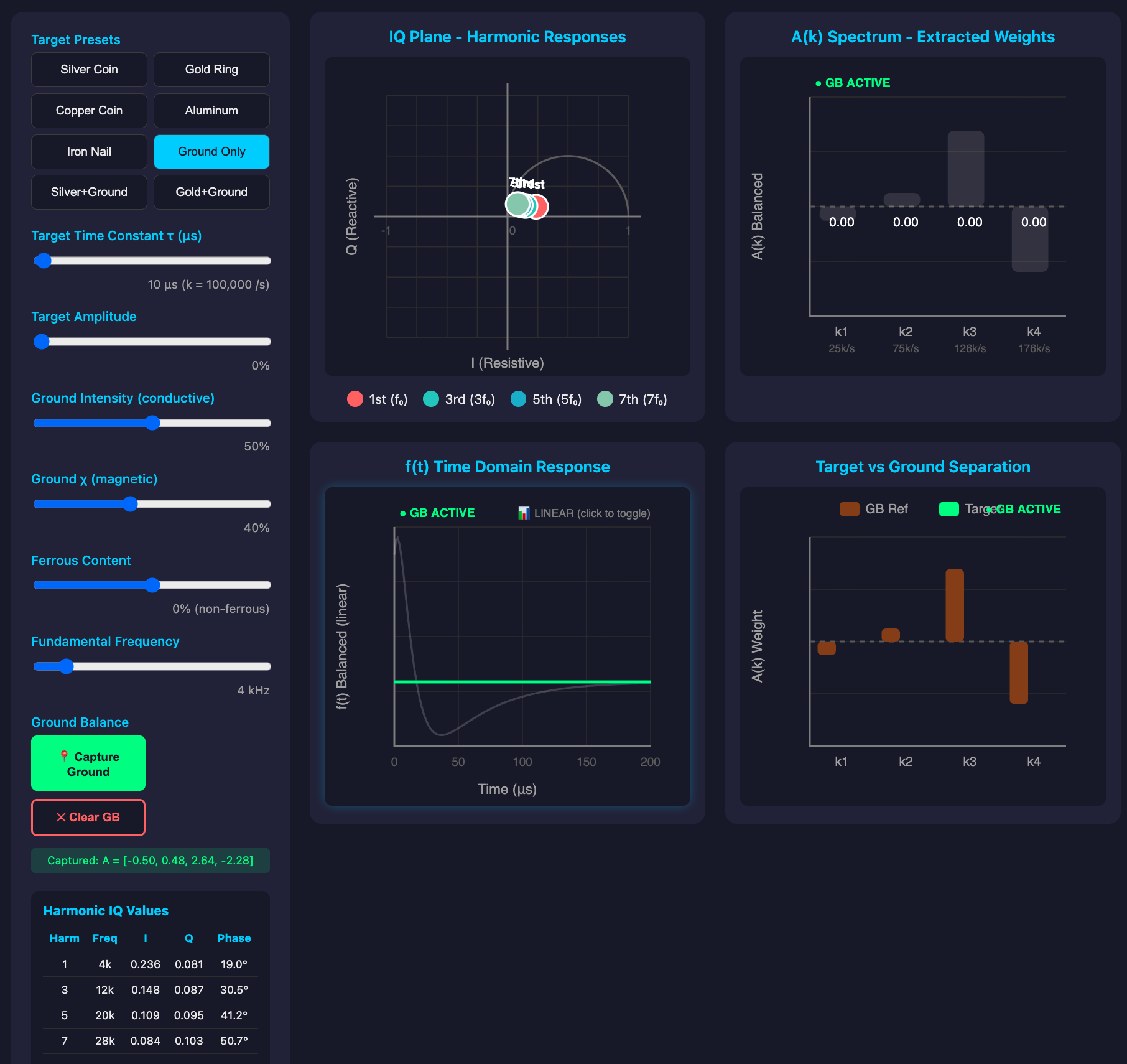

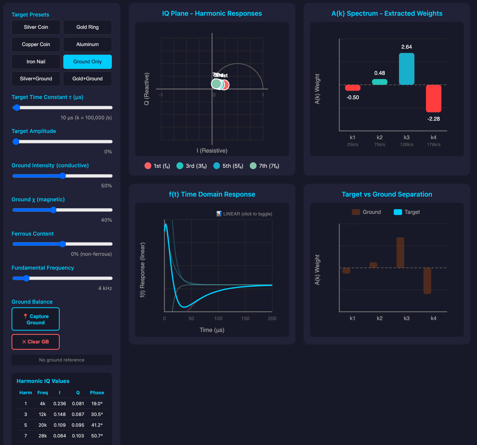

                          Here is the missing link ( maths ) between VLF and PI.
                          This demonstrates the power of the K transform.
                          In this case we go from IQ samples ( VLF ) of a bipolar waveform and derive the decay curve of a PI f(t) and the target taus.
                          We do this by processing the fundamental and upto the seventh harmonic.
                          Because we have perfect knowledge of how the decay curve was derived from the underlying IQ components we can absolutely cancel ground components.
                          PS I patented this :examine
                          Here is the ground response :
                          ...and now we ground balance.
                          ​.. and now with target. 5us gold target.
