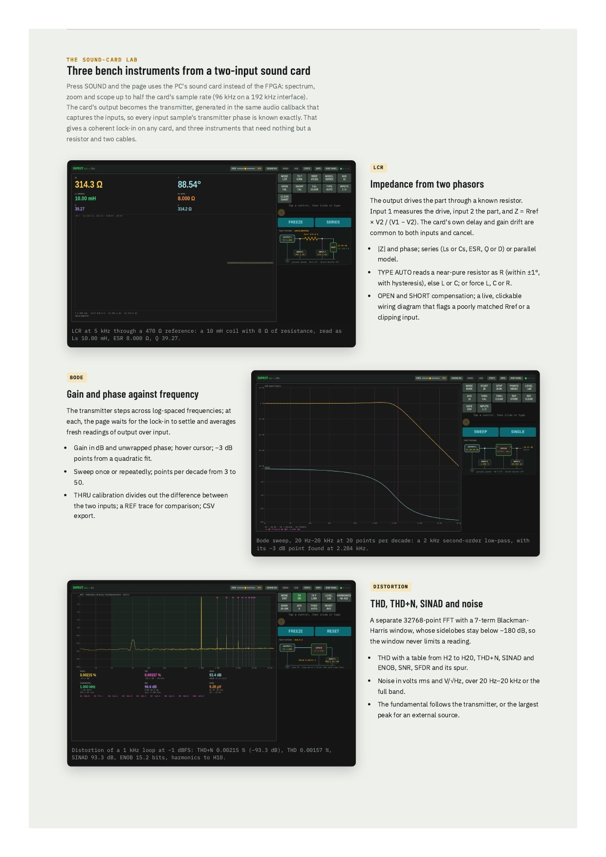

DSPECT ... A development tool for metal detectors ( and other stuff )
    I went coding wild .... added the LCR , BODE and NAD modes ( noise and distortion) .... Only for sound card though.
    Version 2.2 is attached below for your enjoyment ( or not ).
    Click image for larger version  Name:	DSPECT_brochure_page3.jpg Views:	0 Size:	263.9 KB ID:	454045​
      Hi Paul,
      nice App.
      For real-time metal detecting approx. 100 times / s measurement is ok. Even 50 times/s is ok (slow motion version).
      Instead of Lock-in amp demodulation, Goertzel will do it slightly faster.
      With an ultra-low-noise amplifier, the USB sound card version will do a good job.
      Aziz
      Claude agrees with you but this is what he said :
      For the sound card, keep the lock-in as it is. Goertzel would give the same answer, and the current version is the better-behaved of the two.
      What we have is already a DFT bin at the TX frequency, the same quantity Goertzel computes, but with two advantages:
      Hann weighting. Off-frequency signals leak far less. You saw it in the test: with plain averaging the extra 1 kHz and 5 kHz tones made the reading wander by about ±0.7°. With Hann it was steady to 0.0001°. A plain Goertzel is a rectangular window, so it behaves like the first version.
      Any frequency, any block length. Since the exact-frequency TX change, the TX is a fractional phase accumulator, so a block rarely holds a whole number of cycles. A rectangular Goertzel needs whole cycles to stay clean; Hann doesn’t care.
      Goertzel’s one advantage is speed, about 1 multiply per sample instead of about 4. That doesn’t matter here: at 192 kHz on two inputs the lock-in costs a few million operations per second, which JavaScript handles without noticing.
      The numerics also favour the direct form. Each sample is multiplied by an exact cos/sin of its known TX phase, so there’s no recursion to accumulate rounding error over long, low-frequency blocks. In JavaScript’s double precision that isn’t a real risk either way.
      Goertzel only makes sense where every multiply counts: in the FPGA, on the ESP32, or for a bank of many frequencies at once. For one TX frequency in the browser, the current lock-in is the right choice.​

        Yep, Gemini AI says the same.
        Lock-in amp with Hann windowing is the way to go.
          This is the Gemini AI Goertzel vs. Lock-in comparison (see PDF).
          Even the Goertzel with Hann windowing, numerical instability on large sample block sizes remains.
          I have a block size of 1920 samples. I will face with the numerical instability.
