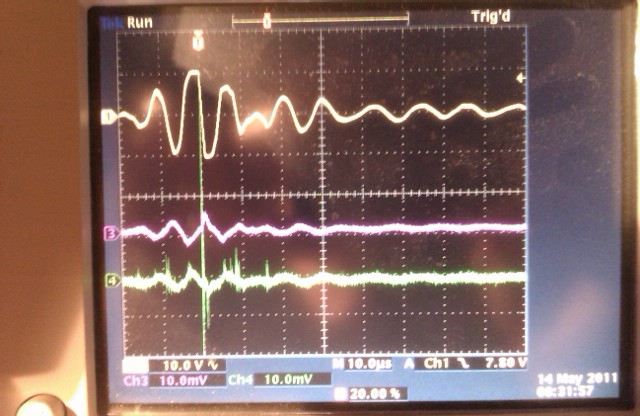

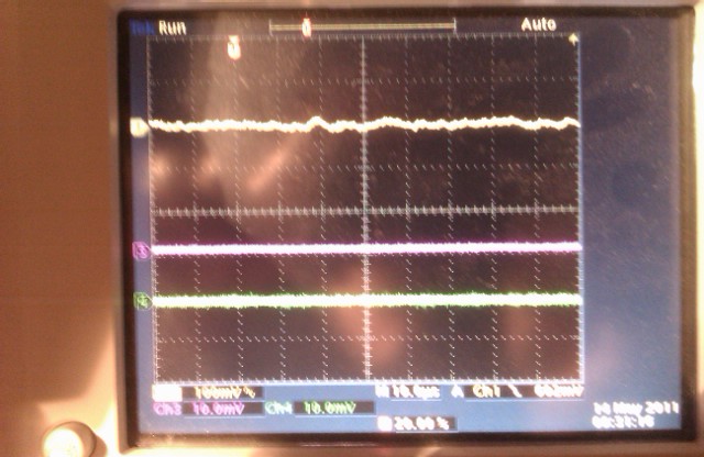

                  Thanks for the help with this here Moodz. I've used three OP37's in the classic instrumentation amplifier configuration and have verified that the performance is as expected.
                  However, in the scope shots below you will see there is full 10mv pk-pk differential noise that is a few cycles of around 100KHz directly measured at the coil (traces 3 and 4). This is amplified with a gain of 2000 giving a swing of +-10V on trace 1. The Mosfet driving the coil is disabled so I can just look at what the coil sees around it. In the other scope photo I've simply shorted the ends of the coil (down on the search head) and the noise goes. The gain is still 2000 and I've increased trace 1 to 100mv/div just to show how quiet everything but the coil is.
                  To me this eliminates everything from the full length of connecting lead all the way up through the diff. amp - leaving just the pickup in the coil. This has a very uniform winding and a natural balance in both halves as you'd expect from the twisted bifilar construction. The signal shown below happens to be dominant, but there's all sorts going on up to the bandlimit of the OPamps.

                    Hmmmm ... in the top CRO shot .... traces 3 and 4 are the two sides of the diff coil right ?
                    Trace 4 clearly has RF on it but Trace 3 does not ( or less at any rate ). If the coil is balanced any RF that appears would be on both traces ( but 180 degrees out of phase ).
                    disconnect the coil inputs from the amp and re-measure coil ouputs.

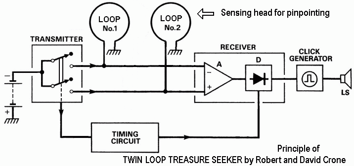

                      Let we reinvent the TWIN LOOP
                      Let we (R) the TWIN LOOP!
                      Symbol (R) is used by (R)EMI group to note a combination of verbs meaning: Rename, Revise, Reinvent, Rediscover, Redesign etc.
                      The (R)EMI group ceased its action about one year ago because participants of this forum have enough knowledge to (R) the EMI (electromagnetic induction) used for metal detecting.
                      IMNHO this is not valid for some participants of this thread, because they hate to rename and to read attentively what is written by authors of TWIN LOOP TREASURE SEEKER.
                      The project TWIN LOOP TREASURE SEEKER can be improved. This was made several years ago in Canada by G. L. Chemelec and by Sharky. Search this forum for details.
                      Can we improve something more?
                      To answer, we should read the article attentively, rename the principle and search WEB.
                      The name of this sensor is "planar gradiometer", but this name is valid for RX loops only. The term "Differential coils" relates also to RX loops only. Let we search WEB and let read the original article by Crone's published in ETI 1989!

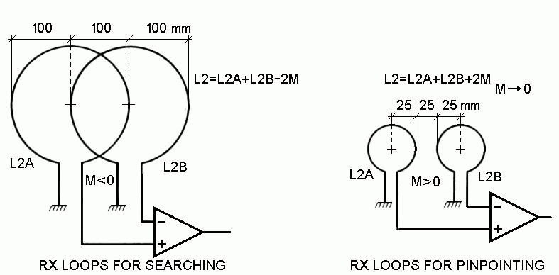

                      I made new drawing for principle of operation, because the drawing in article (see post #9) seems complicated for my primitive method of thinking.

                        (R)ead and (R)echeck your comments .... the twin loop was a D configuration ... the coil we are discussing here is a monocoil pair configuration.

                          Moodz, the TWIN LOOP is O configuration. It is also monocoil pair configuration.
                            Maybe you need glasses ... your own "evidence" diagrams you are calling monocoils are offset from each other .... read the dimensions on the diagram. over to you.

                              Moodz, I seriously not understand your terminology. The TWIN LOOP TREASURE SEEKER uses two monocoils because each coil operates as TX and RX. If we remove one of them, the device should keep to operate, but as a conventional monocoil PI metal detector. The second monocoil network is used to form planar gradiometer, having important advantages.
                              The dimensions in above diagrams are used only to illustrate change of mutual inductance M, which is important for calculation of total RX inductance L2 when we design L2A and L2B.
