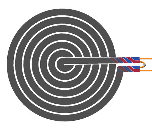

      Just thought I would add this for interested persons
      a bit of colour helps
      6666

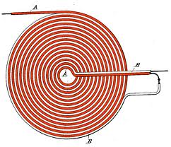

          Hi 6666, it will be interesting to see how fast your coil is, the best I could get with a standard tight bound coil was about 22us, then I went to a spider coil and have got about 10-12us.
          Mick
          • #50
            Mick
            hmmmm ...I can sample at 6us and the coil is just "scramble wound" twisted pair.
            In fact to get good descrimination you need to sample very early.
            moodz.
