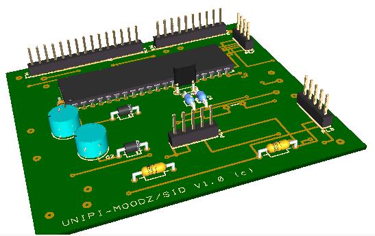

          • Hey all.
            As you all know i have had no experience in using any E.D.S software before, so have downloaded Designspark and have been having a go at learning the software to produce the UNIPI Main controller board.
            So far after loosing a few more hairs, hehehe, being frustrated, trying to work out what is what, measuring, placing, then removing and so on.........Below is the idea of what i was refering to PtB. Basically the rough idea of what it will look like after cleaning up tracks, removing all the vias (so to have a single sided board only) adding top layer links instead of vias where possible, adding a bottom layer groundplane where free copper is available etc etc....
            Knowing me, I will probably scrap this one...re-read the Tutorials and start a fresh new PCB board layout.
            I still have to learn on how to label connectors, components etc etc and add new components and footprints. So far so good apart from going bald.
            Thanks Tinkerer and mschmahl for recomending this program.
            BTW Moodz, with this program Designspark, you can import Eagle schematic's and pcb files.
            P.S It is my first attempt everyone, so please go easy on me. Some component footprints are not right so have to create my own.
            Sid

            • Hi Sido I can supply you with Designspark schematic and PCB files for our 4011 UNI-PI board that Stefan did to save you the time.
              Regards, Ian.
              • Originally posted by IBGold View Post
                Regards, Ian.
                Hi Ian, that will be very much appreciated.
                I will still continue to learn the program and may eventually be able to put some other experimental circuits in use.
                Cheers Sid

                    Great to see your very first board! Welcome to the club! Now the real heartache fun starts....
                    mschmahl also picked up a new bit of software and designed a PCB in another project; looks like people are really interested. It's really cool to see!
                    What happens now is that you get to enjoy the fun and happiness of PCB fabrication!
                    So what happens is that you check the board every which way from Sunday : you verify every single trace and every component, board size, hole count, everything. THen you get a quote from the fabrication place, and it's great. You're so confident that you order a solder mask option just so the board will look really spiffy. You send off the design. They send you back a reference number. Then :
                    1) You suddenly discover that the ****wad who made the MCU schematic library left out all the power and/or ground pins; and/or
                    2) You suddenly realise you've sent off the wrong version of the PCB, and the fab can't be stopped; and/or
                    3) You suddenly find out that the MCU manufacturer only makes a BGA version of your core component now.
                    Oh, the fun never stops.
                    Seriously, though, it's a great achievement to get anything out of an intimidating bit of software such as EDA. Kudos to both you and mschmahl...

                    • PI_DSPIC304011_A.zipSido/6666,
                      Here is the latest version thanks to Stefan. Open in Designspark.
                      Regards, Ian.

                        Hi Ian, thankyou for the files.......Managed to open them with D.S after some headaches.
                        All good now and will see what i am missing in the library with this schematic and add the new profiles for the components i did not have.
                        Once again much appreciated and hopefully i could work with this until i get the right format as i learn the program extensively.
                        Cheers For now and thanks.
                        Sid
