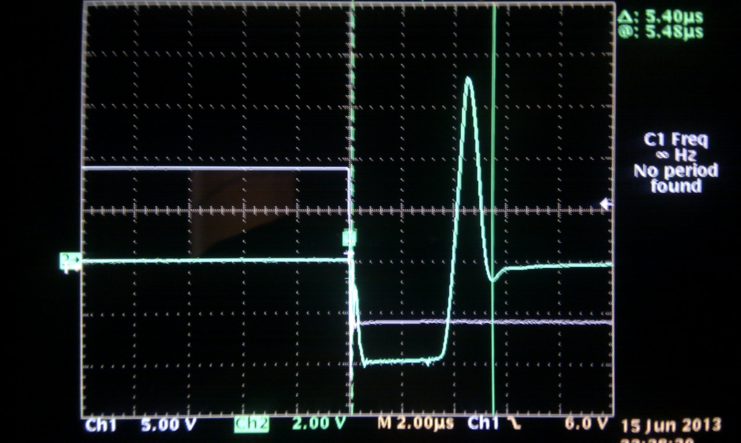

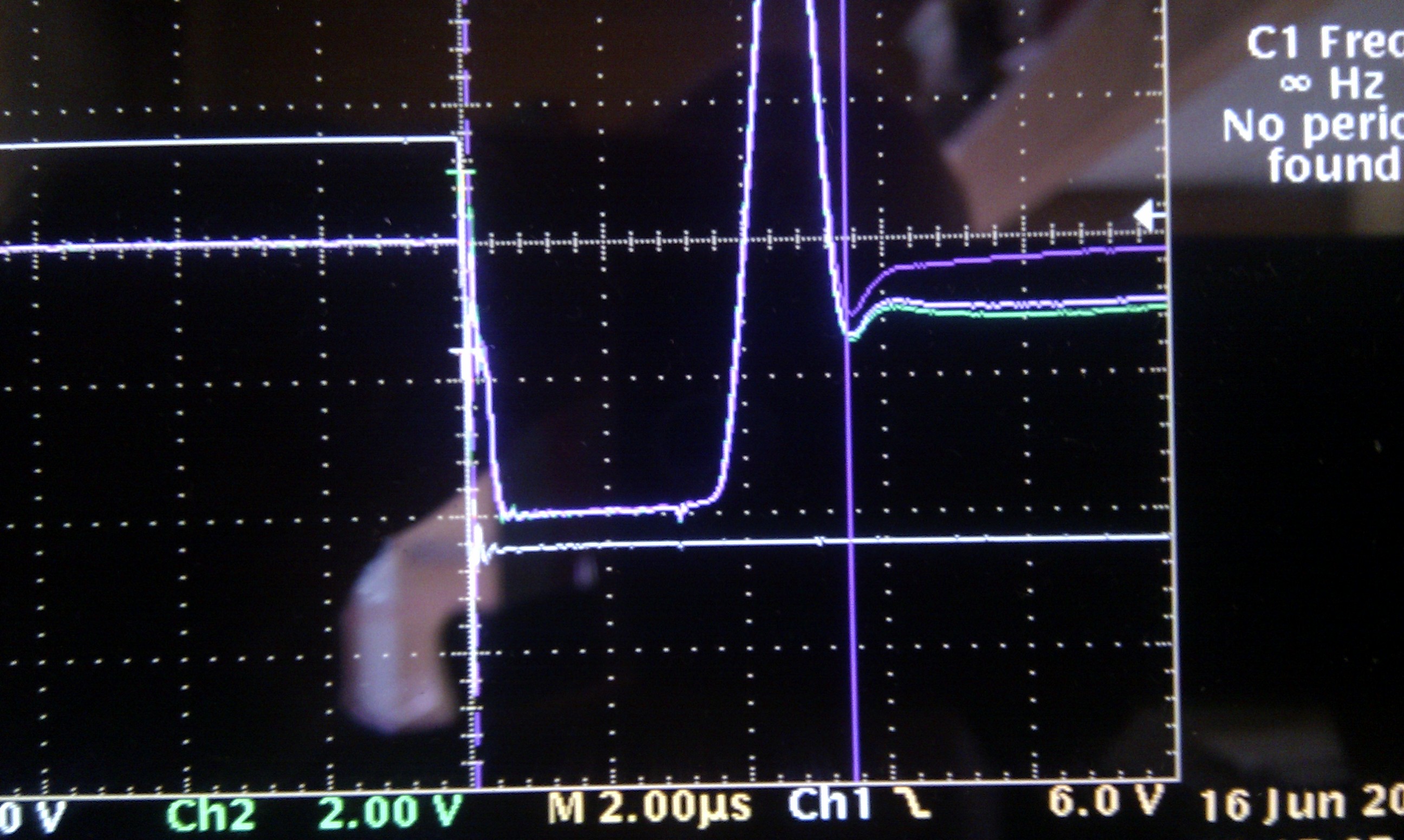

    • ..small update on the detector project ... we are having alot of success with detecting small targets.
      here is the frontend performance on a 1 gram test gold nugget ( its about 8 x 6 x 1.5 mm )
      The cursor is set to where the first sample in the detector could begin at 5.4 microseconds ( we can sample down to 4 microseconds if I change out the amp )
      The sample is placed one inch above the coil centre. Its a nuggetfinder 0.4 ohms etc etc.
      First Pic shows the output of the amp with some nasty overshoot ( I am using an ne5534 ) Our gain is set to 100 ( this is the first amp in the signal chain ).
      The second Pic zooms in to 100 mv per division on the CRO but the same timebase.
      75 Millivolt deflection ....not bad if I say so myself .... Cannot even see the deflection at the first amp on our reference commercial detector ( though it does easily detect the nugget at this range ).
      the signal to noise for these small targets is orders of magnitude higher than the same measure point on a commercial detector.

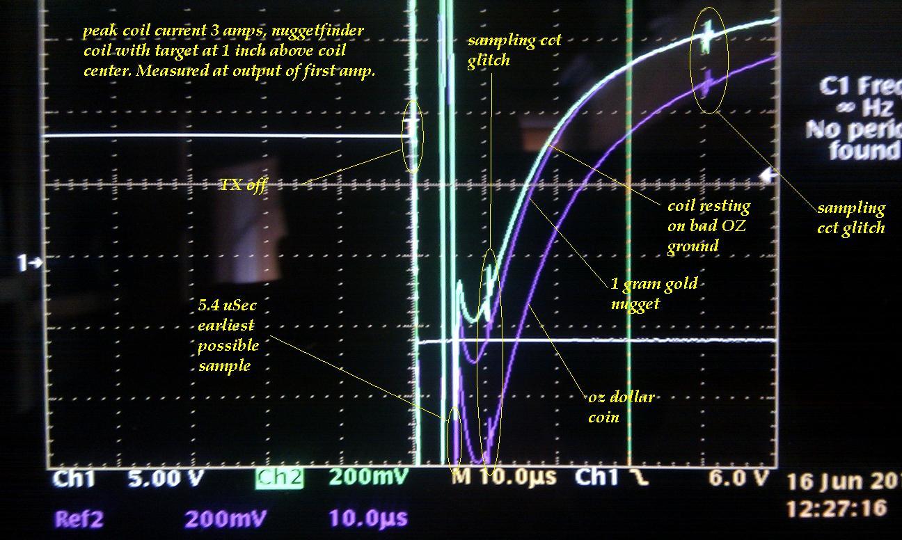

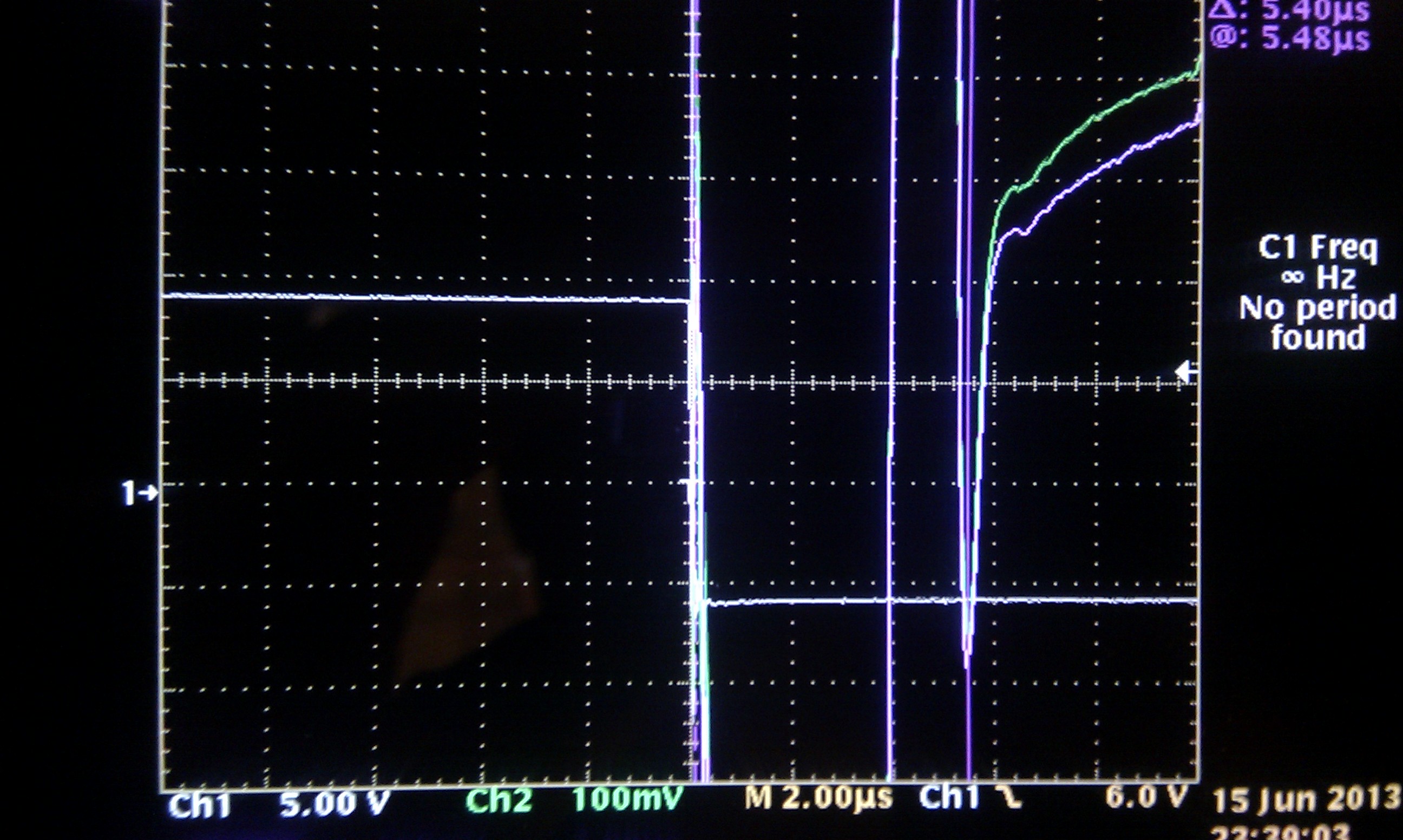

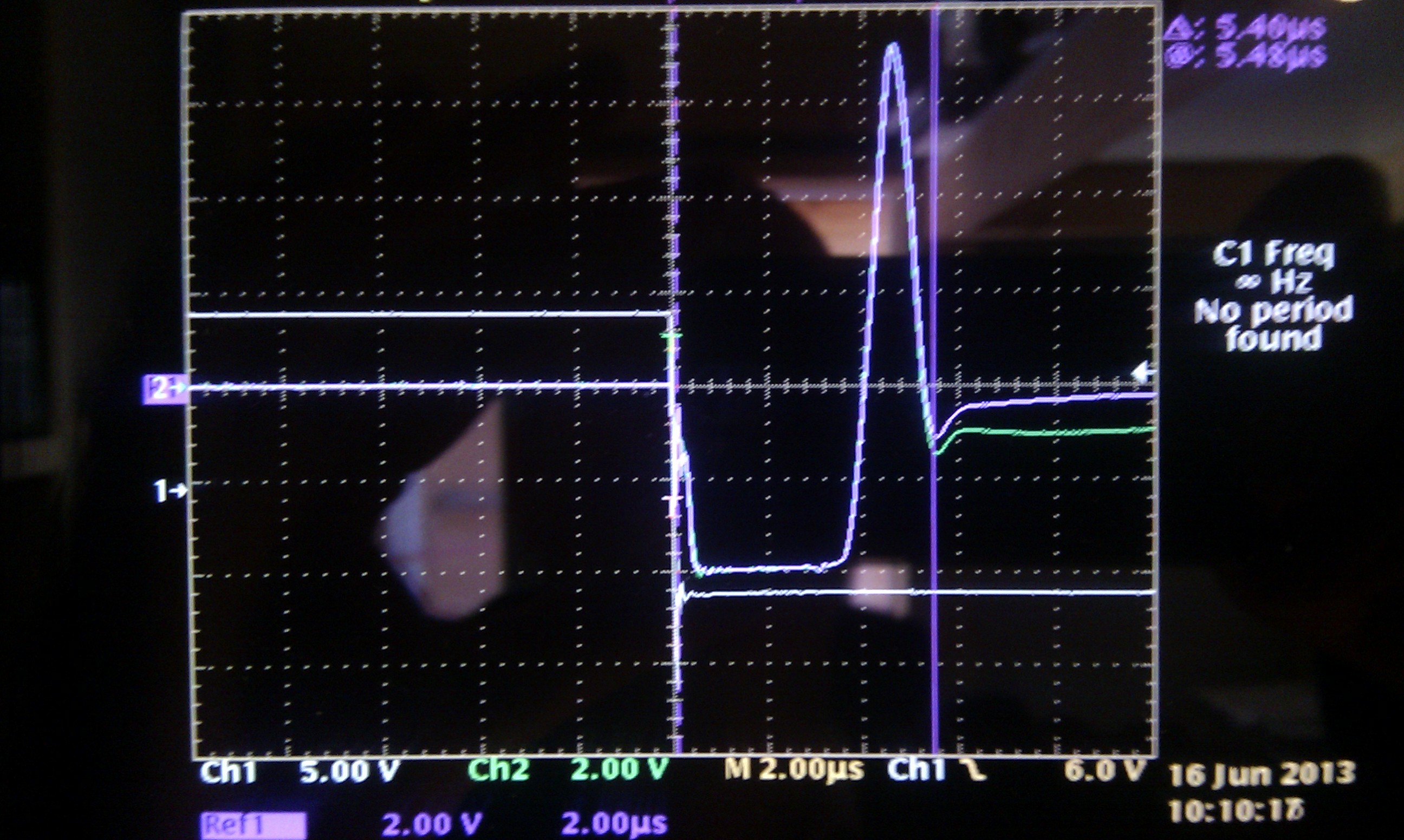

        • That's interesting that they are limited like that ... Though for control 9600 is plenty.
          I am fairly happy to get around 4 to 6 microseconds on these commercial coils ... Tho the Nuggetfinder coils are very good anyway and I am using relatively high tax current and long tx length at 200 ... I could do a lot better if I knock down the tx to say 60 microseconds. The production prototype detectors do better but I dont / can't post anything to do with them. I will publish a ground pic .

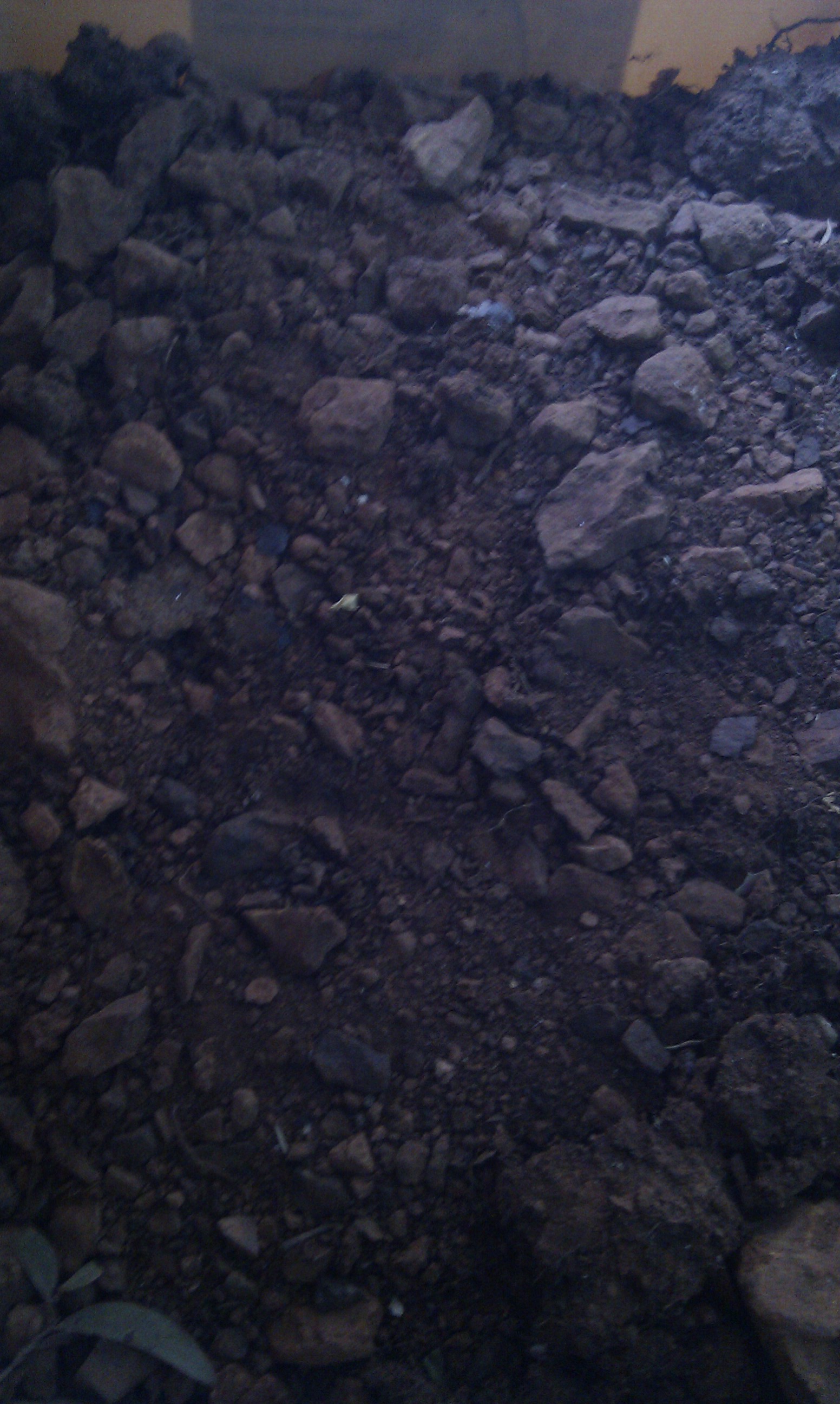

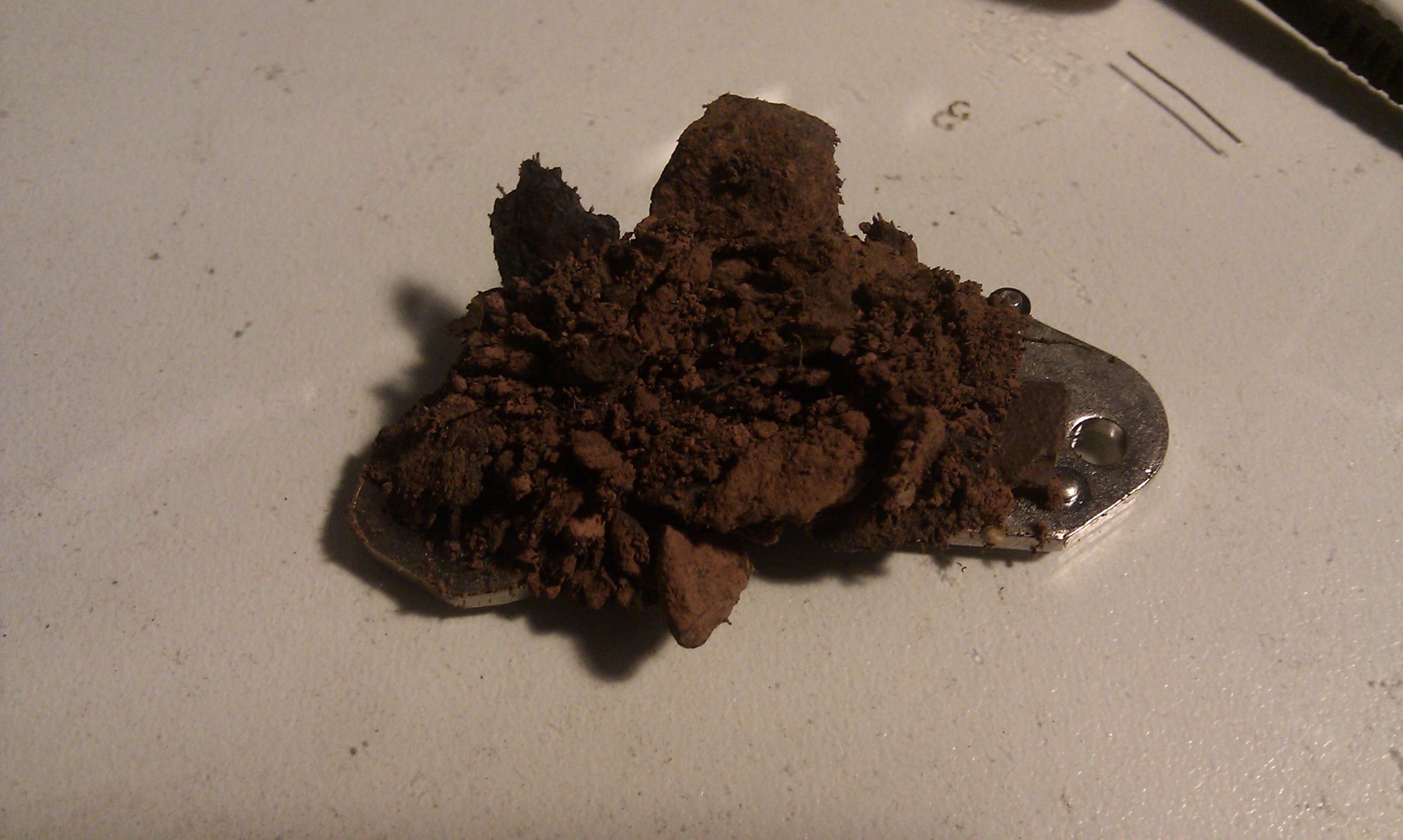

            heres the ground pic .... from some of the worst ground in OZ. ( see magnet pic ... you dont have to move the magnet through the dirt .... its all magnetic )
            The pix show the behaviour over really bad ground ... huge response from the ground ... the 1 gram nugget still provides a clear signal though
            the peak coil current is 3 amps.

            • .. tc infos for a couple of targets over bad OZ ground. Its interesting to compare the response of two smallish targets over bad OZ ground.

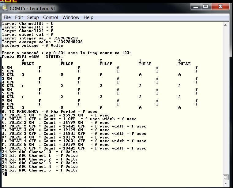

                      • got a new bluetooth adapter (Asus BT211), bluetooth between the uno and my computer works Great!
                        Also replaced my dual monitors, now their matching(great for programming and PCB layout), and a new video card to drive them
                        philip
