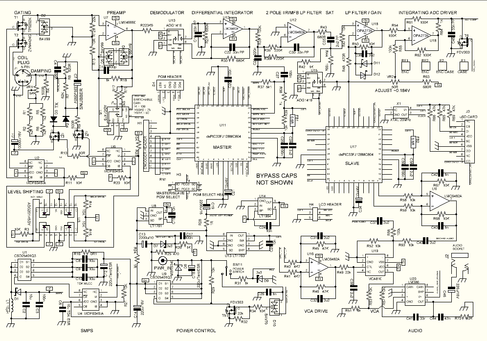

    I'm impressed that you've all struggled through all these hurdles to keep the design working. It's been really frustrating for me, reading this thread, as all the answers are there...
    You need to bypass the MCU exactly as per the Microchip specs (or better), otherwise you'll be introducing all sorts of switching problems. Use 0.1uF mono caps next to the VCC and GND pins, and add a 1uF tantalum (NOT electrolytic) cap next to one pair of power pins as well. That should stabilise the cpu a lot, and may fix some reliability issues.
    The miniature crystals aren't AT-cut, so the PIC crystal circuit will have most likely damaged them. You can use the low-profile versions of the "hip flask" crystal cases, with the same footprint, they'll be fine. But watch crystals aren't robust enough, even with the built-in soft start oscillator, to work at all reliably. But that's why the little crystals didn't work.
    Overclocking and raising the supply voltage will dramatically affect reliability and will compromise the ADC operations. You're better off lowering the supply voltage to 4.5V or so, that will make the chip overheat far less, and should improve the reliability somewhat. Remember, the DIP package was only designed to dissipate an absolute, utter maximum of 400mW or so - at 25C - so if the chip is hot, stick a DIP heatsink to help remove some of the heat.
    Overclocking won't improve the ADC sample rate one bit (no pun intended). In fact, it will severely compromise the S&H cap parameters, and will affect the stability of the ADC reference - even if you're using an off-chip reference. The ADC can sample at 1nS resolution, so could someone explain what the purpose of overclocking is trying to achieve?
    Finally, has anyone considered using a bootloader? This would dramatically help anyone who wants to use one of these chips without needing to have a programmer. I could happily burn in a bootloader for anyone, then you can use a simple serial port to upload the new code. No ICSP required. Plus, the bootloader won't affect the functional code, and will work perfectly in the field. ANd you won't need to change anything in the existing codebase - just instead of flashing a whole chip each time, just connect up a serial port, upload the new code, hit reset, and it's up and running. Let me know if you'd think this might be helpful.
    I'm more than happy to help out in any way with this design - hopefully to improve it to the point where you won't need to overclock or overpower the circuit. Hopefully that might make your lives a little less hassled!

          FWIW, I don't have any problems doing PCBs for anyone for anything (but see below for caveats). I'm putting together a slightly "upmarket" version of BW's sampling monstrosity, purely as an educational tool for myself, (well, that, plus to ease me back into the Altium work cycle again!!). So 4x6, since the pinouts are going to be similar, if you'd like the 4011 version with a 4012 layout, I'd be happy to help out. Otherwise, I'd be delighted to dust off my brain and put it to work for a good cause. You are a good cause, right? :=)
          I guess I need to say, since I'm finding myself skipping all over the many, many design revisions in the many, many threads here, I may not be au faƮt with every name and every revision... so if you have a specific design you'd like realised. just let me know where the schematic is (forum/thread/post #, unless they're all in the same thread, naturally!), and I'll take it from there. Once I've done it once for each design, I'll be fine, it's just learning all the TLAs and project names and so on. Anything you can do to help me get up to speed with where stuff is, will be greatly appreciated. Oh, and footprints - like the rotary encoder, it's been used in many projects, so everyone calls it "the" encoder, but I haven't found the datasheet yet. So if there are parts like that which are specific to a design, just point me to the thread or part number, and I'll design and footprint it. And if you want it mounted offboard, let me know, and I'll just SIL it (or DIL, or whatever pin count is appropriate).
          At the same time, my intention is to collate the data (schematics, parts lists, and PCB layouts) and - with the authors' permission!! - put them all in one collection.

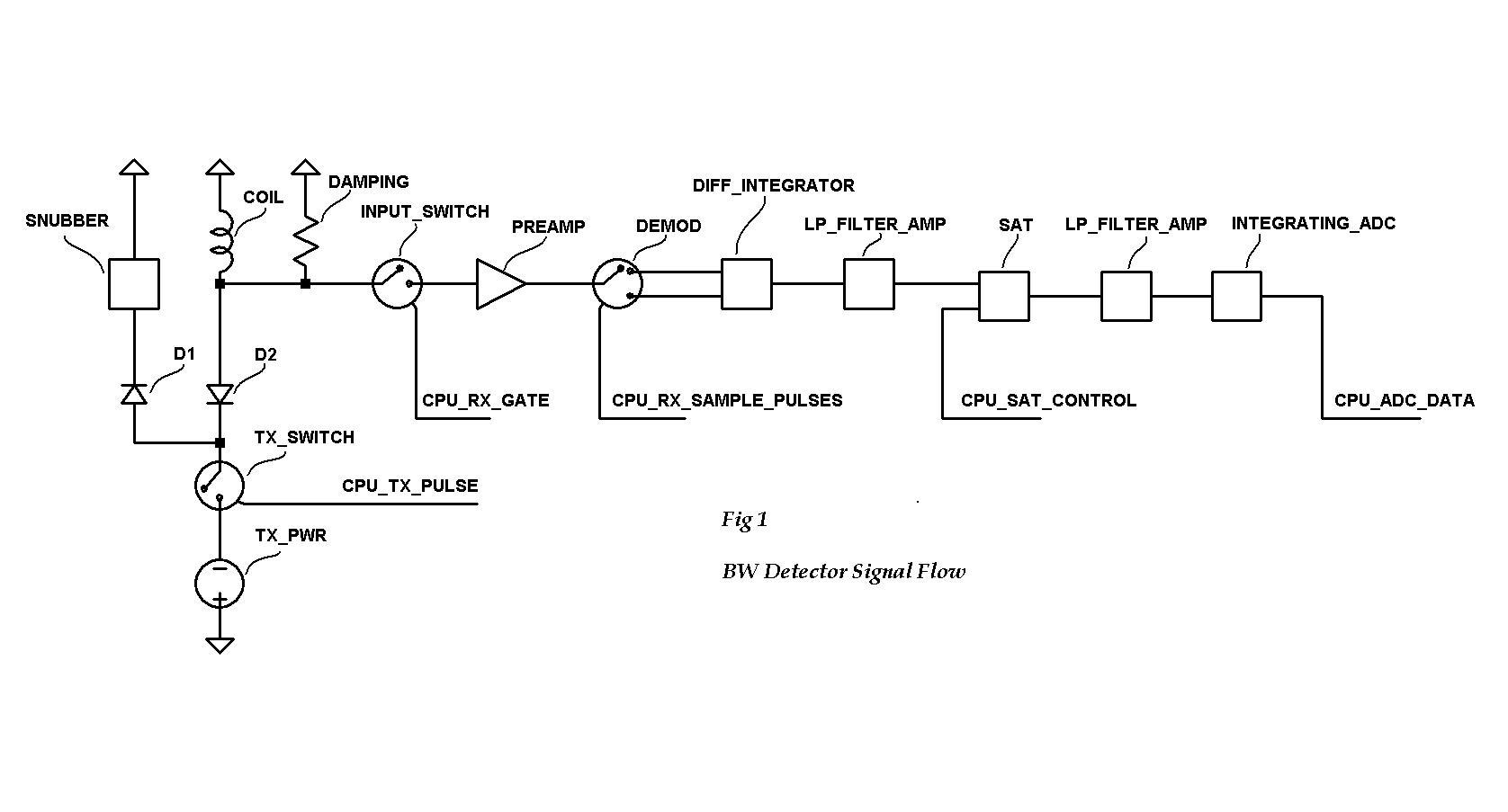

            There needs to be a top down approach ... whereas most of the discussion to date has been bottom up ( in more ways than one )
            for TOP down there needs to be a system model ....with modular blocks for each major function in the signal chain.
            Here is one I cobbled up for the BW detector from the published schematic ... I already posted it once but here it is again ....
            The timing sigs and soforth would come from the control ( eg UNiPi controller ) not shown.
            Its a good starting point .... ( oooooer ... looks like it came out of a patent diagram )
