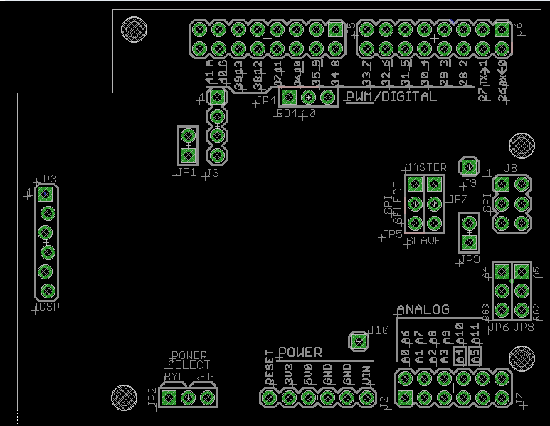

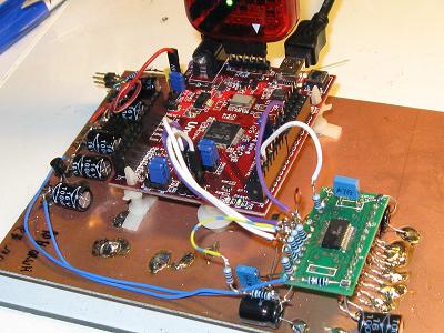

32 BIT PIController ... DSPi32
  • 32 BIT PIController ... DSPi32
    ...the PI DSP controller lives
    Testbench code operational.
    5 x individual pulse generators for TX or RX pulsing.
    5 x "analogue" control inputs ( ADC reads a pot )
    3 x rotary quadrature encoder
    8 x pushbuttons
    6 x 24 bit differential ADC inputs with programmable gain amplifier on all inputs.
    5 x analogue outputs for generating nice audio/sinus waves and damping control etc.
    1 x High speed RS232 over USB ( FTDI chip ) .... 300 to 230400 bps .
    2 x SPI port ( one is used by ADC )
    CPU board UNO32 ...value at $30
    ADC good value also at $3.50
    The CPU board and ADC are usually the most costly part of the PI electronics.
    Capture time for 6 channels is 5 microseconds.
    DSP filter code executes in 14 microseconds.
    Performance is at least twice the speed of the UNIPI chip.
    moodz.

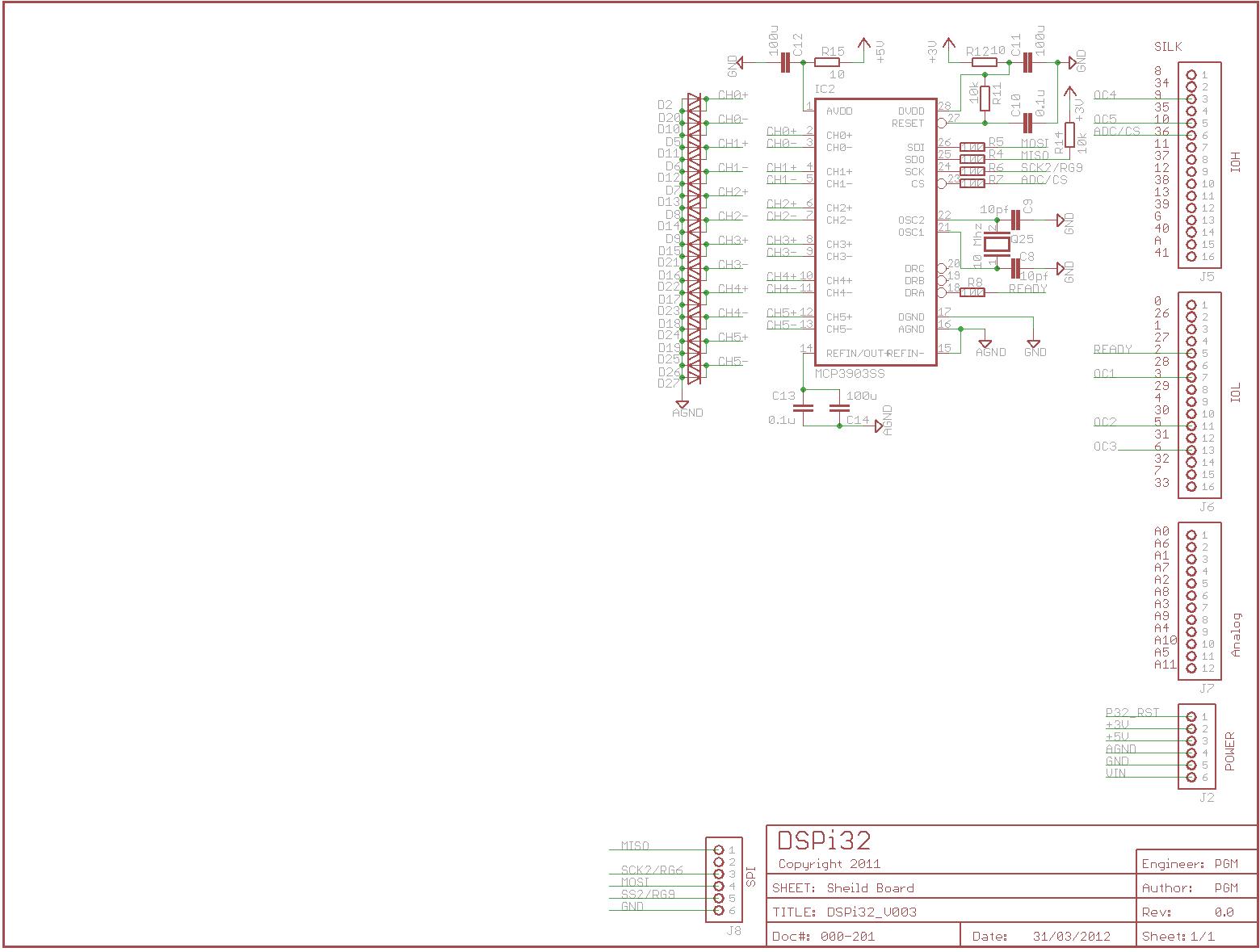

    hello moodz,
    nice progress on the uno 32, if you would like, i have a pickit3 and UNO32 ready to try your program here's my email, [email protected] i don't have the adc yet.
    I've been looking at adc's, in particular the MCP3903, what i can't seem to figure out is using the 10 MHz SPI interface, with 24 bit resolution, 10000000/24=416ksps /6 = 69.4ksps witch would equal 14.4 us. per channel ?.
    when you configure the adc what was the OSR setting you used?
    thanks for being patience,
    I'm just trying to make sense of it all
    Philip

        Only wired that up yesterday ...have not drawn the schematic. The code will not run unless there is an adc hanging off the spi2 port. The code is still changing a lot as I moved stuff around the ports ( lots of future goodies ) so I reckon it won't serve a purpose to send it except to indicate you adc is wired up ok.
        LOL .... Misled you with the adc sampling rate .... It takes 5 microseconds to transfer the 6 channels across the Spi bus ... The actual sample rate is 5 kHz or 200 microseconds. 10 MHz clock / prescale by 2 / OSR 256 + conversion time. This is not going to be a direct sampling device .....however this is way higher than we need ... Target detection is a demodulation process and the modulation source is way slower than this sample rate........here is a question...in the style of Aziz quiz show...Aziz is not allowed to answer.
        What is the source / generator of the modulation signal that we want and it's approximate bandwidth. ....free book prize for most correct answer ... I am the judge.
        Moods.

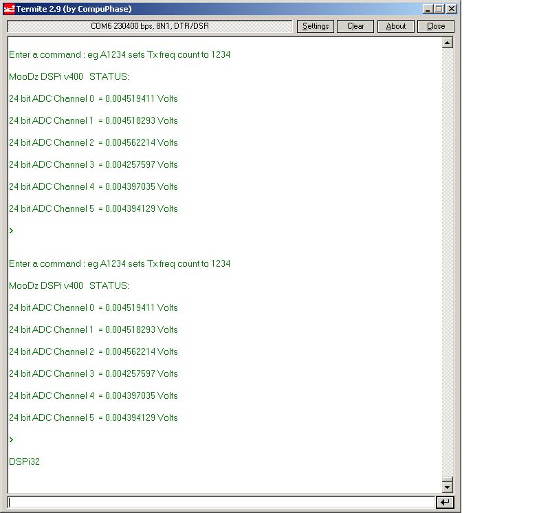

                UNIPI 32 project on the UNO32 with 24 bit ADC 3903 SOURCE CODE INCLUDED !!!
                Here is some code for you ..... the basic UNIPI code ported to the 32 bit UNIPI ... there are 5 output compares synced to each other for generating variable pulses.
                The serial port is through the mini USB port on the UNO32 ( mine runs at 230400 bits / sec ). I use termite from compuphase.com as a terminal .... freeware.

                HERE IS THE SOURCE CODE / PROJECT FILE => DSPi32.zip
                Warning ... this aint no metal detector ... it only illustrates how to get get the serial, SPI, interrupts, pulse generators and read a 24 bit ADC off a UNO32 board. There is a basic menu on the serial port.
                It works but there are probably bugs, typos etc ... so no warranty etc yada yada...
                have fun ....

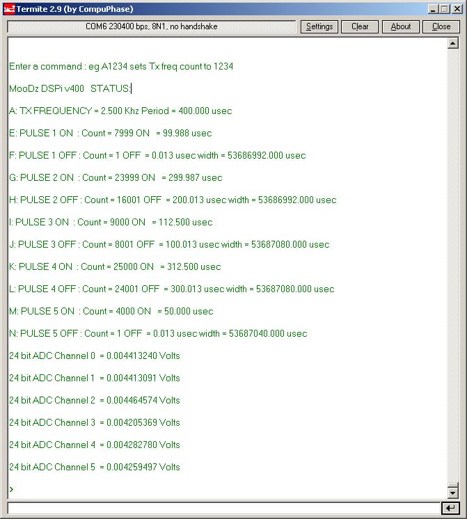

                      Based on the same code that runs on my nextgen PI machines this is the backend code for making your basic 32 bit PI controller.
                      Features ...
                      - 5 independant pulse generators for TX or RX sampling ... you choose depending on your design.
                      - serial port menu and status through UNO32 usb port.
                      - Audio generation pin ... just connect a speaker or headphones via 100 ohm resistor.
                      - ADC input for target voltages .... 0 to 3.3 volts .. this is a motion detector ... the voltage must change to produce a audio out .... No output for constant voltage.
                      Internally there is a SAT and 10th order low pass filter with brickwall cutoff at 20 hertz to keep those nasties out of your target sigs.
                      PORT F1 is audio out.
                      OC1 - 5 are the 5 pulse outputs for TX / RX
                      AN2 is the target input voltage ADC
                      here is the hex ....DSPi32.zip

                          b) I propose to develop the above as a shield using MAX32 template from http://code.google.com/p/svofski/sou...Fmax32template, will adapt it for UNO32 - shall it be double sided / single for reducing switching noise? - the shield shall mount buttons, QEI, LCD & front-end.
                          c) what will be preferencial connection points from UNO32? post #8 above does not show connections for LCD, QEI, buttons etc.
                          d) I hope the hex you've provided will be able to drive the above scheme.
                          I've ordered UNO32 from element14 but other components will still take time to reach me till then I have sufficient time to fiddle with shield.
                            My shield for UNO32.
                              Ooops, here's my base shield to go in for preparation....
                              footprint for UNO32.
