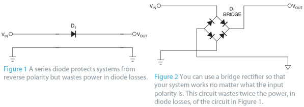

    All you have to do is place a Diode on one of the leads to protect the circuit.

                The CURE to connecting a battery backwards is a bridge rectifier. (4 pin device or 4 diodes)
                Connect the battery to the AC inputs, disregarding polarity. The + and - outputs go to the original battery inputs.
                If you doubt this, draw it out and try both directions of the battery. If connected properly in the circuit, + out will be + voltage. It's all black magic.

                  That diode isnt beefy enough its only rated at about 500ma so very liable to go short circuit and you wouldnt know until its use is needed.
                  Also putting that one in series your loosing about a volt, so instead of 12v your running on 11v Your better off with a shoskey diode IN5817 20V/5A there cheap as chips and more than enough for what you want and less volts drop.

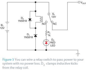

                  Another way we used to do it with taxi radios where they were taken them in and out of diffirent cabs was to put a shoskey diode across the +/- supply and if reverse polarity happened current flows through the diode and would just blow the fuse.
                  The best way is using a relay and a few components, which draws no current when polarity is connected correctly .
                  The draw back with using four diodes is your wasting at least twice as much power as the single diode method hence why its rare to be ever used when using batterys, but can be very useful when building projects using a bench power supply.

                    here you go, if connected wrong polarity the LED light up, note there using to shoskey diodes, there fast acting.
                    When you applie correct polarity D1 becomes reverse biased and the relay stays off, when incorrectly connected D1 becomes forward biased and activates.
                    Very simple and effective.
                    The relay for the TGSL etc can be really small but oviously sizes will vary depending on power rateing of project.
                      These are other options sugested which are simple but have there downfalls.
                      I often use the bridge when working off my bench supplys, a blessing when getting tired and open to mistakes

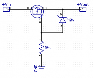

                        This circuit uses a p channel mosfet, ive not tryed this one yet but looks dandy, hopefully we get some feedback from others on this one.
