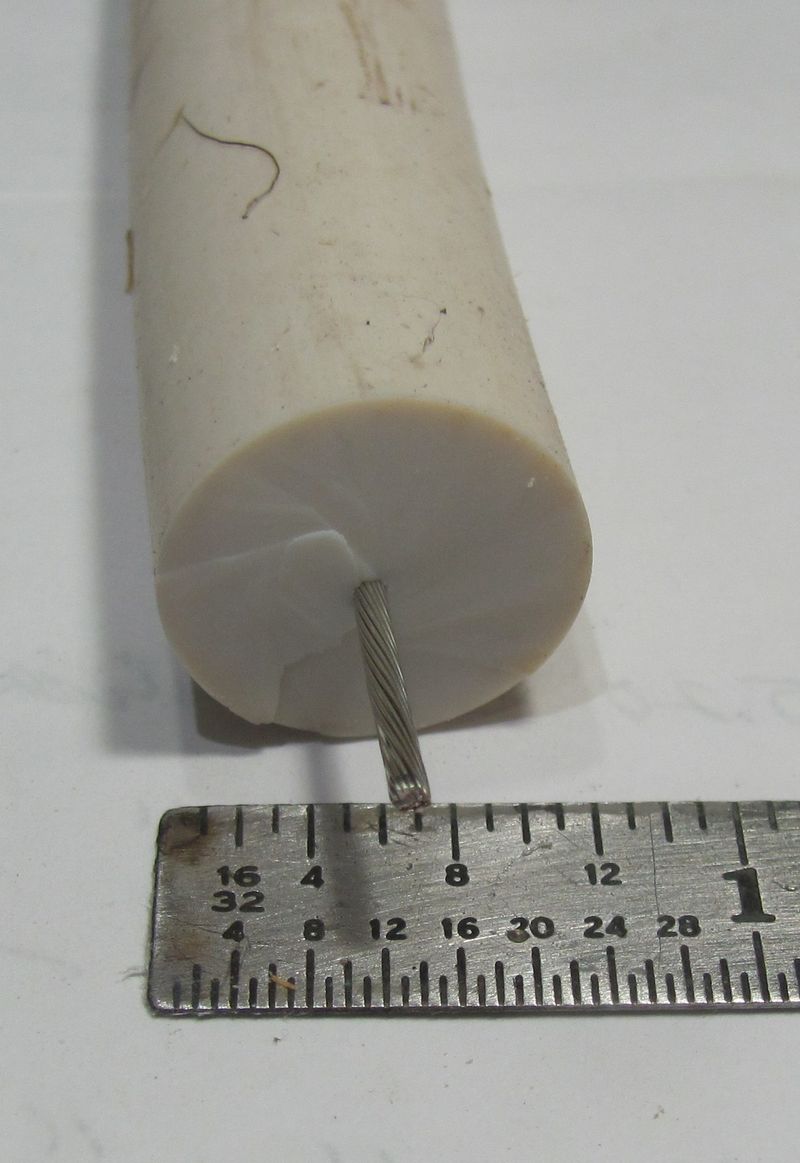

        "bernte_one" A Car Coil Fencer puts out OVER 15KV and in a Very Fast Sharp Spike.
        And an Insulator is effectively a Capacitor.
        And this voltage Spike will travel right Though Many Insulators, Resulting in Shorting out the HV Wire.
        The More Insulators and or the Greater the Total Capacitance, the Greater the Loss
        If you look at the HV Wires going to the Spark Plugs on older cars, they are Suspended in Mid Air as Much as Possible, Because the Insulation on these wires is Totally Useless for this type of voltage.
Name:	100KV Test Lead.jpg
        Even two feet of this 100KV DC Test lead buried in Earth will Short out a car coil.
        Took him awhile to get Good Insulators, but One Guy in Hawaii is using my fencer-2 to stop Wild Boar on a 1 KM long Fence and its working good.
        Most Fencers put out a DC Pulse of Less than an 8KV which will Not Travel through Insulators.
