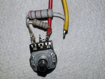

              having problem with the detection range and sensitivity. i built bara without scope, nulled to 0v, delay adjusted (when have max sensitivity just before drop and become not responsive). max detection 20cm for medium coin. AL foil not detected, small coin 5cm. coil i made one from internet network cable stripped, have like .5mm litz wire with pvc coating, 24cm diameter, 27turns. it can be the problem the damping resistor? what is the relation between damping resistor and coil value?

                  yes its your damping resistor you can prob do it manual what i did was use 220ohm resistor attached to a 1k pot with a 1k resistor across the pot to take the load, just get a small square of foil and turn it till its detected then take it off test the resistance and put in one thats closest to the value
