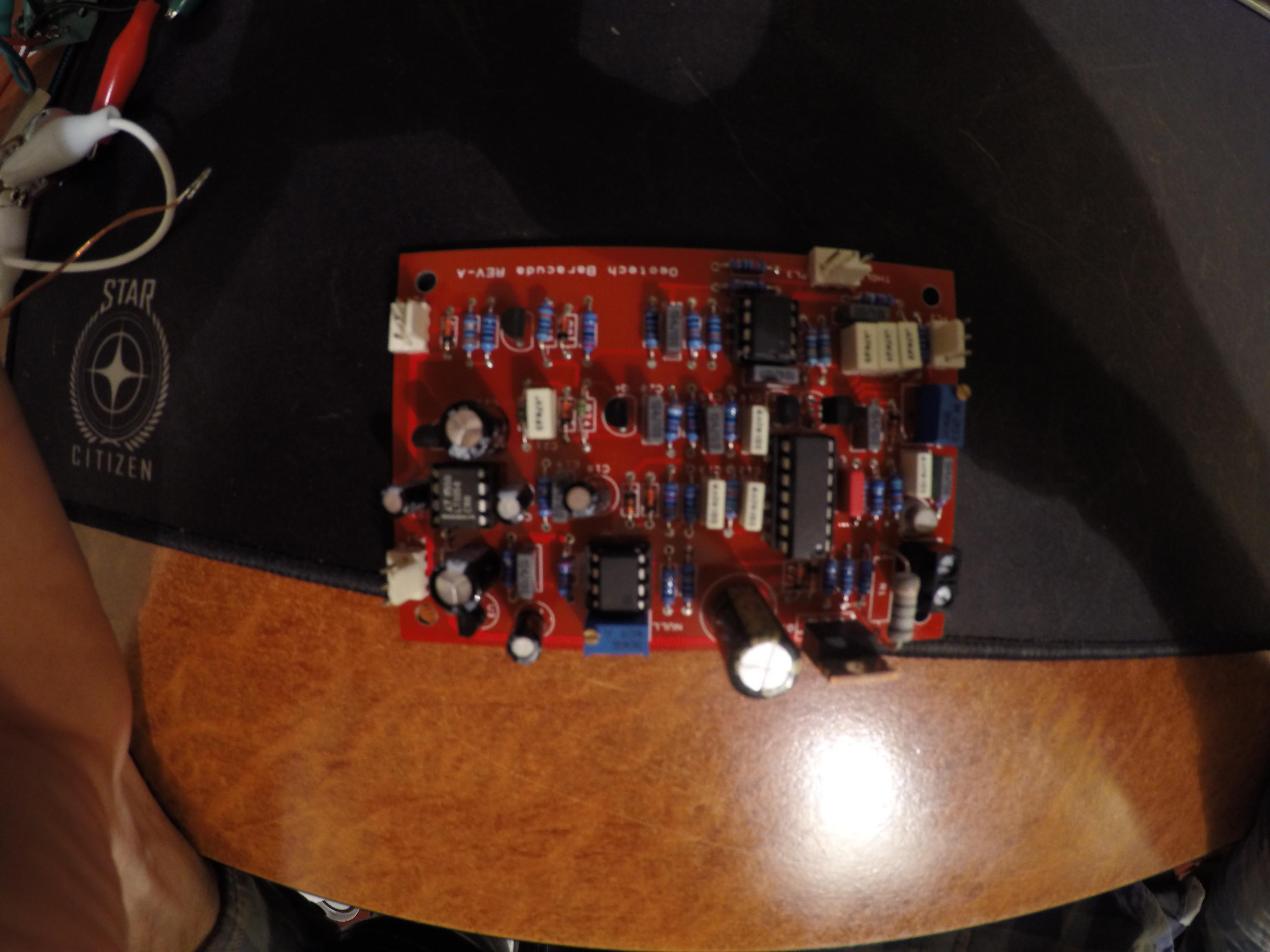

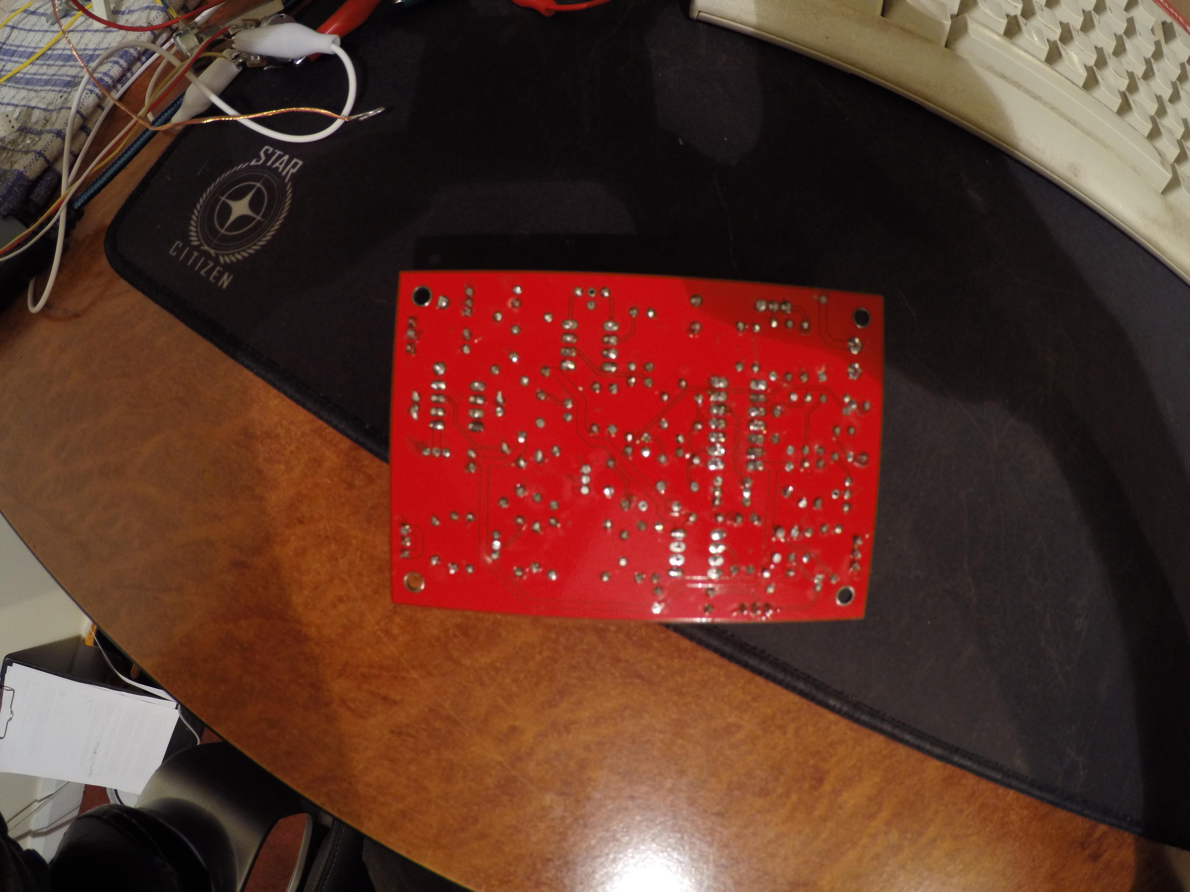

            Have finished the board with the every thing in place, tested for volts and found negative rail only getting -4.7v is that a problem? In step 7 trying to get the volts to -2.7v can not make that voltage only -1.7v now I'm thinking it because of the -4.7v supply!! After reading forum over and over I have decided to buy a oscilloscope to help with this build as my automotive oscilloscope is not good enough to dial in my coils to the barra. the barra dose pick up sig with every thing connected but only 10cm on screw driver which I'm not to concerned about until I can hook up on the oscilloscope. my main question is- dose the -4.7v rail a real problem that need to be repaired so it is a true -5v

              I'm guessing that you didn't read the part in the Build Document where it says:

              I would advise going over each step in a methodical manner, and fix any issues you find before proceeding to the next step.If the power supplies are not measuring close to 5V, then you'll need to fix that first. An oscilloscope will very useful.
                Emmmm Where do you get this -2.7 voltage from ? It calls for -2.1 and your -1.7 is quite close. Did you short PL2 ?

                  thanks Qiaozhi and Homefire, MMM I don't know why I put -2.7v in my statement just not thinking to straight when typing this up,should have type -2.1v. When I was building the project I thought I was doing it step by step. every thing was right on the $$$ with the build to as written out in the pdf, Untill I stuffed up and shorted a couple of pins out on U5, so got a new LT1054. now I only get -4.7v now I'm not the bright spark in this type of electronics but step 6 lead me to step 7 with out oscilloscope, so with the voltage with in a few .V of where the preferred v should be lead me to think that is why I cant get -2.1v on pin u7 pin1 and I shorted out pl2 pin 2 shorted to pin 3, I can make voltage change not a problem just could not get the -2.1v and the instruction states, other than that the detector work quite well. hope this made more sense on what I was trying to get across

                      When you were following the step-by-step instructions (before you shorted something out) was the negative supply voltage at -5V?
                        Yes it was at -5v , could of U6 have been damaged by the short? or C22 C23. I know in the automotive game relay and alike do burn contacts and give false readings to what they should be with age or too higher current, after a google to find how these (u6 U7 type of chips work) they are basically a multi switch of sorts. any way I like to problem solve I just have to wait for oscilloscope to turn up, as you all say it is a invaluable tool to tune and problem solver (maybe)

                          What is the voltage on U5 pin5 (LT1065)?
                            Battery pack down to 11.5v U5 pin5 -11V...................so found new battery and now 12.8 U5 pin5 -12.1, now with the agm battery hooked up I get-4.9V and just to clear up all so get 5V on other rail, all so u7 pin 1 now get -1.9v so between the battery pack not so new battery's which they are have not lasted more that 1hours worth of testing at 12v, and the board likes a good clean supplied 12v has helped with the V situation

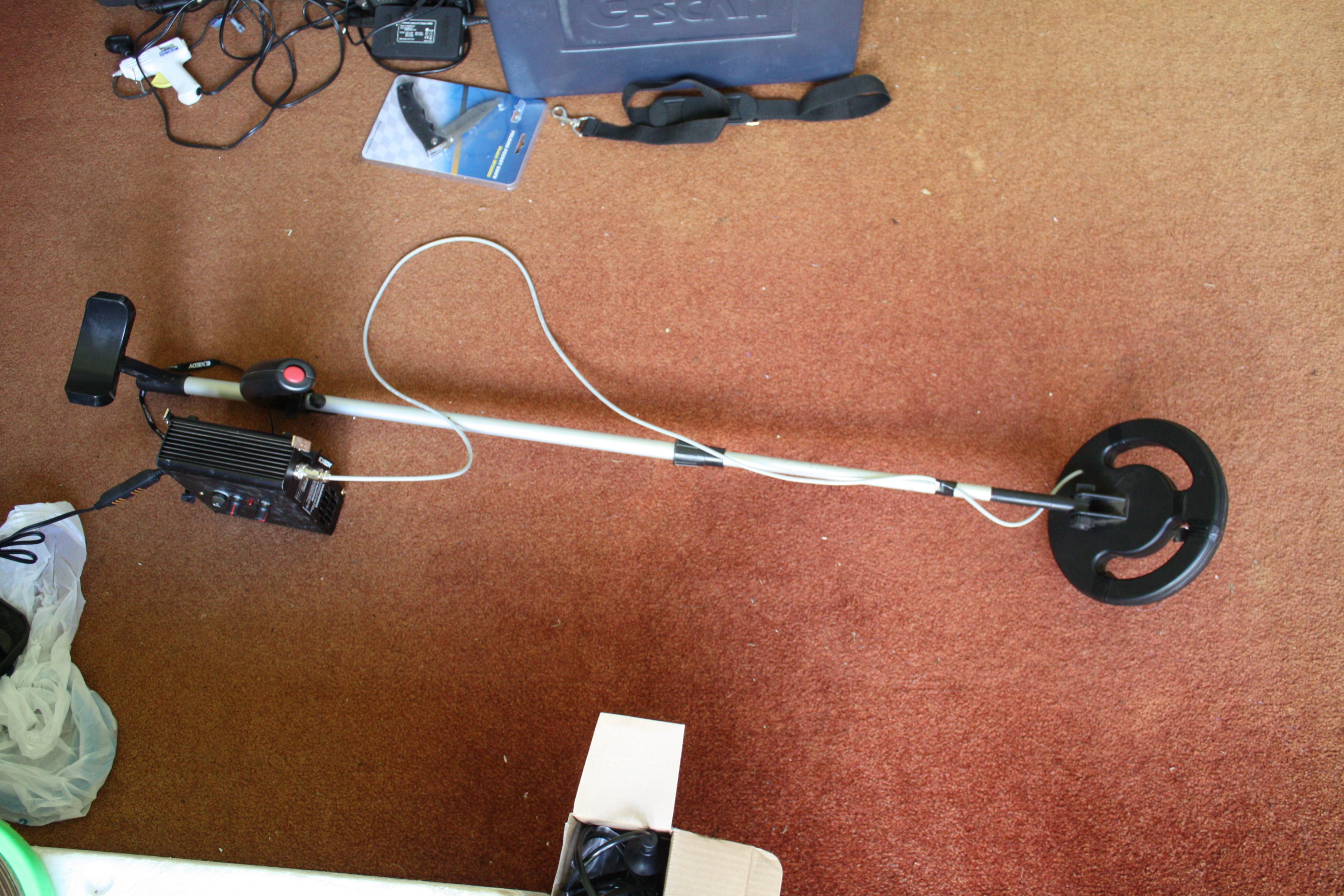

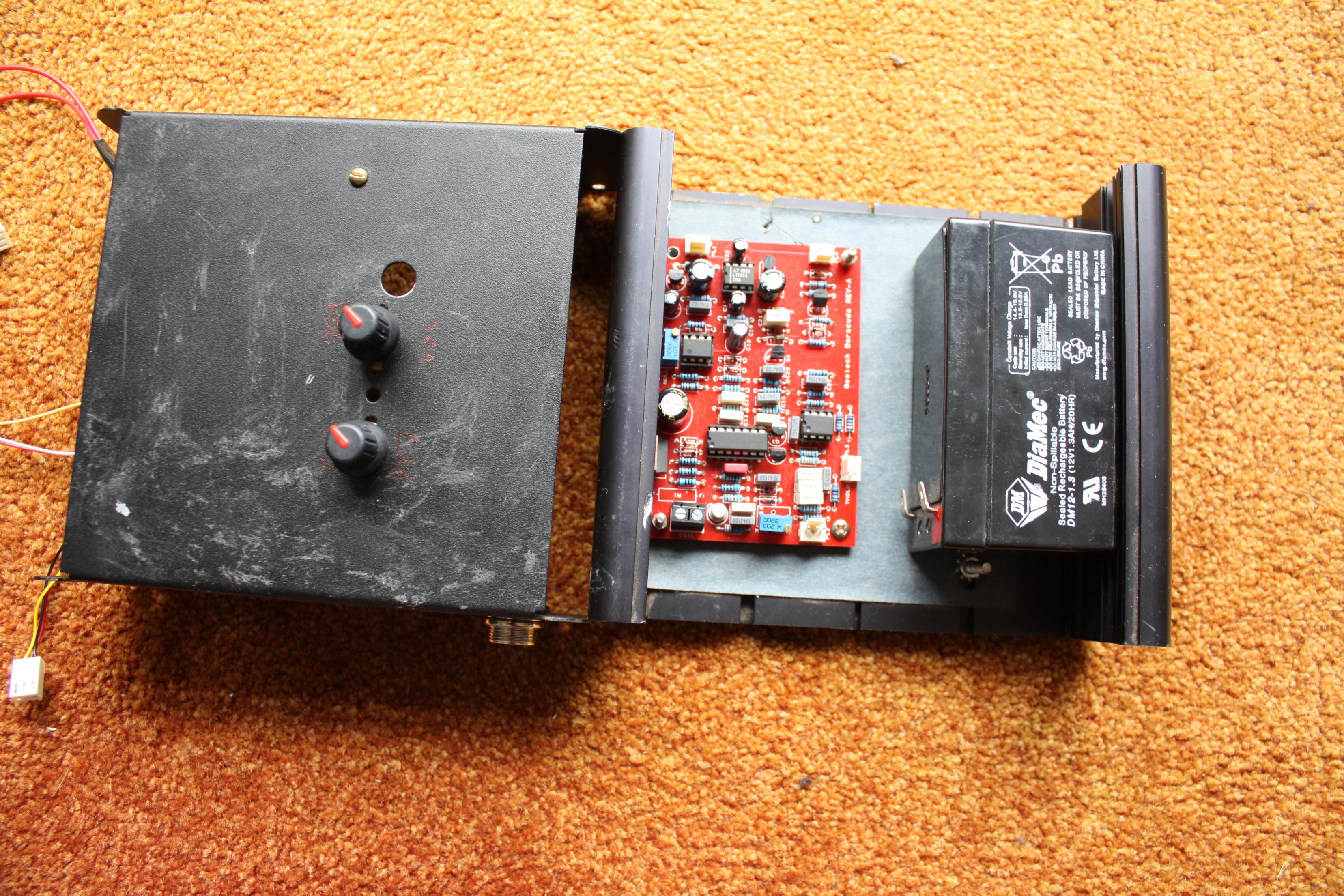

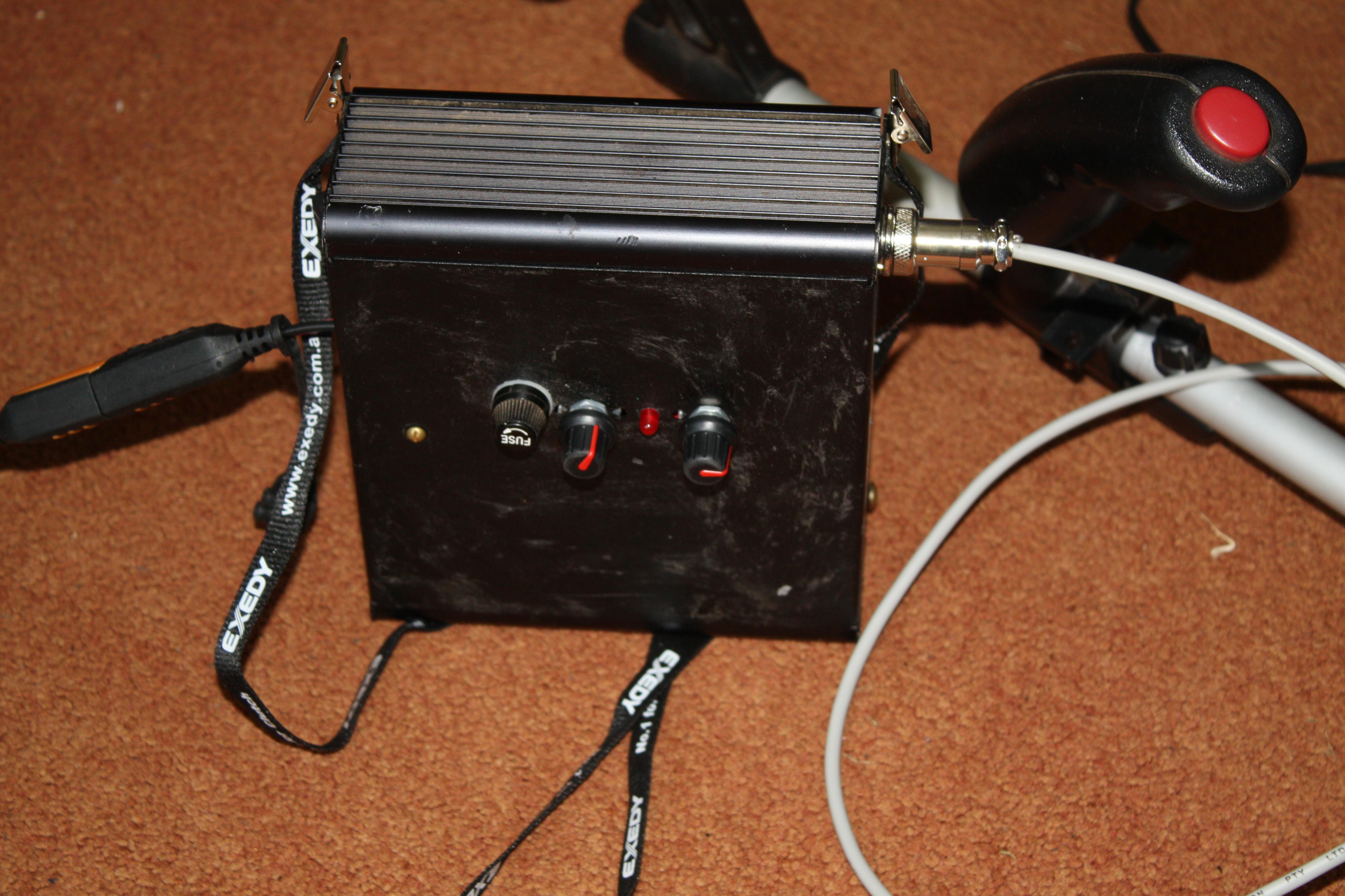

                              just an update on this project as its all working sweet, good depth with the mono coil as in image with graphite shielding. 9kt mens ring in the beach sand 220mm .Have a flat spiral coil @250mm dia that pick up the gold ring @390mm in beach sand, so happy days. thanks to all who helped along the way to build my first PI detector. Now to silver dog in the new year for my next kit or may be kits
