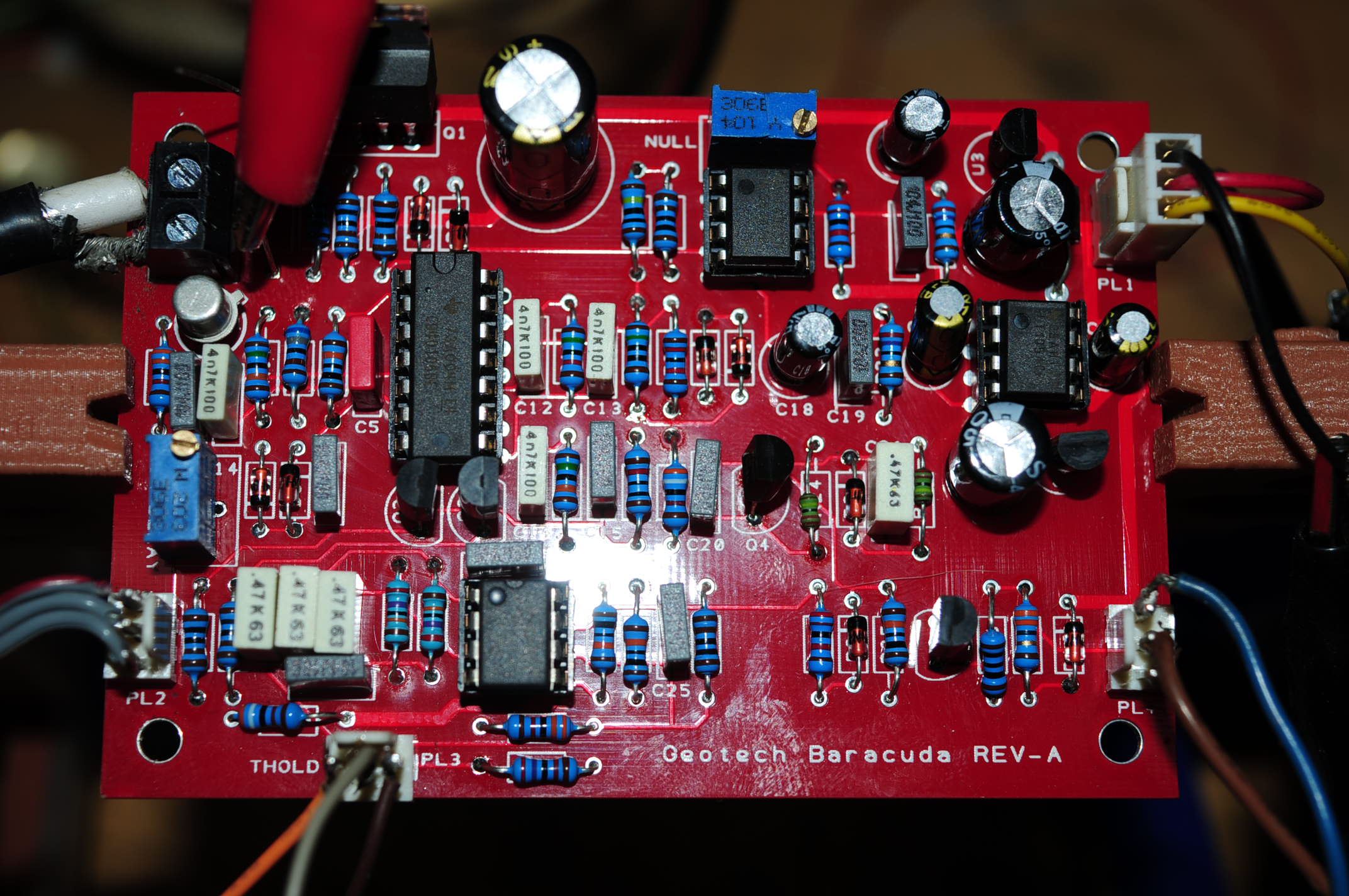

                  im also having issues , everything works, Depth is good but it only works with a piezo speaker. I might have an issue with step 8 and 9 ?
                    If it works with the piezo, then it should also work with a speaker or headphones.
                      It should but it doesn't hahaha, its almost like the speaker is asking for two much power, I hear a the power supply asking for more energy when I use the speaker. its like it inverted somehow when the speaker is plugged in, the sound drops when an metal object is passed over the coil. but I did do a boo boo , I put Q4 in backwards, I might of blown in ? maybe why its not working with a speaker ?

                        Actually I do seem to struggle with Film Caps, perhaps you guys can look at the photo and make sure I didn't them up. EDIT: also I can only set the null pot to 0V off pin 7 and not 6 as mention in the build guide.
                          [ATTACH]40213[/ATTACH]
                          The measurement should definitely be made on U2 pin6, not pin7. Pin 6 is the output, whereas pin 7 is the +5V rail.
                            you are right, I was counting the pins wrong and added one, my 8 pin ic had 9 for a while hahaha
