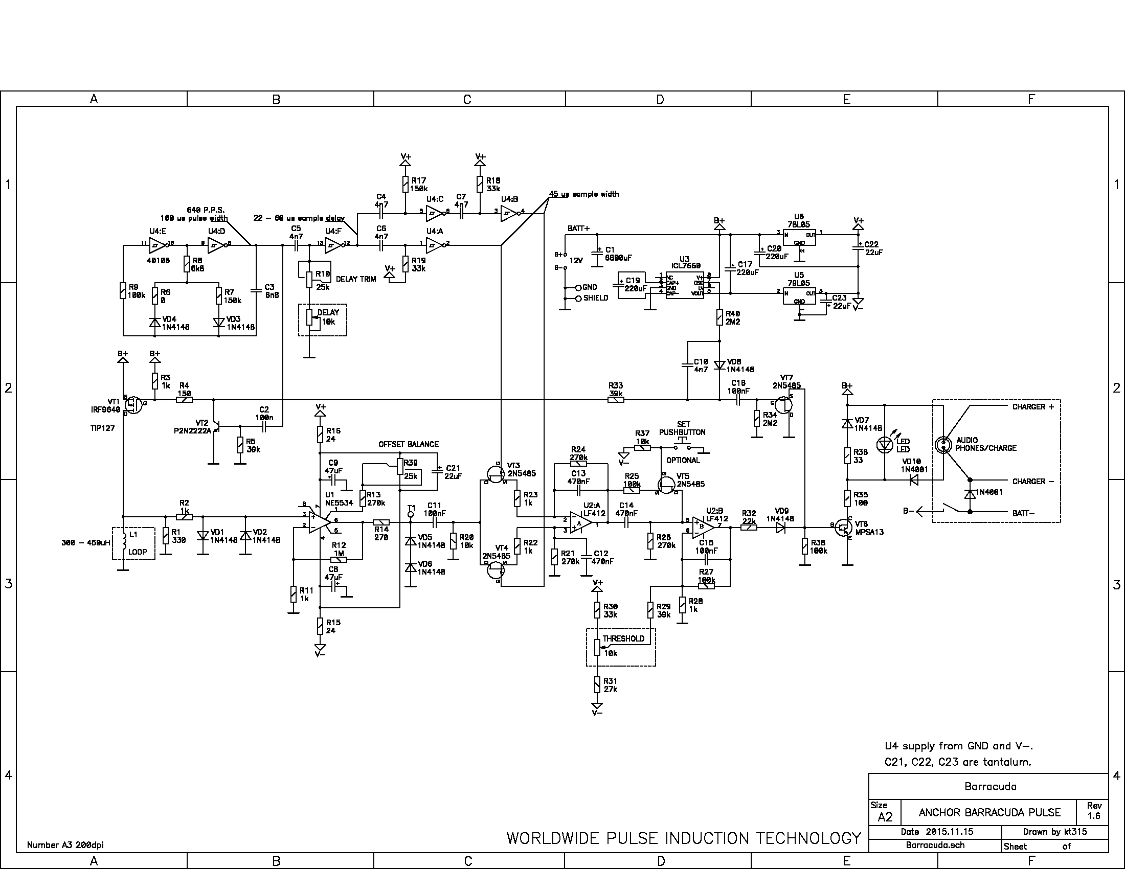

    Hello!
    I want to experiment with baracuda and i'm wondering how can i adjust pw and prr adding trimmers. I can't find info on this type of oscillator. i don't want to modify to much the schematic. I will need to adjust up to 10000pps and pw in range of 20-300us.
    Many thanks

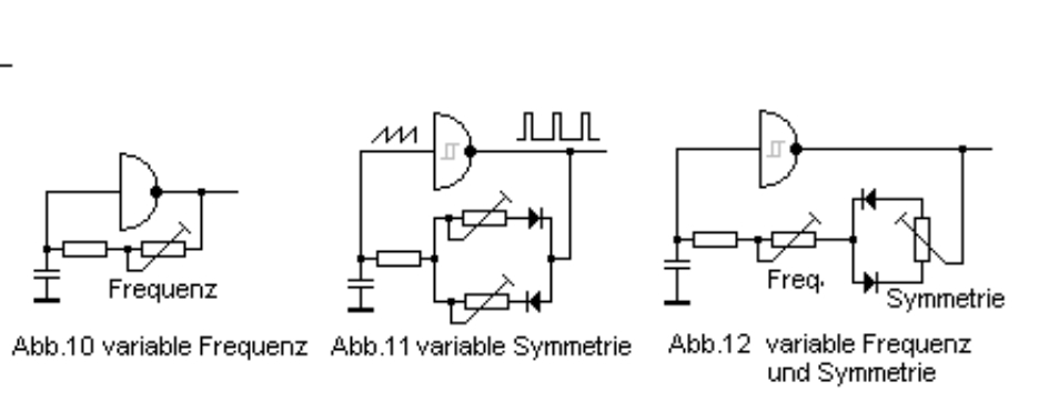

    This might help you:
    Found this in http://homepages.internet.lu/absolut...ic/digosz1.htm
    Maybe this is of interest too: https://www.electronicspoint.com/thr...llator.280367/
      R7 controls the Pulse Count. Mine is variable from 500 to like 750 using pot in line with original Resistor.
        Replace R8 (6K with 47K trimmer, replace R9(100k) with 220K trimmer, "play" with C3 (6n ,for more PPS ,make it smaller (1nF).
          Thank you guys for help. i use revA schematic, the last one, geotech baracuda. I don' t know what schematic you using.
          thanks
            Ok, now i found a schematic matching your answers, i will just post it here so the thread will make sense for future members interested in this.
            With this occasion i thank also to mr KT315 for the schematic and contribution for this forum.
