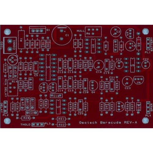

    Could someone let me know the size of the Geotech Baracuda pcb?
    the size has to be printed on every board.
      it does not appear to be on the PCB
        did you see my board WITHOUT the size on them? NOT.

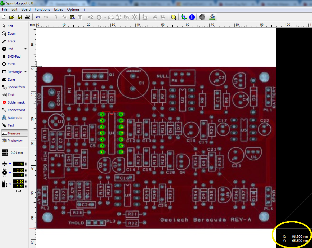

        use sprint layout. put the pic like a layer and to scale it on scale grid 2.54mm.
        you get the size.
          Baracuda REV-A pcb 96,9x65,6mm
