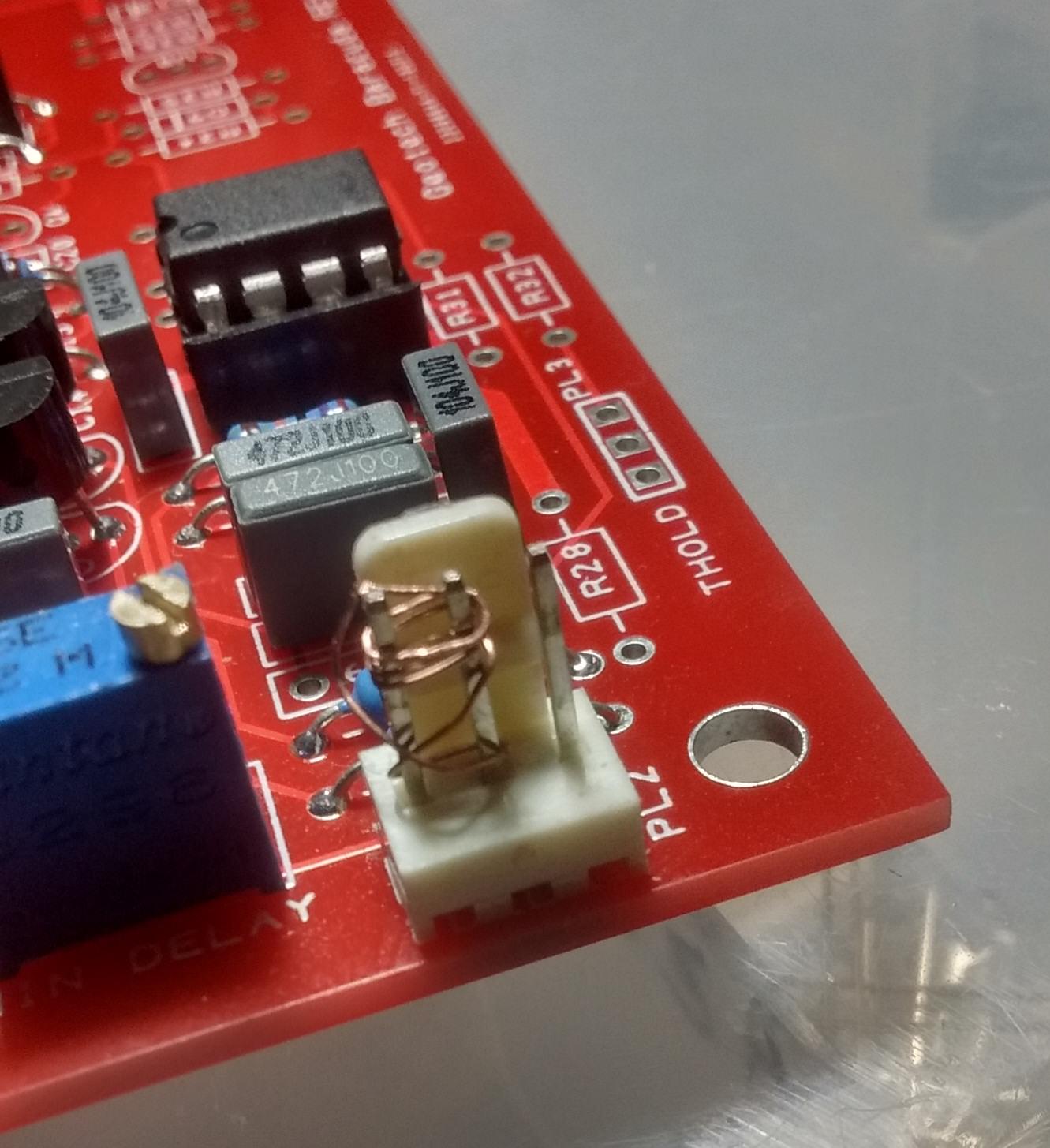

                Here is a photo of the pins shorted, I'm sure thats not the problem.
                The voltage doesn't change when I adjust r14, it doesn't move from 0V. I tried with the trimmer all the way up and down, and I checked also that the trimmer was working. What I noticed is that the speaker below the coil picks up the signal and i hear the frecuency going up and down when I move the trimmer.
                  Maybe only a cold connection, soldering this part again.
