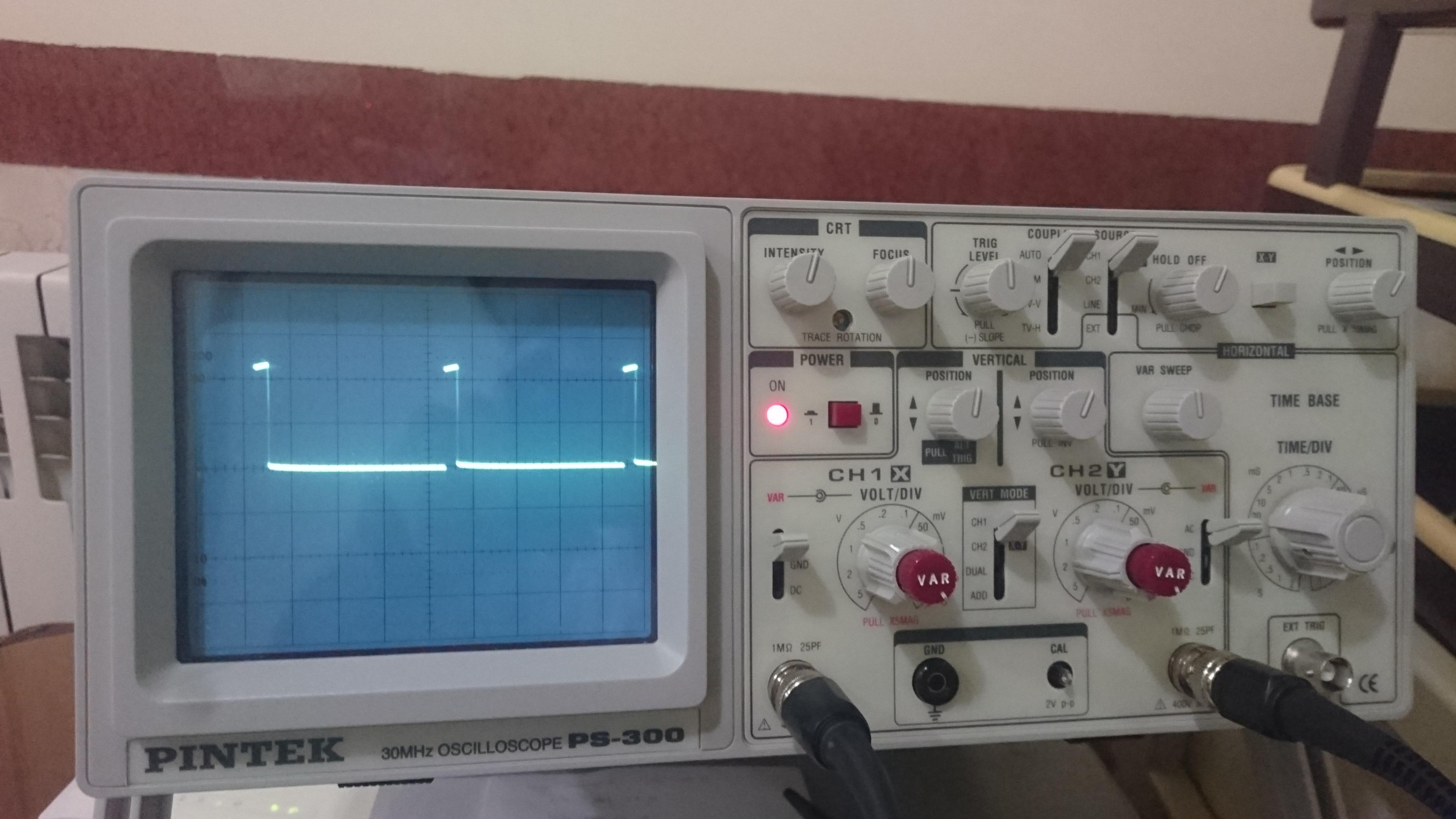

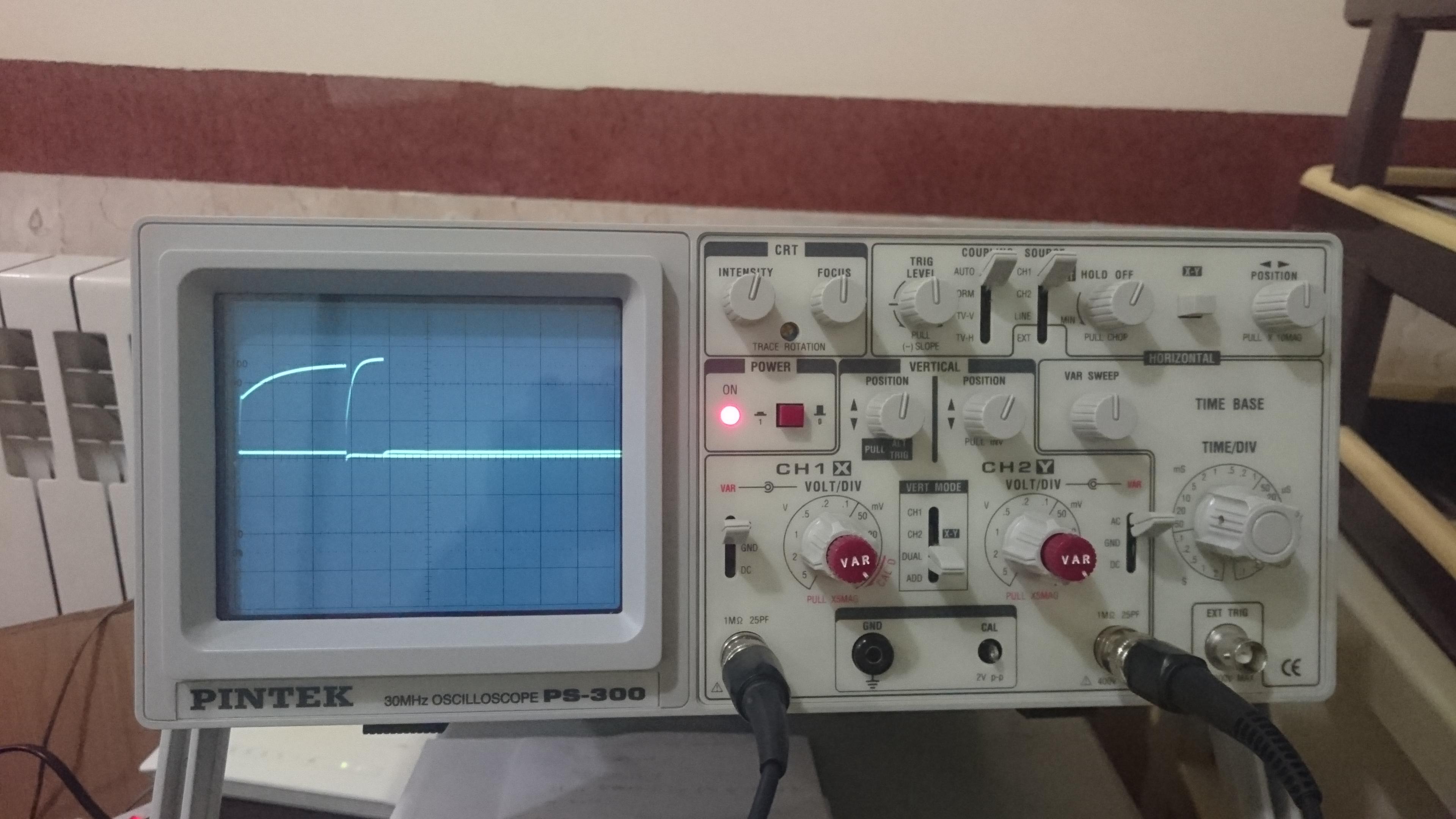

    Hi everyone.
    I'm building geotech baracuda, managed to get to step 7 but when measuring pin 1(u7), the voltage oscillates and never stops, the min and max has around 0.4 volt differences.
    please tell me what I did wrong, I attached images of signal on pin4,6 of U4 and signal across R1 (damping resistor).
    when I place target near the center of the coil nothing changes pint 1 of U7(except the oscillation I mentioned).
    I adjusted minimum sample delay with oscilloscope but when I wanted to check it with multi meter , like step 7 its value its nothing close to -2.1 volts.
    * coil : 440 uH
    * pl2 pin 2 shorted to pin1.
    * double checked the component values.
    ps: not silverdog's board.I built it myself but double checked it in case I made a mistake. nothing found.
    thanks

    What is the scope's time base in your images??
    I would like to see signal at output of pre-amp, U2 pin 6. Then at junction of R16, C15 & D7.
    Also to see the timing relation of U4 pin 4 (TX pulse) to U4 pin 10 (first sample) then U4 pin 12 (second sample).
    Next is to check that the two sample pulses actually turn on the FETs Q2 & Q3 (FET pinouts can vary so double check these).
    Did you double check Voltage on each IC is correct?
      probably you do not see that CMOS power is -5V and 0V/zero. so hight level of your o-scope signal must be zero, low level must be -5V.
        thank you waltr ,
        I found the problem based on test points you mentioned, one of the FETs was not working, I replaced it and now It works fine.
        I completed the whole circuit and when I place a target near the center of the coil its voltage rises and speaker that I added starts to make sound,
          actually its just that the scope is on ac mode not dc,
          no problem with biases.
          thanks
