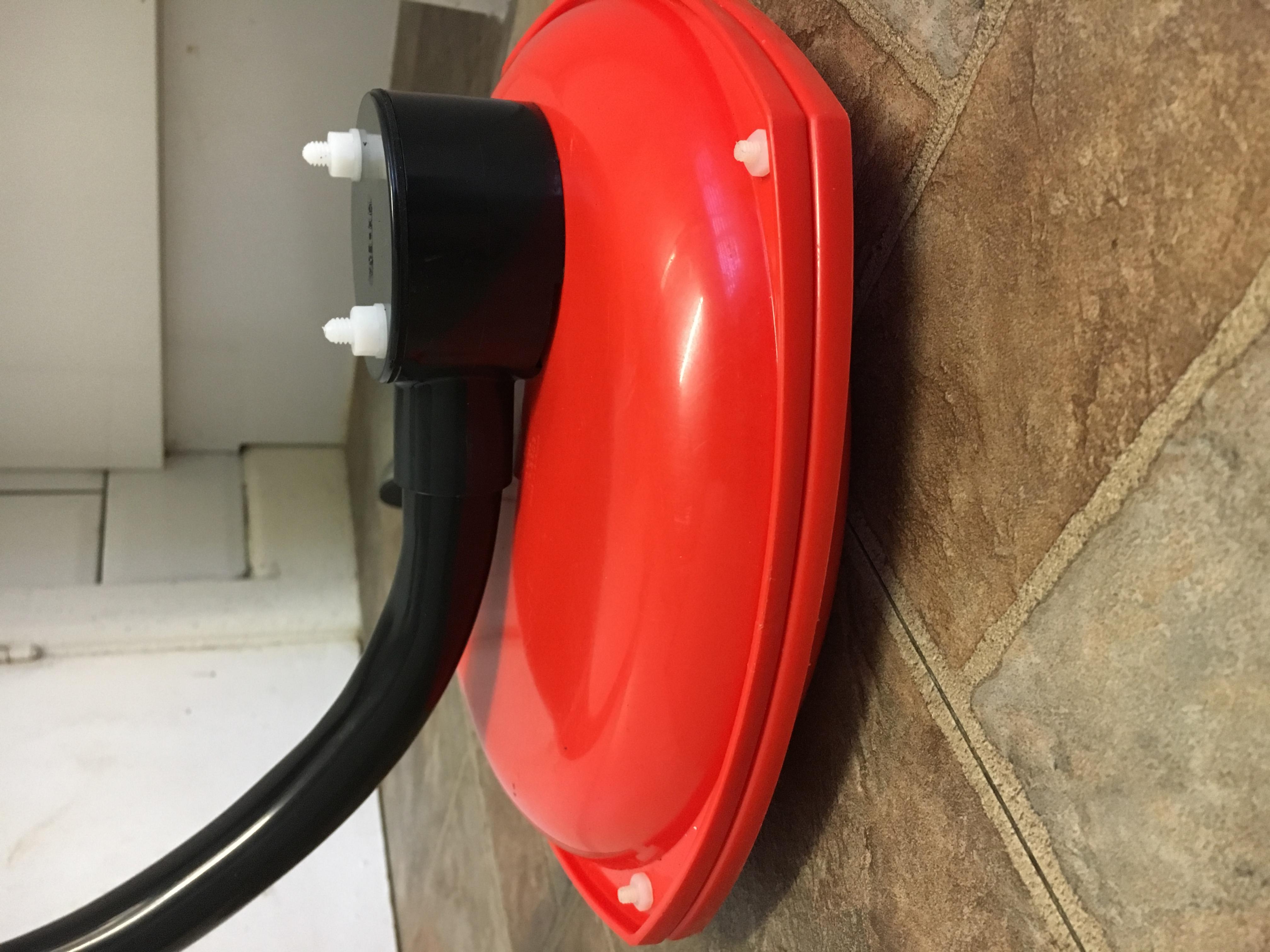

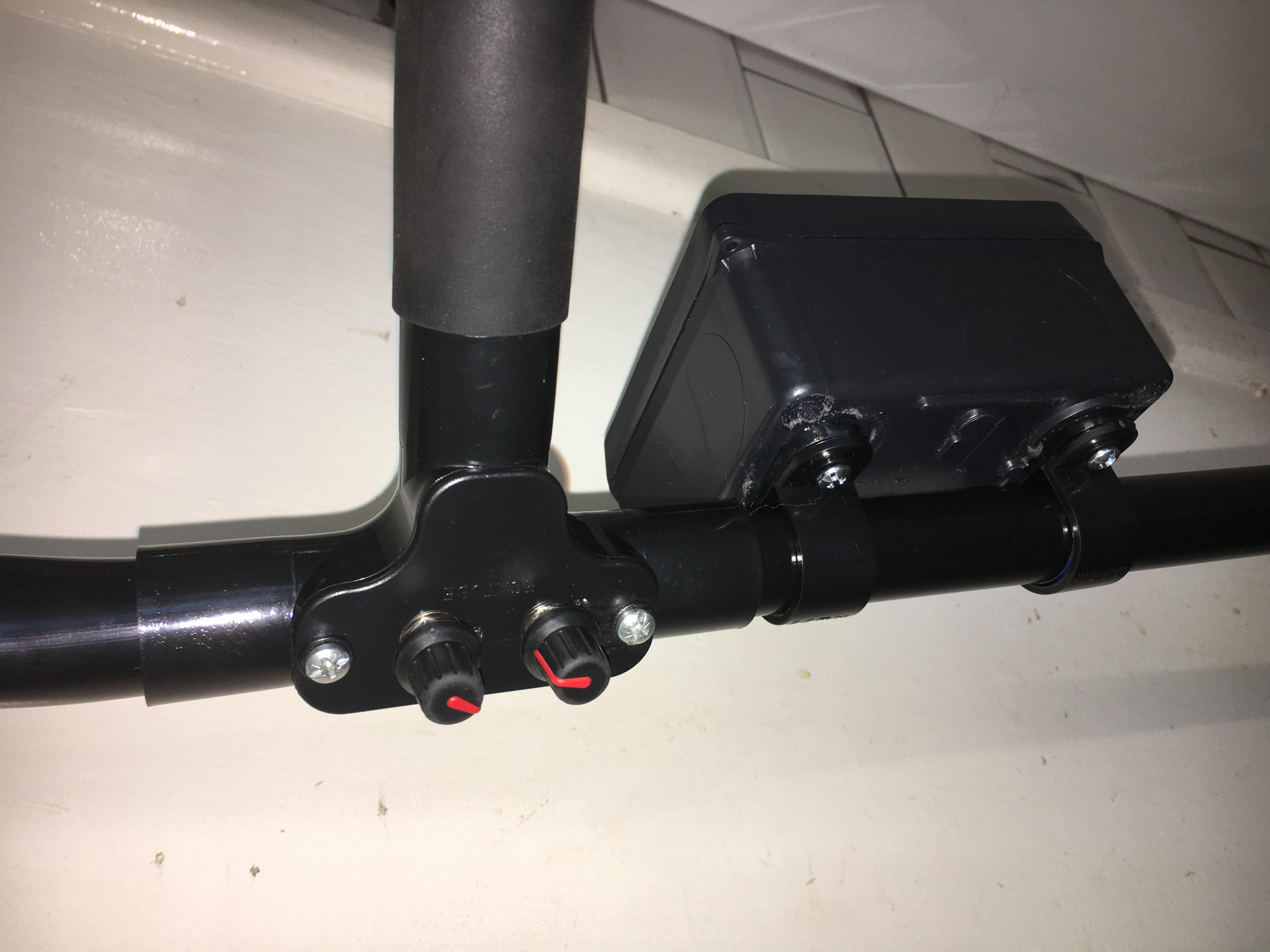

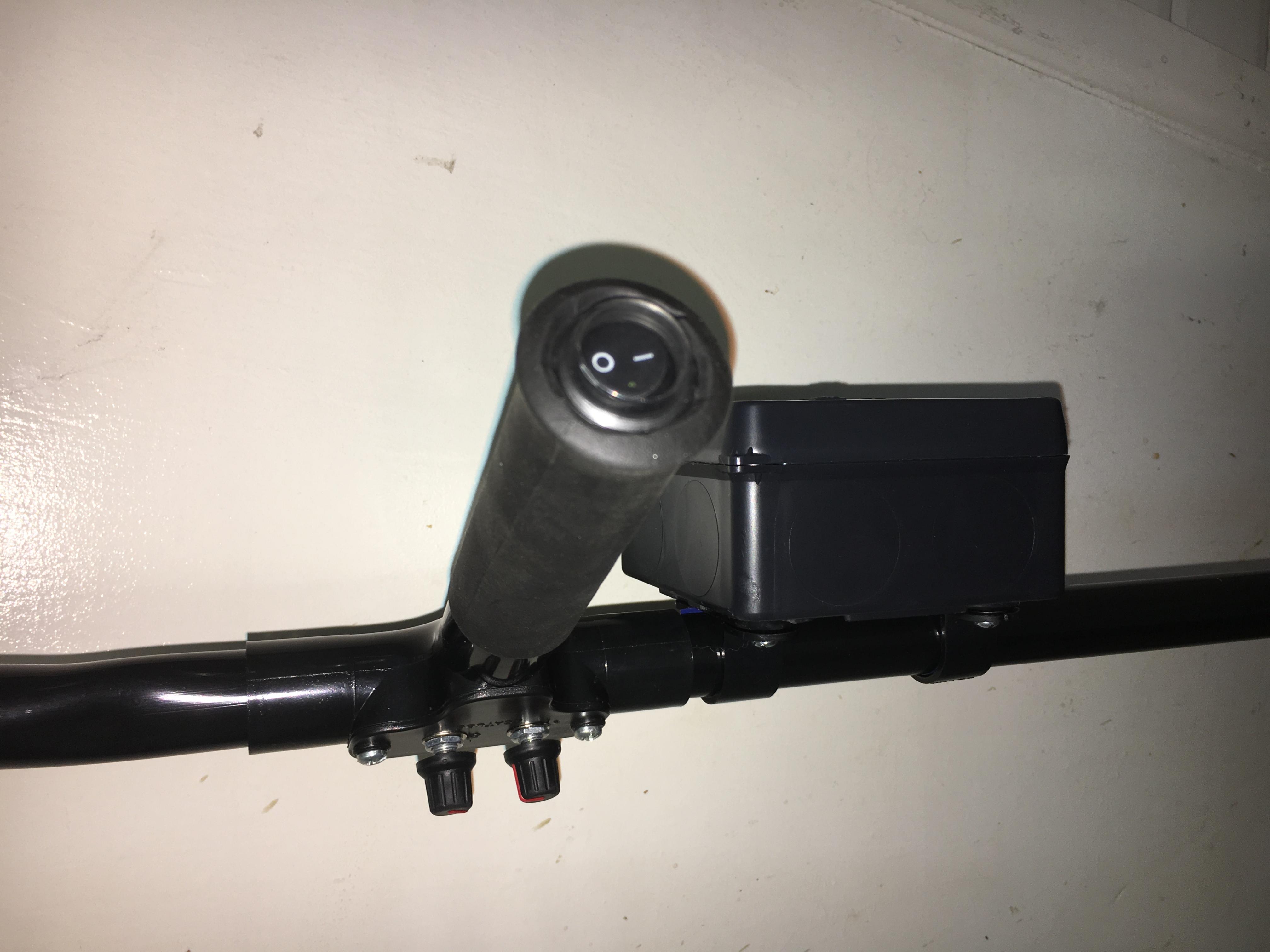

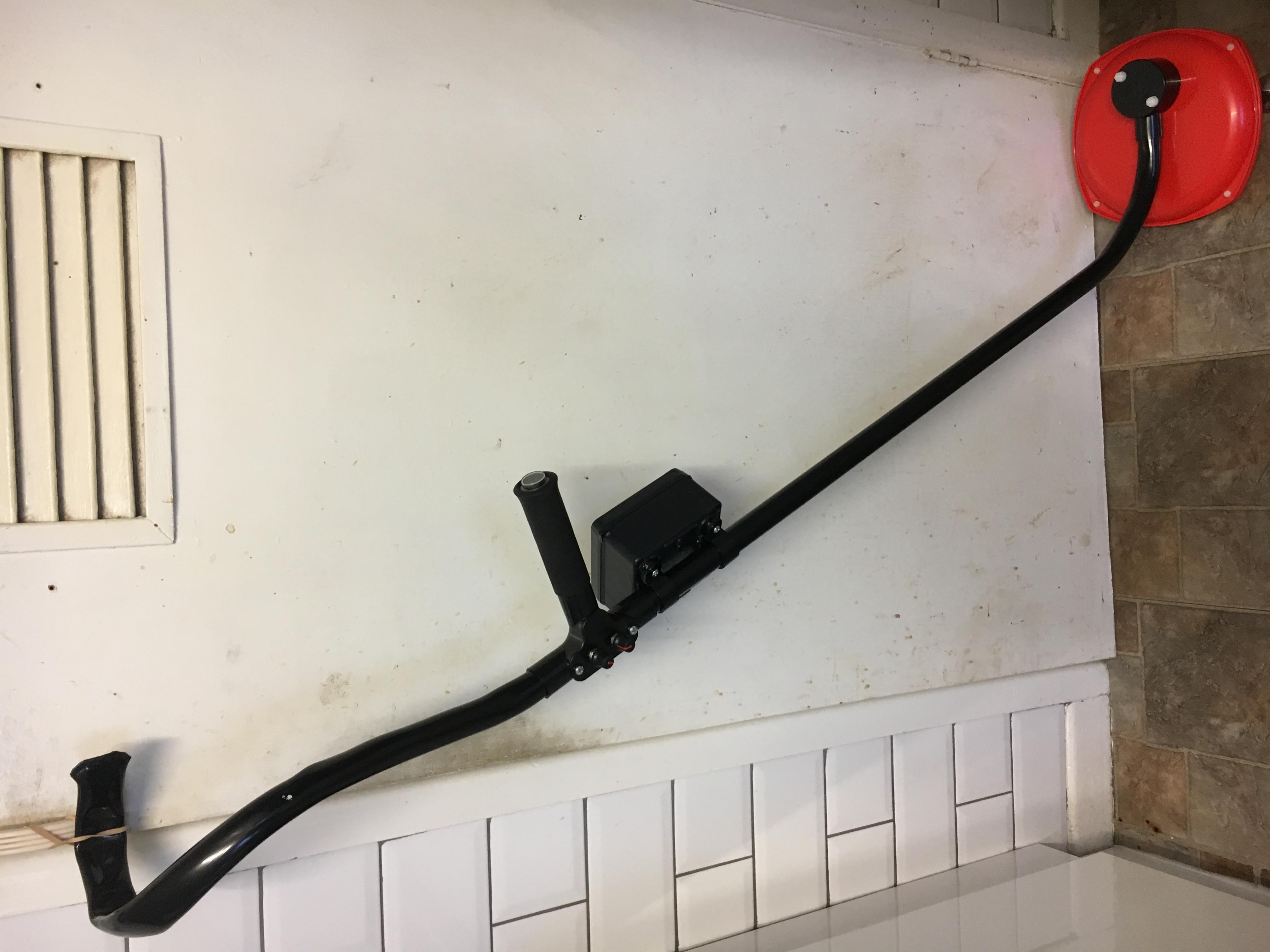

                    Managed to mount the on/off switch in the handle and the dials in the conduit access plate. The circuit box mounts nicely on the shaft and tucks out of the way quite nicely.
                    Coil housing is made of two plastic picnic plates concealing a 350uh coil, eventually the housing will be sealed but for now ive left it easy to unbolt while I perfect my coil making skills.
                    Ultimately I?d like to fit a dial on top of the coil housing that lets me switch between 300, 400 & 500uh but that can wait till the circuit is complete and working.
                    To join the coil and circuit box I?ve gone for 1.5m DMX lighting cable with matching panel mounts, the components have little latches that lock the plugs into the sockets so should be quite nice and secure.

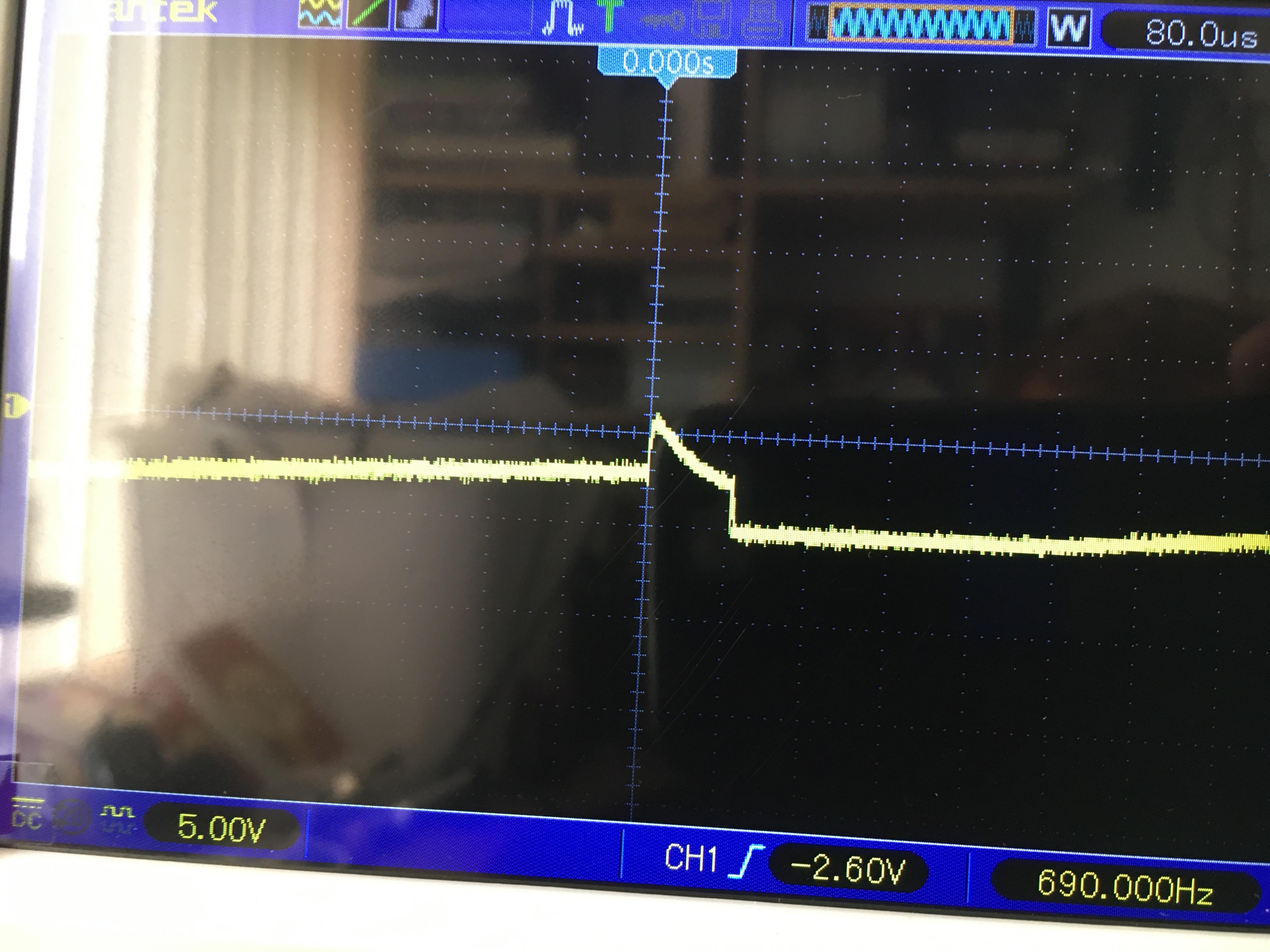

                    Here is a picture of u4 (40106)pin 4, it used to be a nice square wave before the short

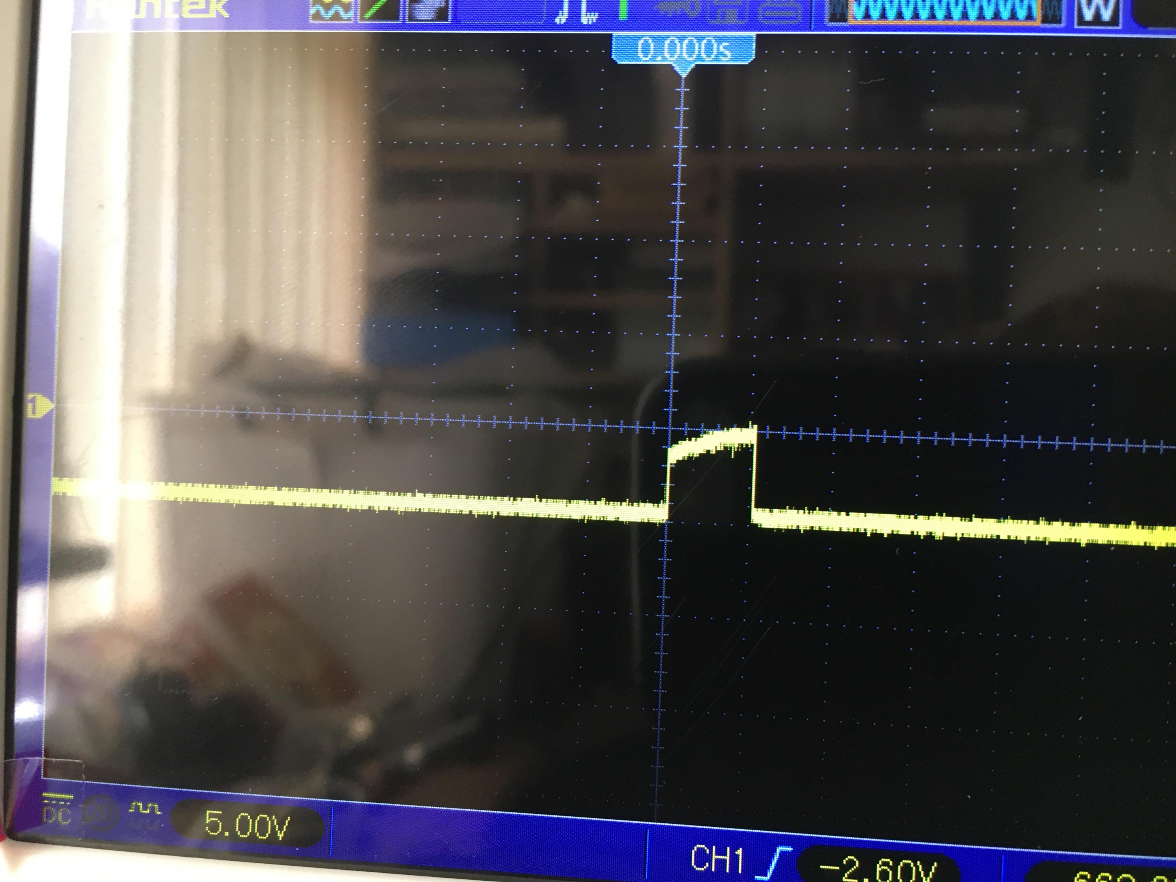

                    Now have a look at u4 pin 1, pretty sure it shouldn?t be be like this?
                    I?ve replaced the hex Schmidt at u4 and also the LT1054chip at u5 to no avail, waiting on some 2n222 transistors to turn up now.
                    Also waiting on some assorted low ohm resistors to run in series with the coil and drop voltage slightly (q1 is getting a bit warm with 240v passing through it).
                    Then after all that I can set the flyback resistor and carry on to the next step
                      Just replaced u1 transistor 2n2222 and still getting the same off shaped wave as in the pictures in last post
                      Its so strange, the power supply side of the circuit everything is looking good, getting a nice square wave all the way across r23 and up to u1, it’s at that point the signal is getting mangled, time to start replacing capacitors and resistors it seems
