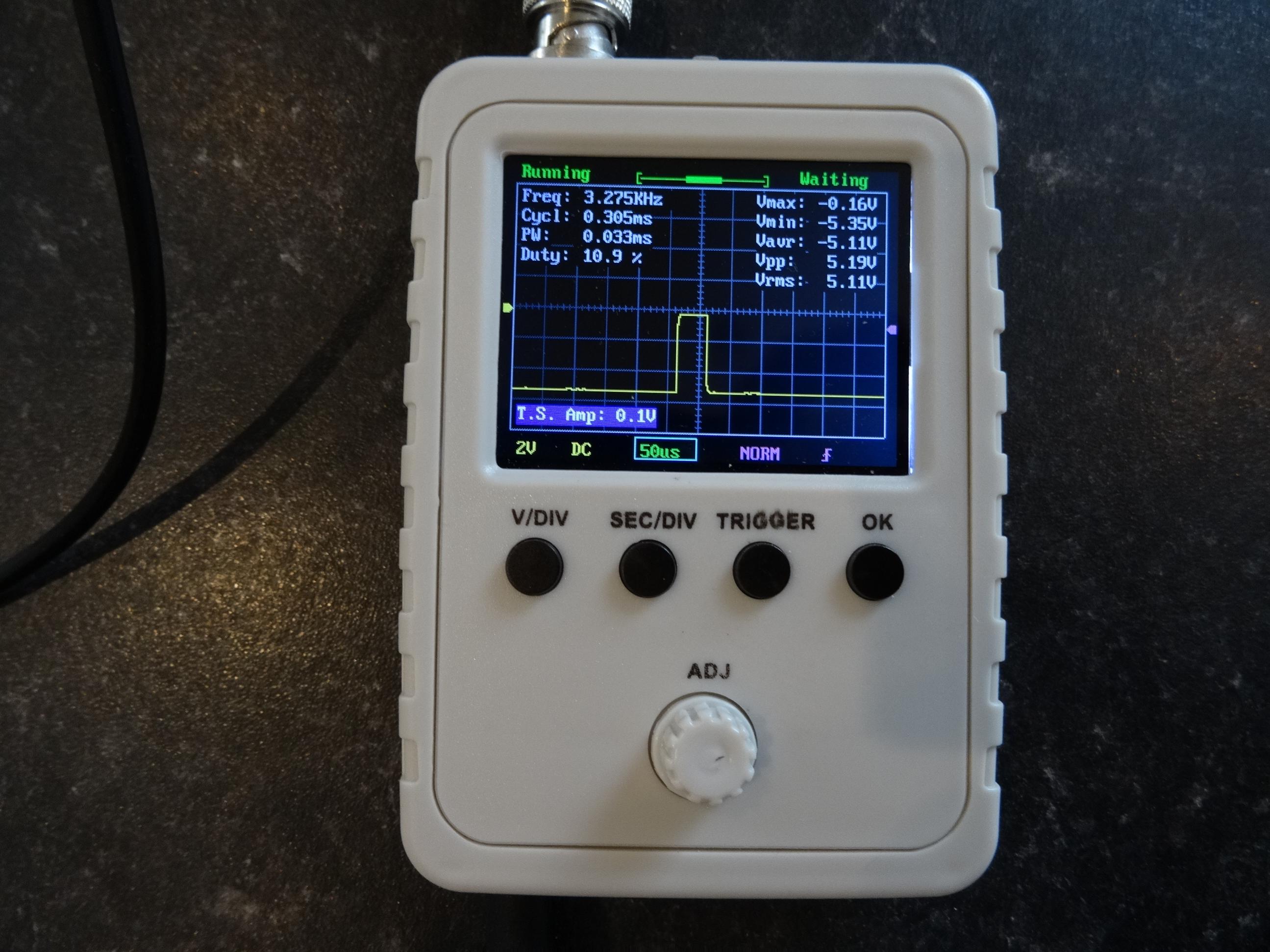

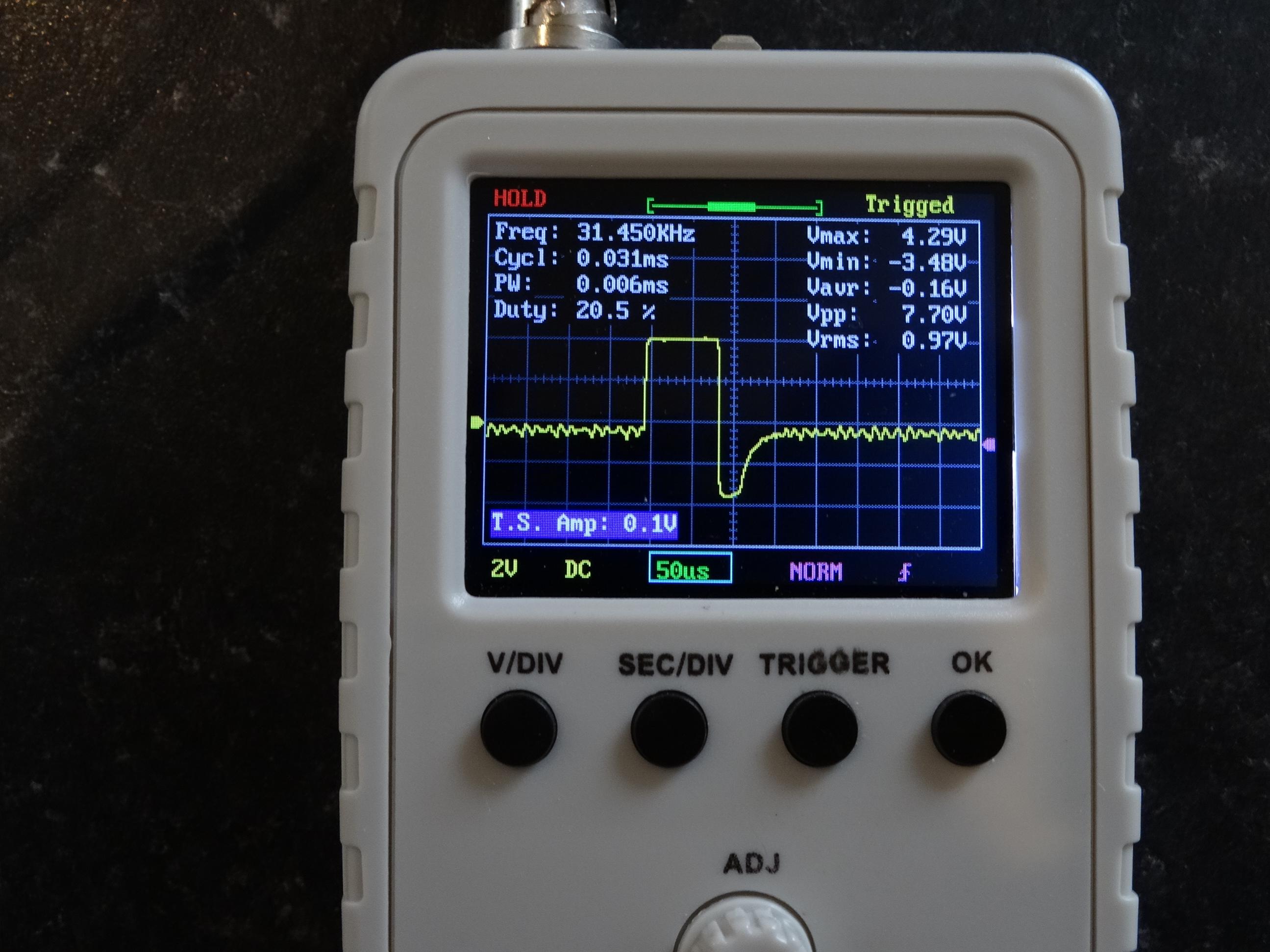

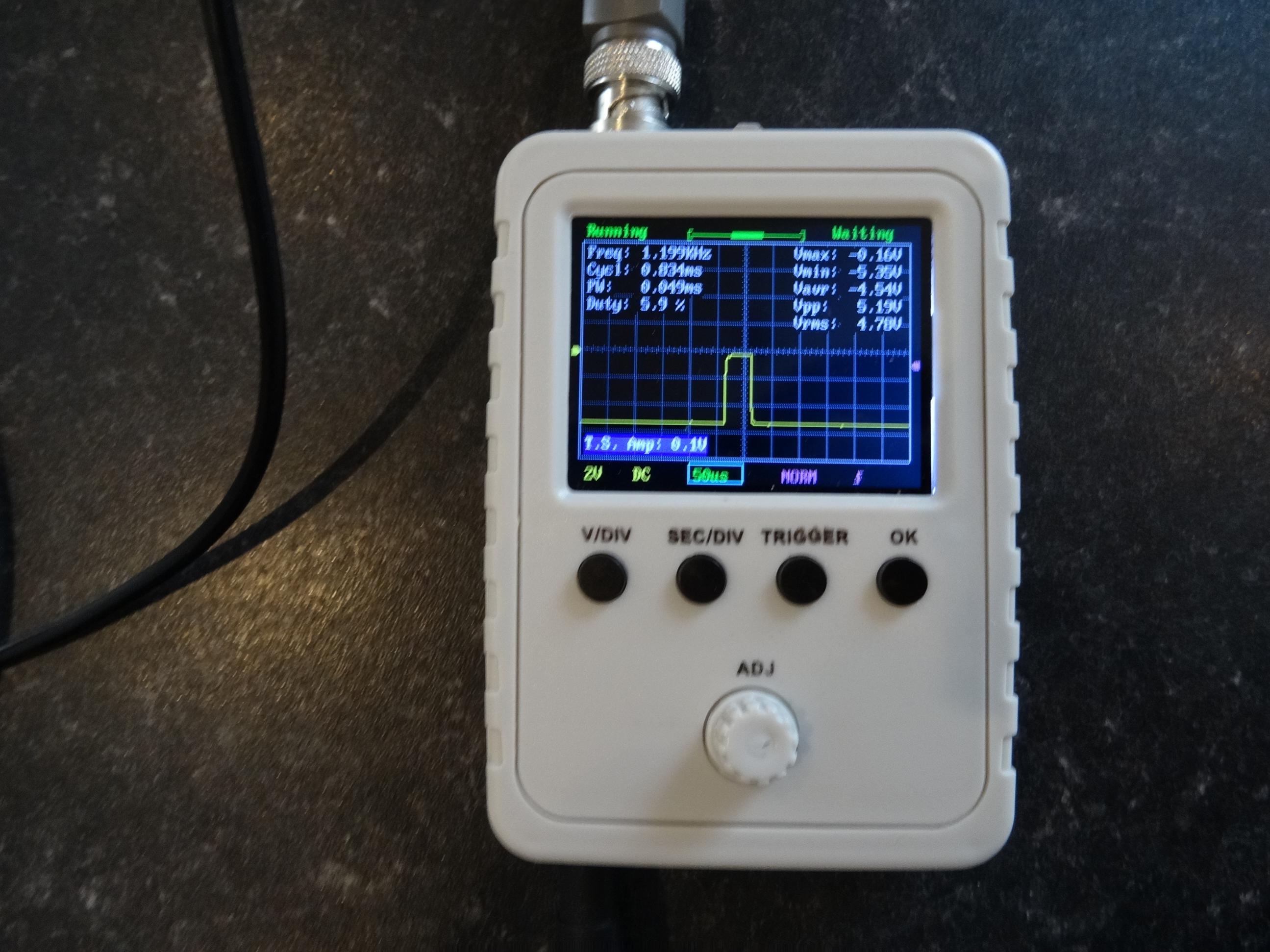

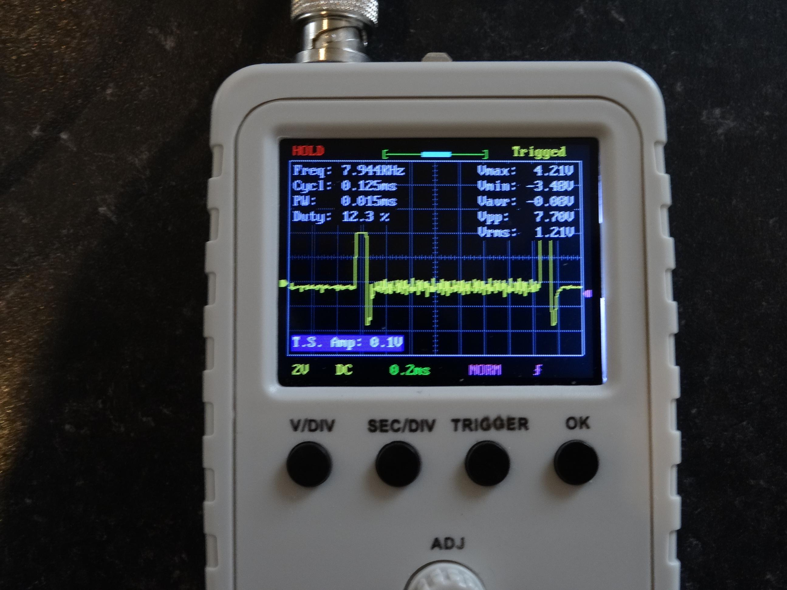

    Can you show us some scope pictures? These may help.
    1- Output of pre-amp U2, pin 6
    2- Gates of Q3 and Q2
    If would be best to see U2 out and each gate on the scope.
    Does your scope have an External Trigger?
    If so then this can give you timing differences. Connect Ext to preamp out and ch1 to FET gates.
    Now you can see the timing of the FET gate change when turning PL2.

          Pics attached.

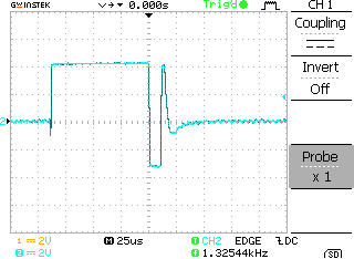

                  Bill's PCB is now working as advertised.
                  When I first tested the detector I couldn't find anything basically wrong or faulty. The only issue was that the minimum main sample delay was set way too high, and that would greatly affect sensitivity.
                  When I developed the Geotech Baracuda I wanted to keep as closely as possible to the original design, otherwise it would no longer be a Baracuda. The main focus was on fixing the various issues that others had found, such as intermittent failures of the 40106 IC. This meant that I had specified the mosfet as an IRF9530, whereas I notice that Andy has been supplying the kits with an IRF9640, which is actually a better choice. The IRF9640 has a breakdown voltage of -200V as opposed to the IRF9530 with -100V. The other thing I had forgotten about this design is that the damping resistor needs to be a much lower value than with other designs such as the Surf-PI, Hammerhead, or the Minipulse Plus.
                  The test coil I used had an inductance of 377uH and a resistance of 1.7 ohms. It was wound using 1mm thickness (with insulation) hookup wire on a 22cm diameter. This is not a fast coil by any means, but good for coin shooting. Normally this coil requires a 680R damping resistor, but the Baracuda needs this to be 330R.

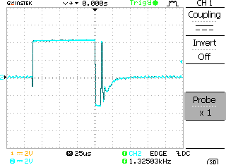

                  When I returned to Bill's PCB, after testing my own Geotech Baracuda board, I discovered that it had mysteriously stopped working. I traced the fault to U1, which was replaced with a 2N3904, as I did not have a 2N2222 available.

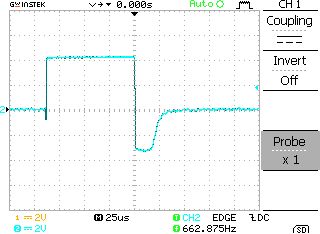

                  I have attached 3 scope images of the preamp output with various damping resistor values. Why Bill had the problem where the detector went quiet over a target I do not know, as it is working ok now. The only other minor issue I found was that U7 was slightly intermittent in its socket. If you pressed on it the detector stopped working, so I removed it and re-seated.
                  The confusion appears to have been caused by an error in the Build Document where it instructs you (if you don't have a scope) to adjust R14 so that the dc voltage at U7 pin1 is equal to -2.1V. The minus sign should not be there.
                  The minimum sample delay is set by R14. On Bill's PCB, setting the voltage at +2.1V gave a delay of 25us. A voltage of +2.5V gave a delay of 20us. Using this dc voltage to set the minimum delay is only a rough guide anyway, as component tolerances will make this an unreliable measurement. The only real way of setting the delay is using a 2-channel scope. However, if you have a single-channel scope with an external trigger input, you could use that to trigger it from the TX oscillator output.
