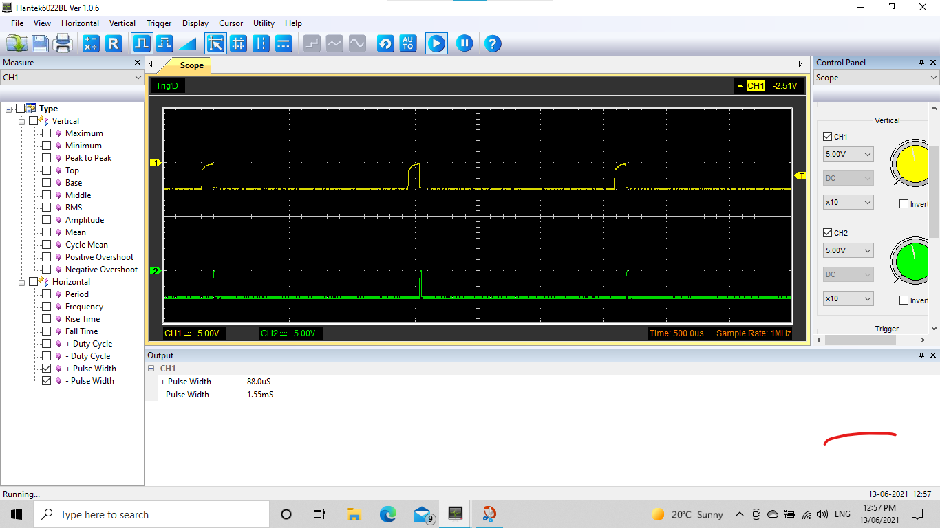

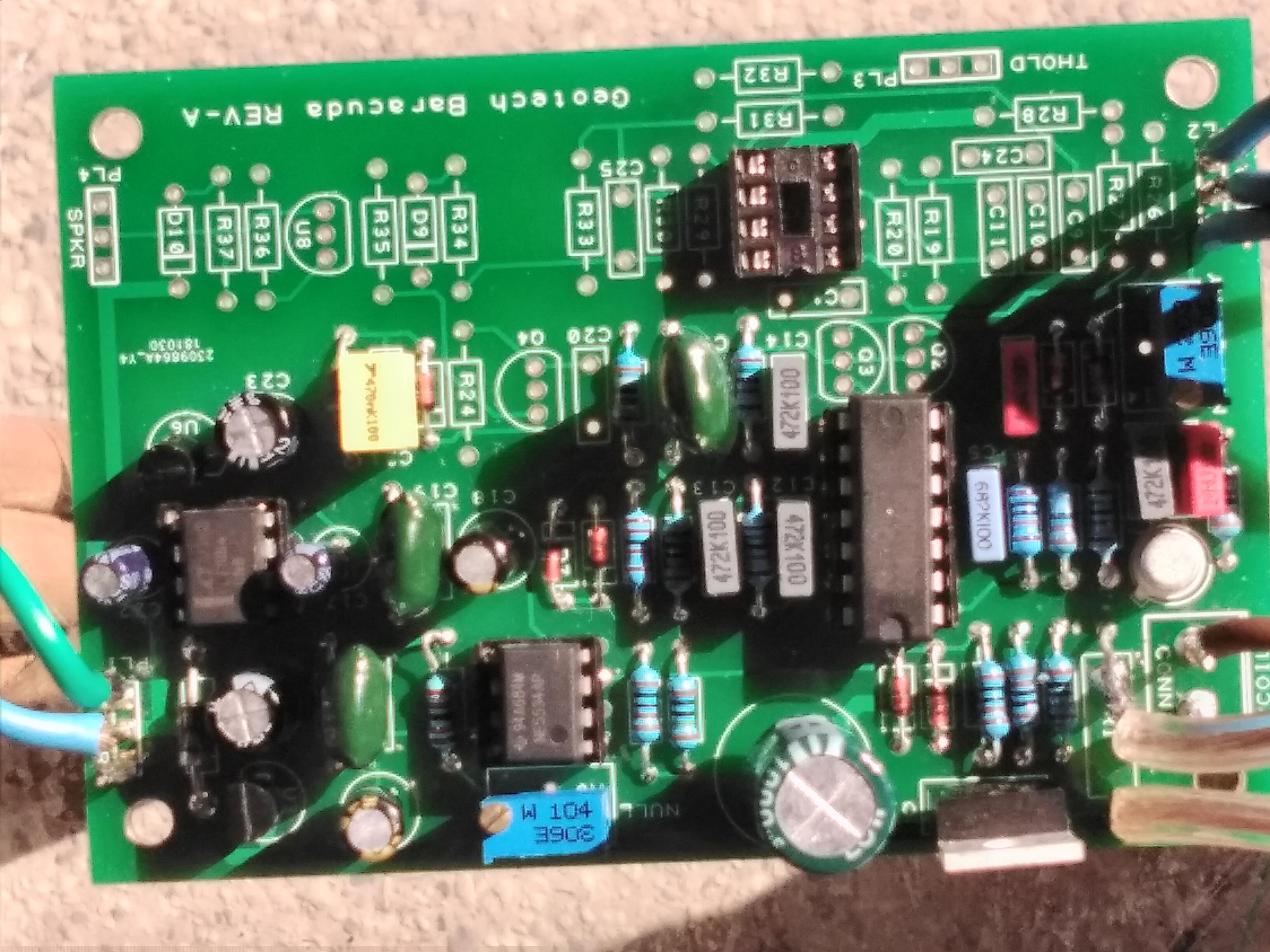

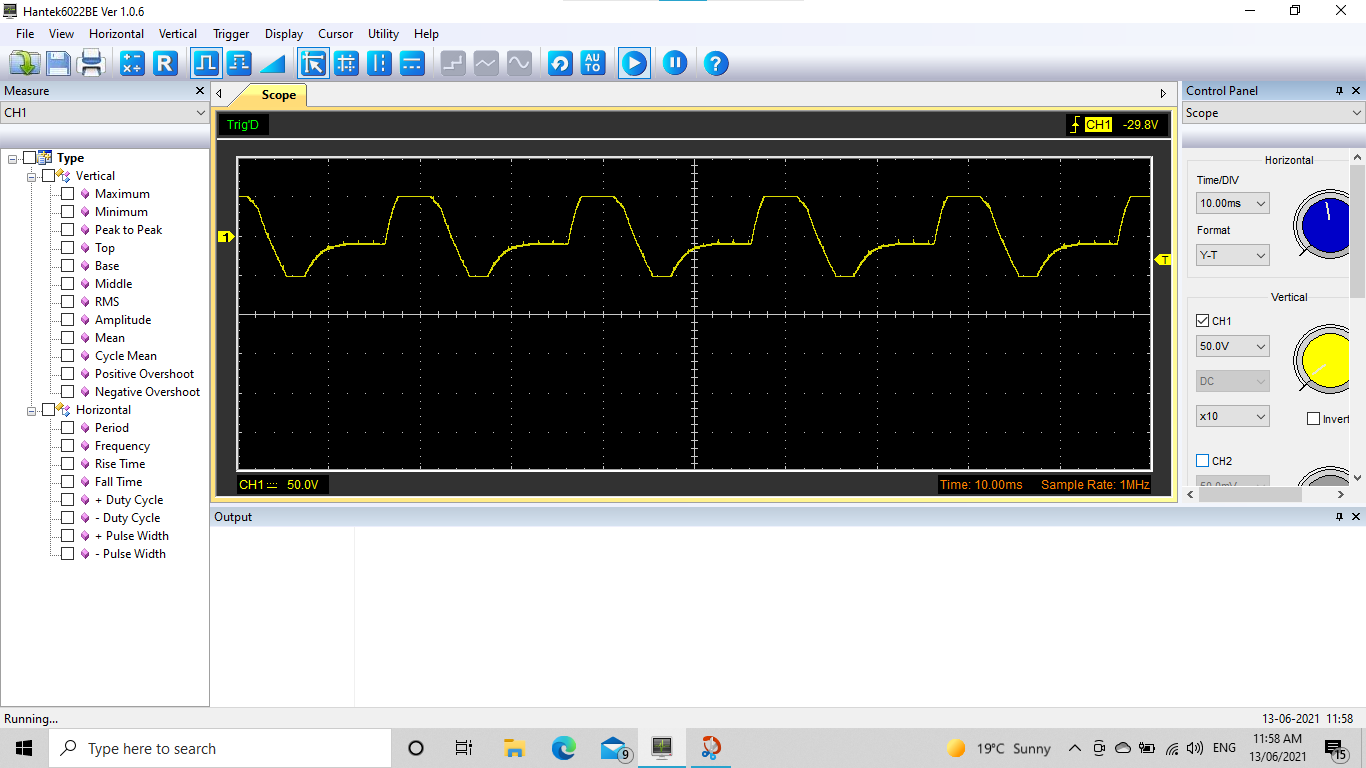

    Hi guys thought i would try build Baracuda rev A but i think something is wrong i have Populated Board to Step 5 Conclusive thought everything was oK till step 4 i am only getting around 51 Volts. Documentation 100V says this is the breakdown voltage of Q1 in the text
    Completed step 5 thinking this would help and got 0V in this step.
    Do You think Q1 is at fault or something else as i fear only half the voltage probably half the detection ability , so what are your thoughts as to where the fault could lie. Would appreciate some help as i am not so good at diagnosing faults. Graham
    hi do you measure the HV by o-scope? what control pulse width on the GATE pin is?

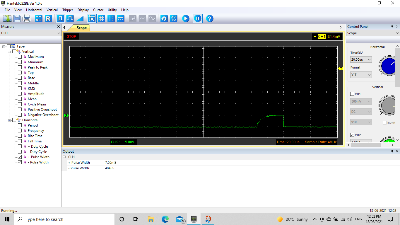

      Yes i measured the voltage with an oscilloscope today i will get some parts for step 6 and adjust r14 for 20uS but first i will get parts for step 6 from Jacar Electronics then i will go through step by step and try to discover lack of voltage fault will take some pics with a tablet and some screen shots as well and post them as soon as i can because i don't know whats causing this fault. appreciate any help but first will get pics and screen shots for you. Don't know what you mean by pulse width on GATE pin but will get TX pulse width, Main Sample and Secondary sample on U4 pins 4, 8,10 after i do step 6 will also show pic of oscilloscope voltage. have a good day all you guys . Graham

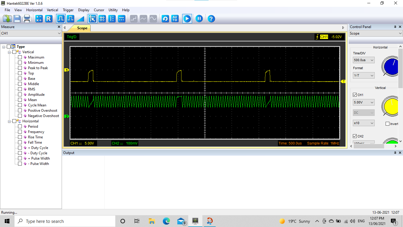

        step 1 to 3 Ok step 4 ennomely hound using the Hantek 6022 Be with 10 By probe i was getteing max11.3V , min -51.5V point to point 62.7V but when i tried a 100 by probe different results got 12.5V max -110V min point to point 122V can't understand why maybe the 6022be dosen't like high voltages with the 10 by probes. these were using 20Us 20V.
        Anyway step 5 adjusted to 0V with R6 . step 6i think was 500Us 5V.

        step 3 U4 pin 4
        step 3 u4 pin 4 and u5 pin 7
        step 6 u4 pin 6
