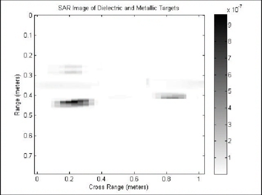

    About the effort, the goal was to provide a humble GPR prototype. It has a lot of limitations. Attached is a image of processed results. Not too much awe aspiring but this is the beginning. The darker set of pixels (best explanation I could make at the moment) indicates presence of a metallic object.

      As you must have perceived, I don't need a very sophisticated system to get these results. I just need a system which rules out the use of VNA in already-made system i.e., a transceiver which calculates s11.
        How about I move towards FMCW transceivers in millimeter range? Will it simplify my design?
