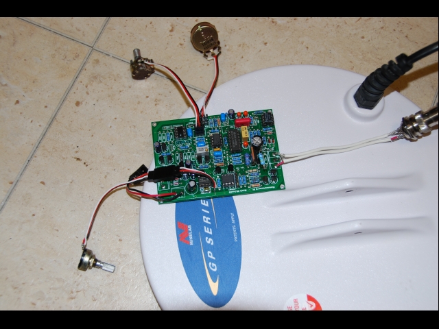

          Finally had some time to get the HH2 going. Still have some tweaking to do. Did not complete the audio section, wanted to get the front end going first. I was lucky and found a 11in GP4500 DD coil on ebay, this will be my standard. Later I will wind my own coil. I didn't have a PIC12f683, so I used a PIC12F675. Its ok, but the internal oscillator only goes to 4mhz vs the 12F683's 8mhz. I going to order some PIC12F683's. Its on hold until after the holidays, hope some others report in soon.

              I got to play with the HH2 again. The fet driver and the dual preamp design, really speeds things up. Kudos to Carl! I am sampling around 10uS, using a homemade 8in mono coil (220uh/1,4ohm). This same coil on a PI with a single 1000X preamp gain has to be sampled at around 20uS. So there seems to be real improvement! It can pick up a nickel at about 11in. Not a peep out of a small nugget(match head size). Still more work to do.
              I was able to get about the same results with an 11in ML DD coil.
              Someone asked me which part I was using for the preamp(IC6). I tried the MAX412 and the NE5532. Both work well, based on observing the output on the o-scope. The MAX412 seemed slightly faster. For those of you who don't want to pay $9 for the MAX412, the NE5532 at under $1 will be fine. You can always upgrade later.
              Mark
