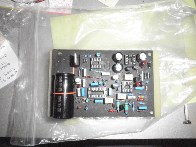

                      Have now built a Barracuda with just front and rear panels and everything exposed for this very purpose which is on a workshop bench of its own so when time permits can easily revert to it between doing my repairs etc.
                      Very confident with a positive attitude that if we give the Barracuda a good working ground balance together with a build of precision components and coil build we will be rubbing shoulders with the likes of Mine lab owners.

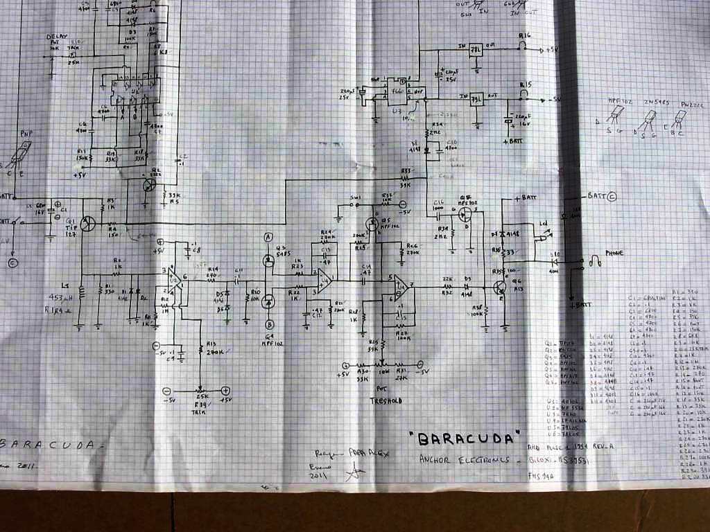

                      My Question to you all is... In your opinions, is it Doable?, If so lets not talk about it, lets get started, First of all can you kind people give me some leads and directions to work with because I for one want to focus and move on with it, I am not as advanced technical wise with metal detector designs as allot of you on here, being a TV engineer by trade but my practical skills are second to none and once I feel the hunger for something like ground balance been integrated into the Barracuda , It needs to be accomplished.
                      Here is the working circuit diagram and parts list together with one of my builds to save you looking for it
