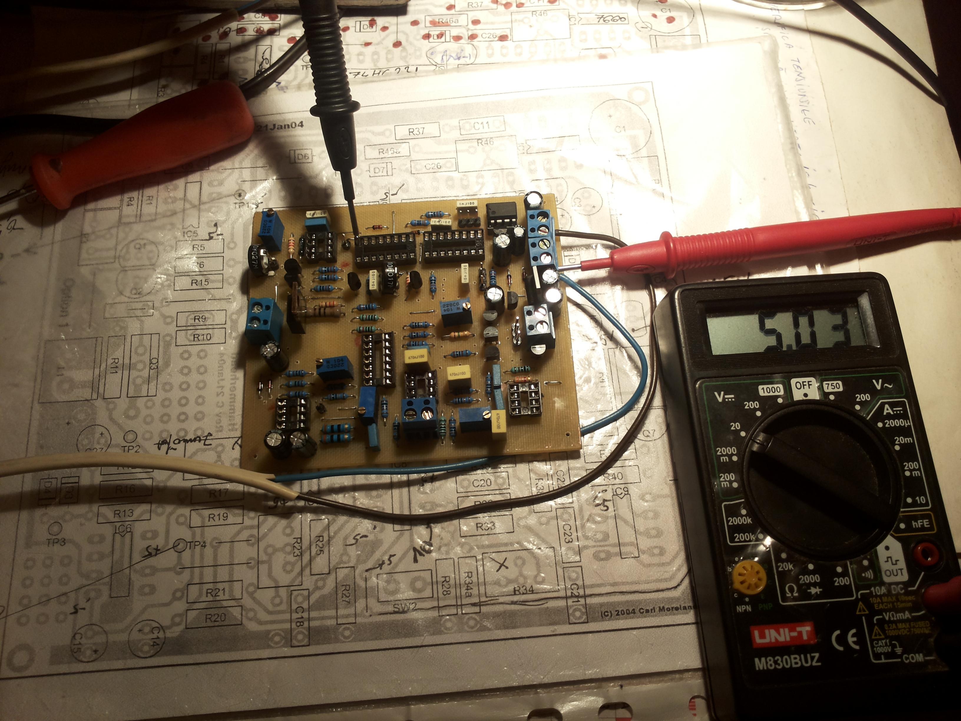

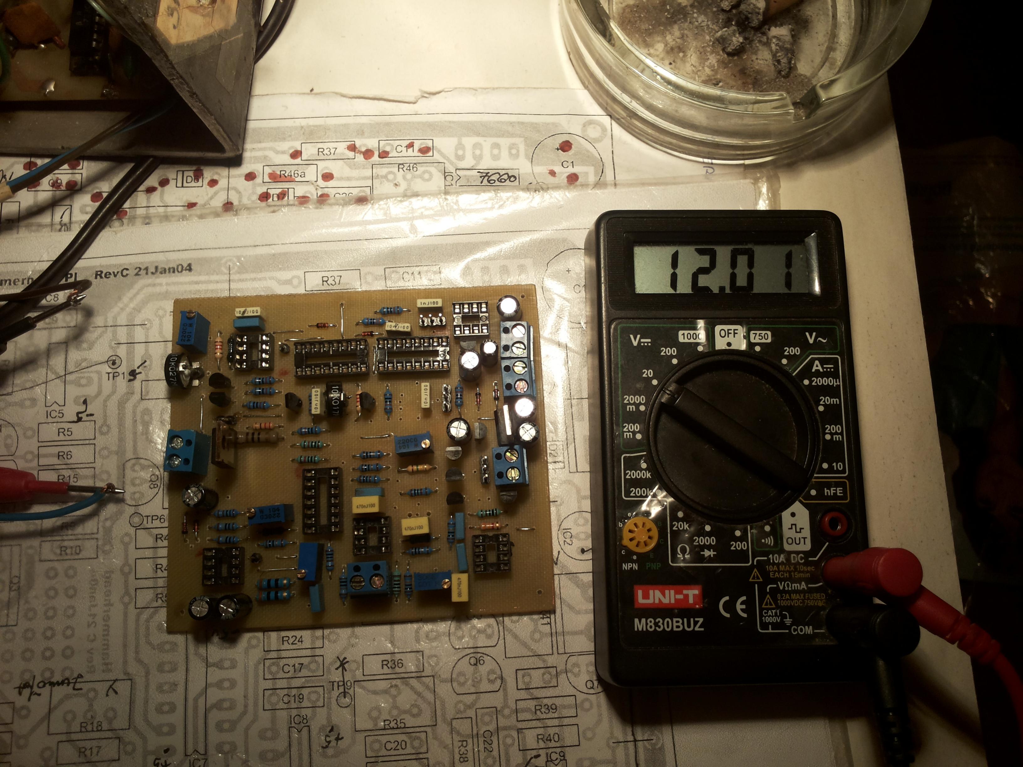

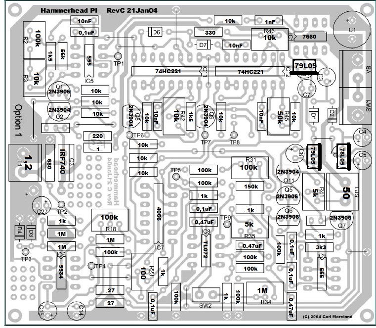

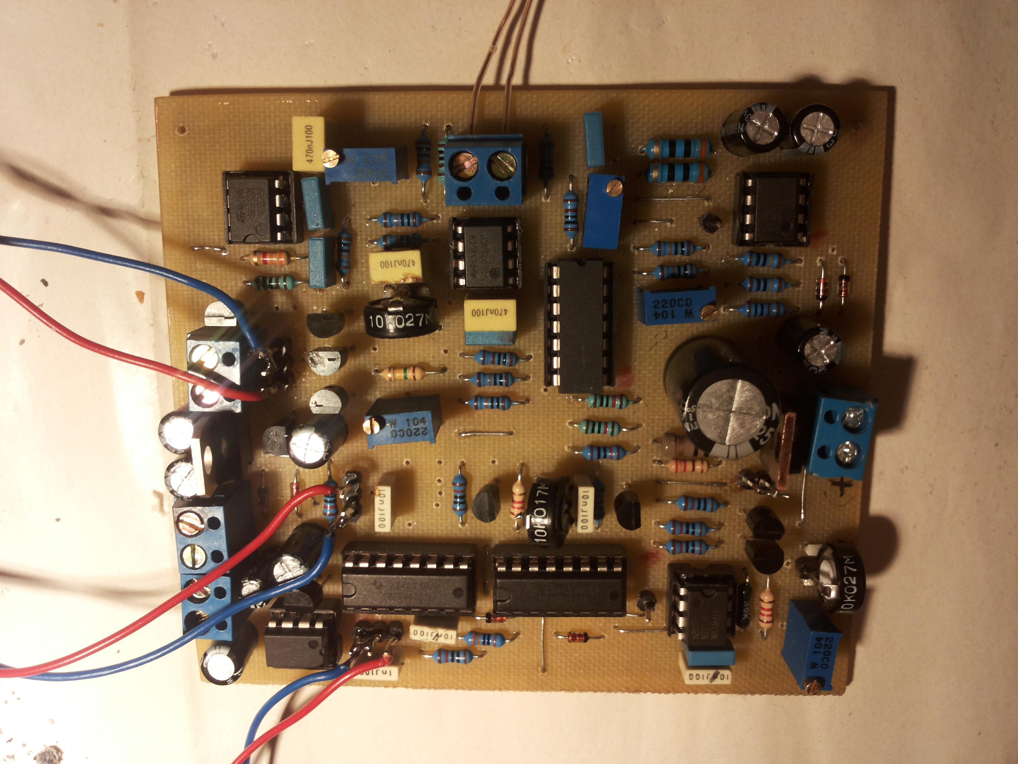

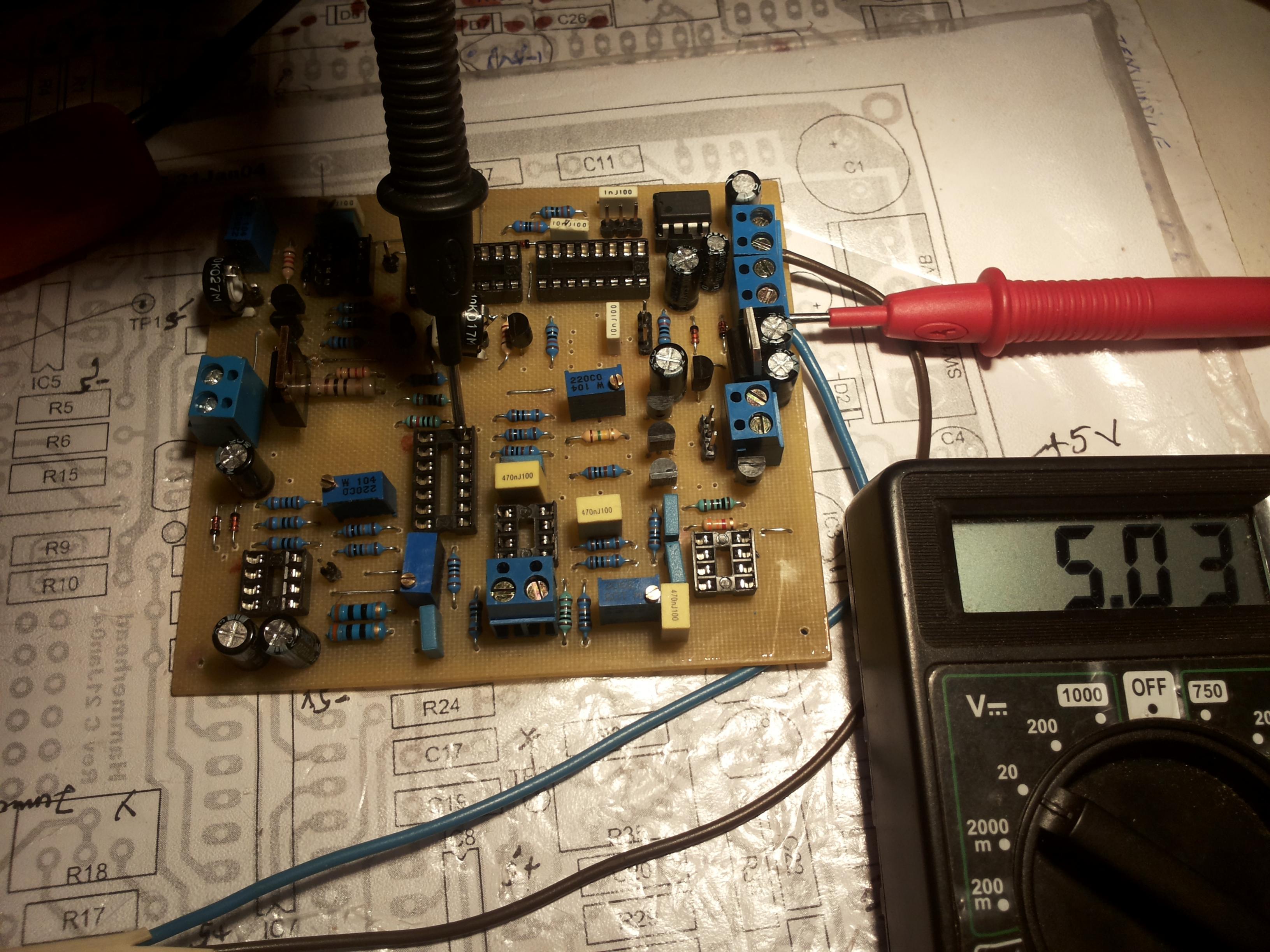

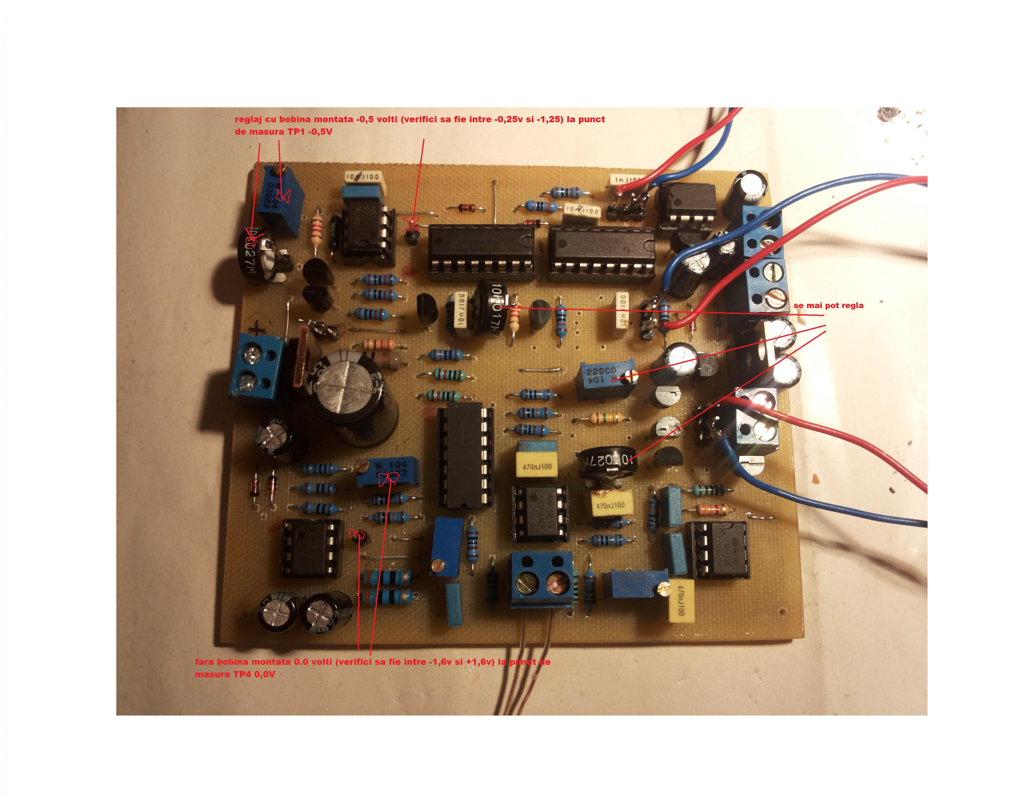

Sorry I forgot to post, Hammerhead PI is a very good detector, thanks to Carl Moereland, watch these videos ( https://www.youtube.com/watch?v=DspTBNjoGTs https://www.youtube.com/watch?v=pkZwPIOrzZM https://www.youtube.com/watch?v=aTNxzdbQ1n8 )and important two points (TP 1 and TP 4)pictures tutorial measurement point able to be adjusted and then it will work very well, It is up to you, sorry for my English, all the best
Hammerhead PI test

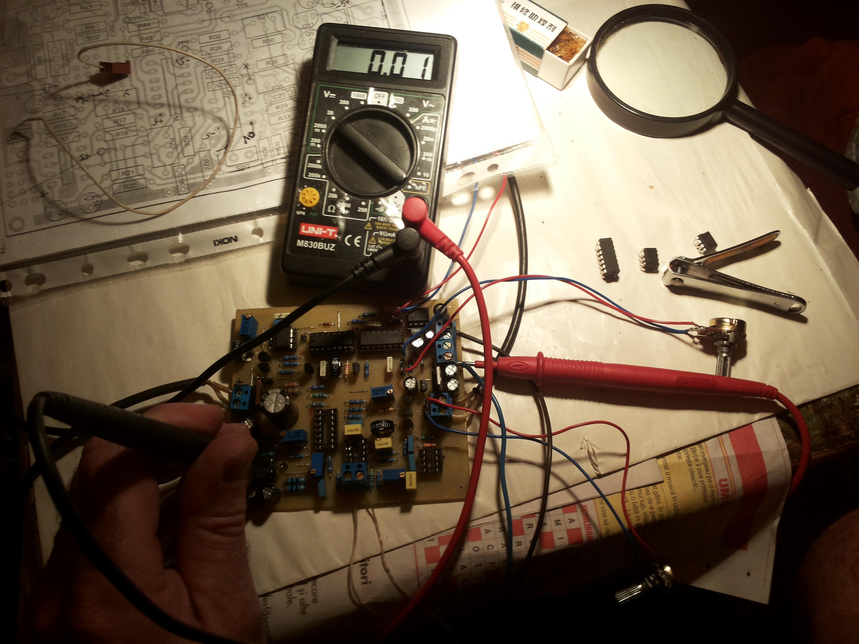

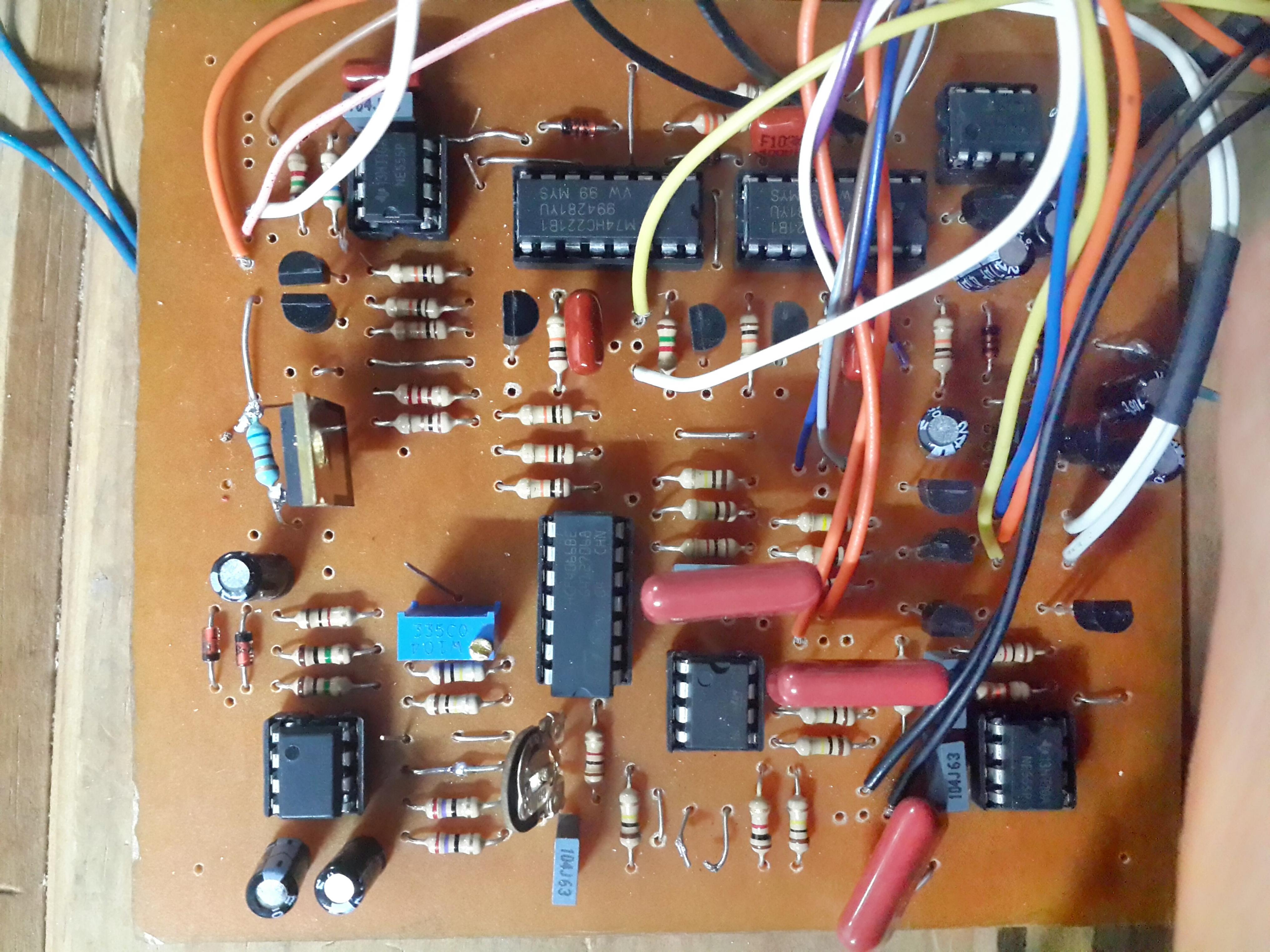

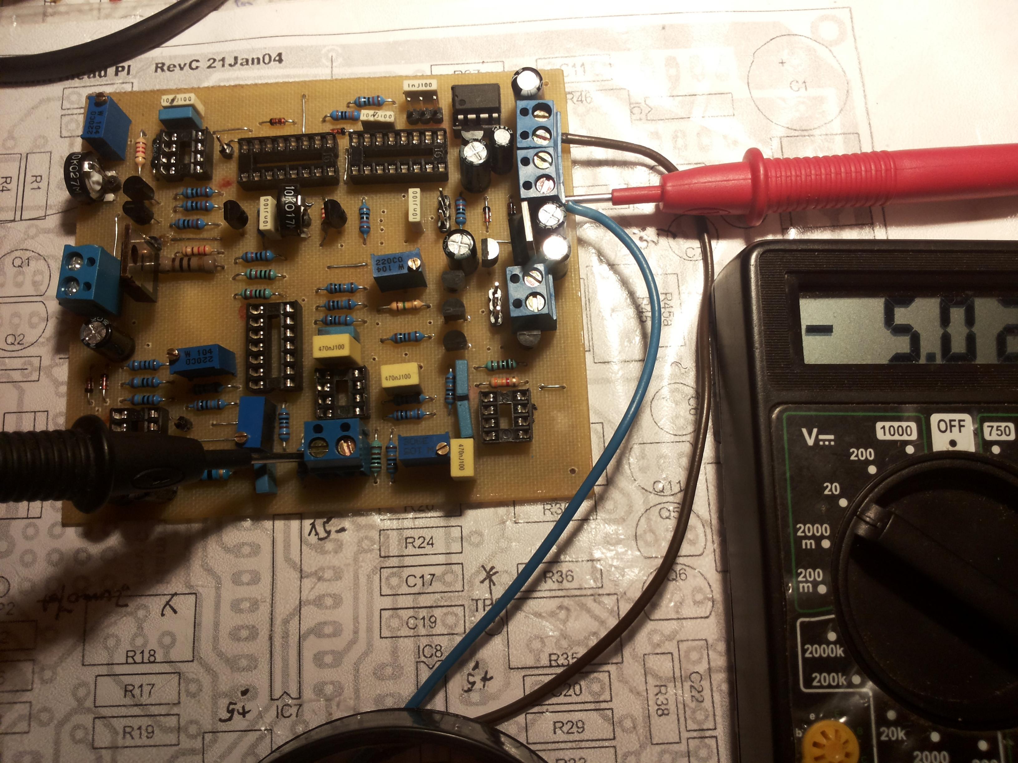

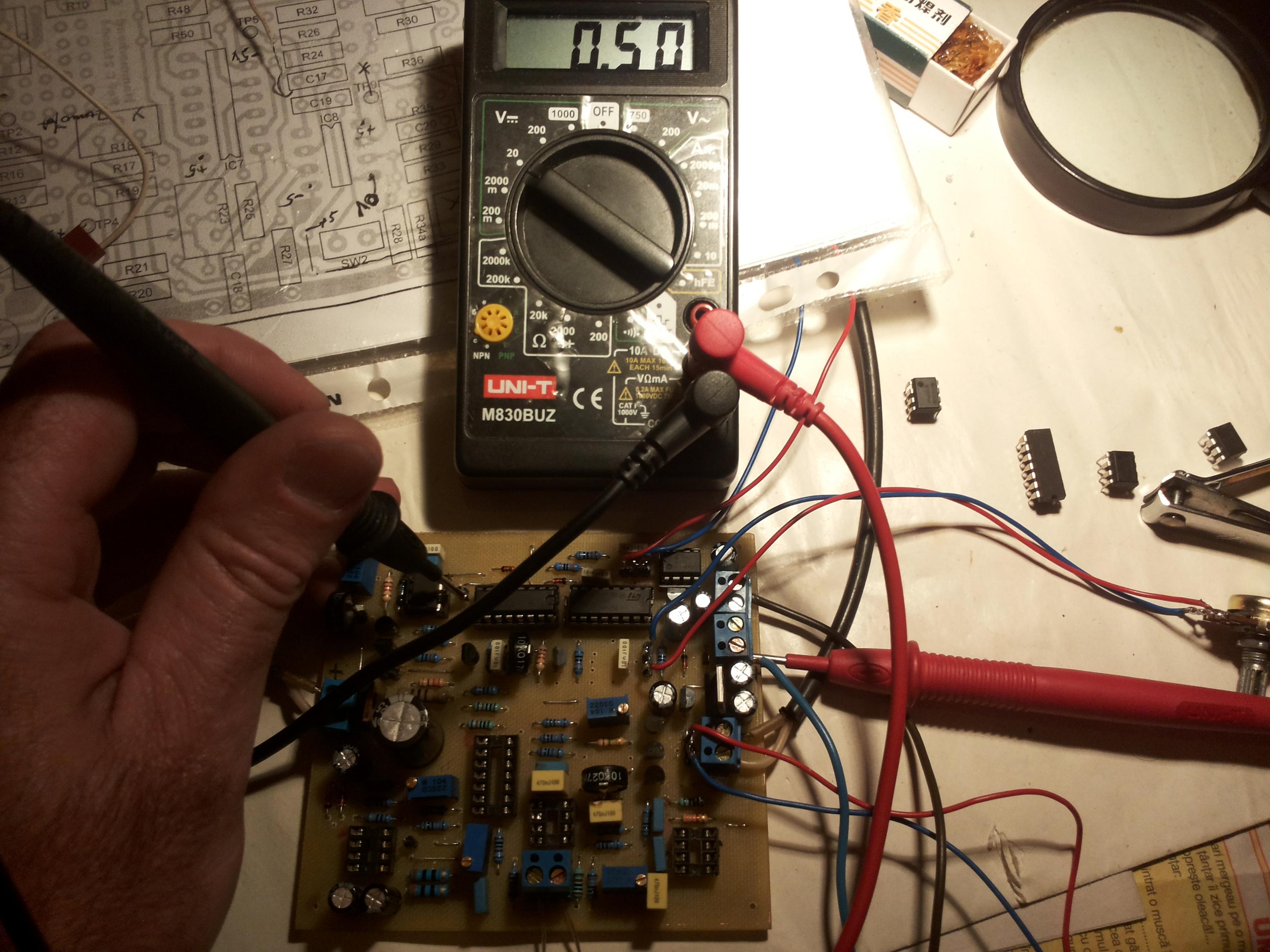

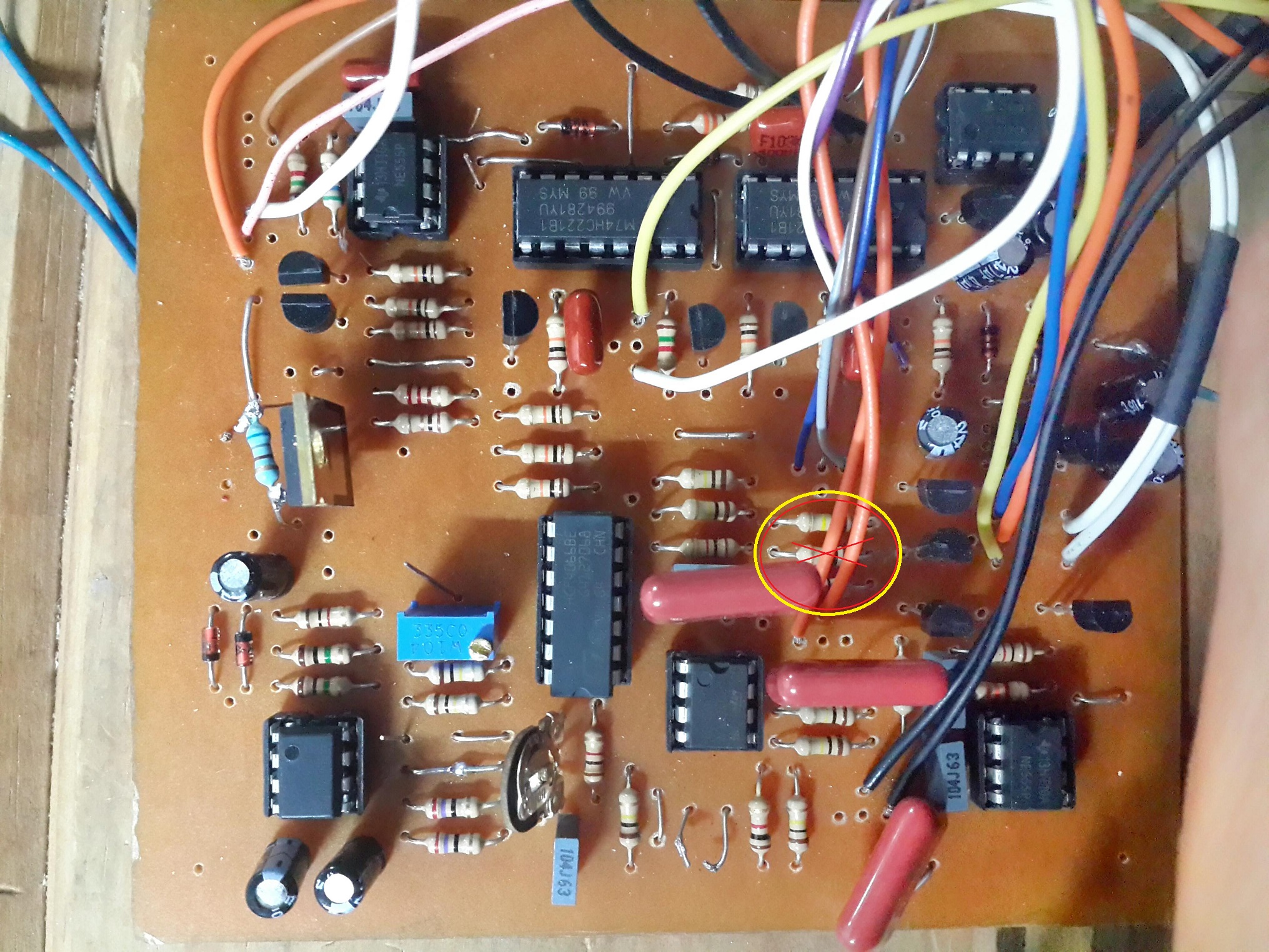

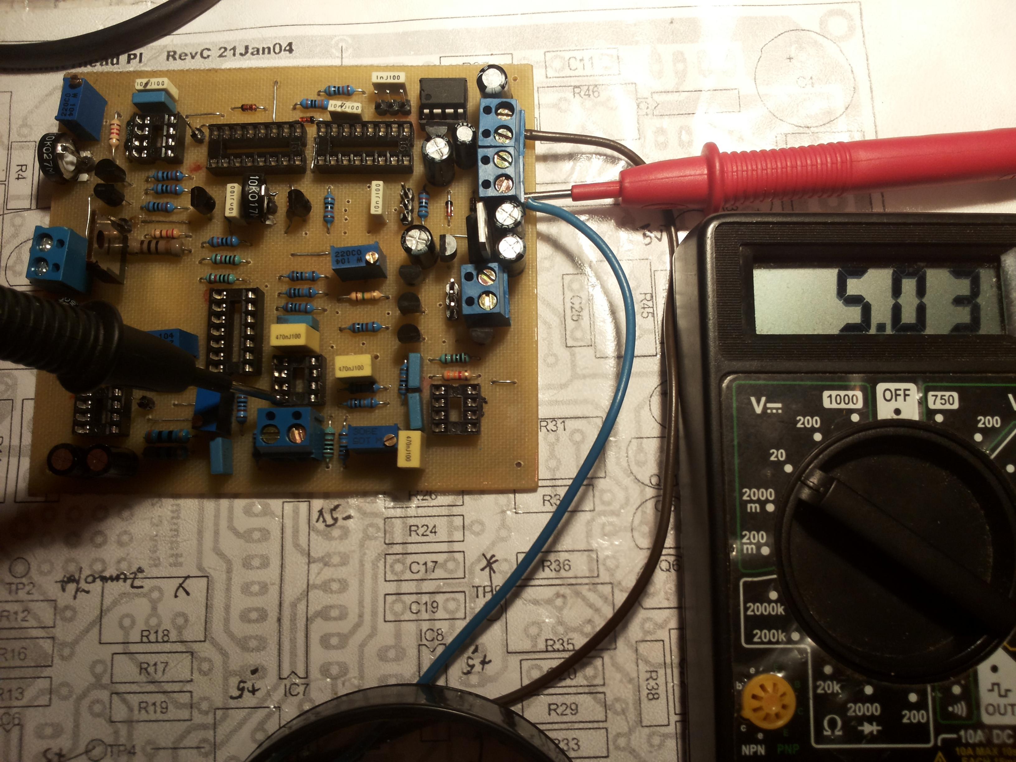

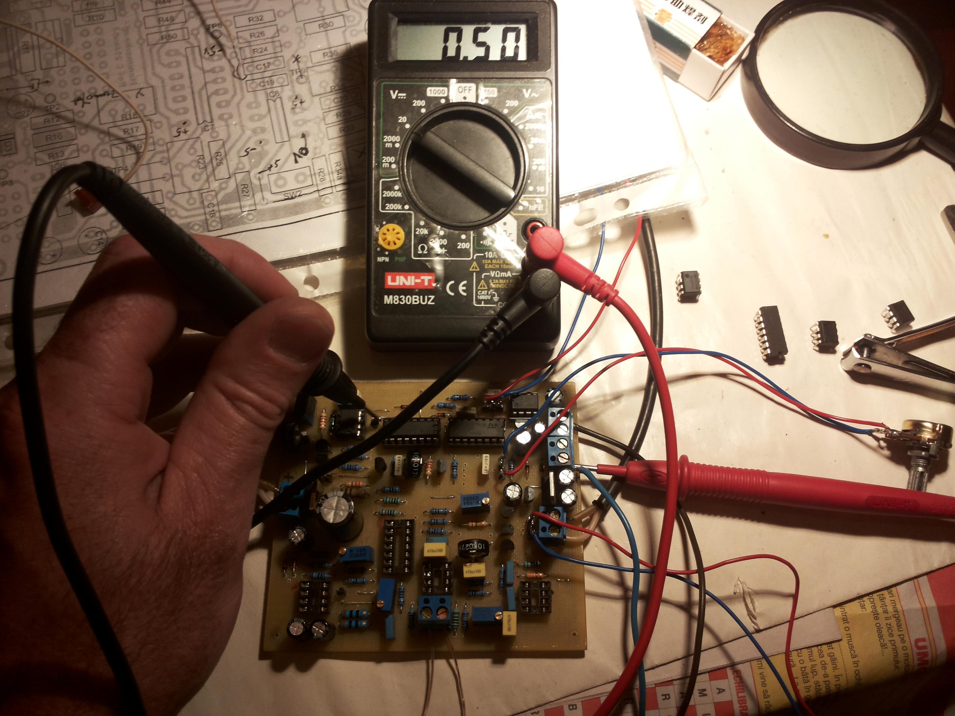

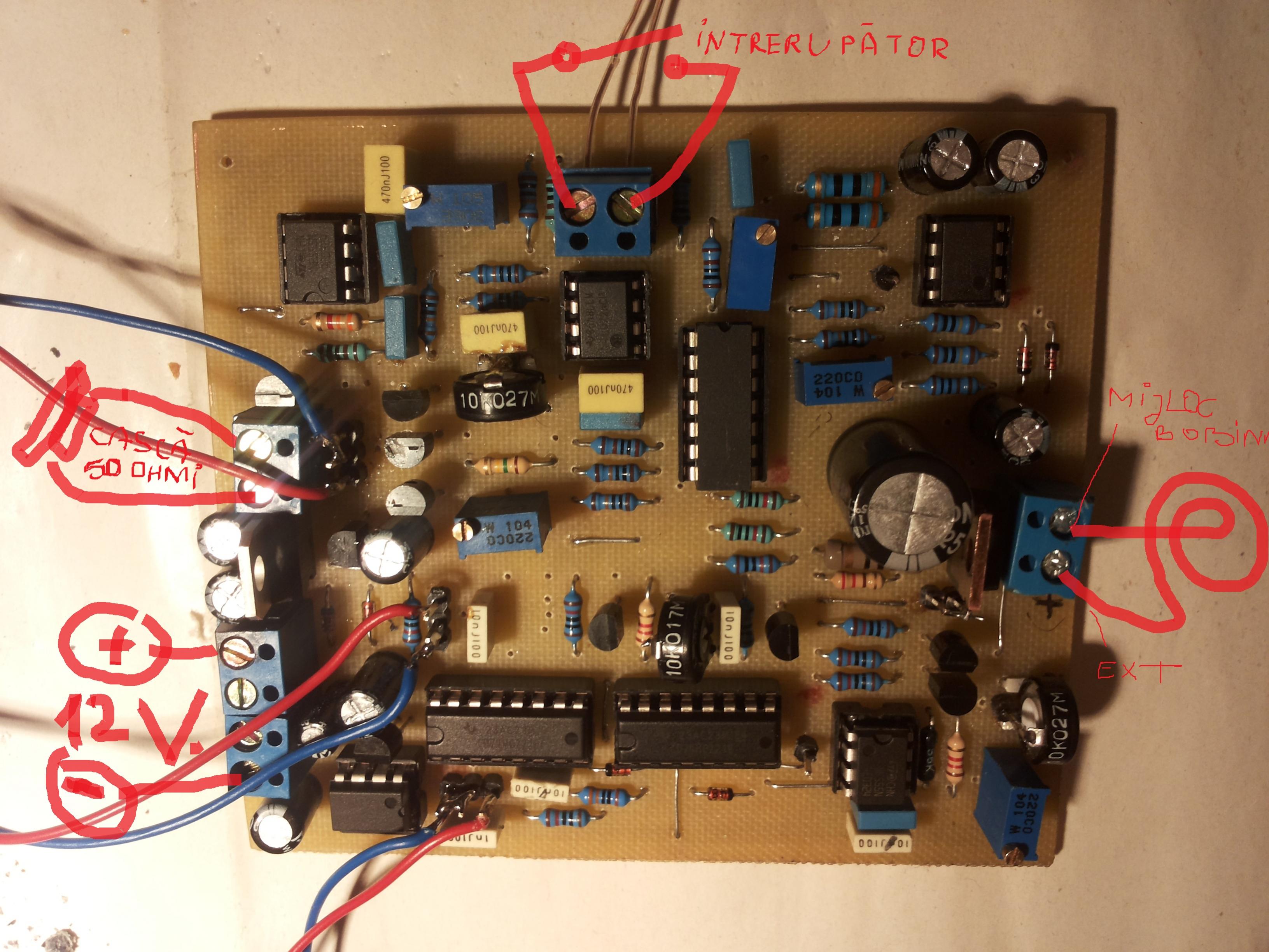

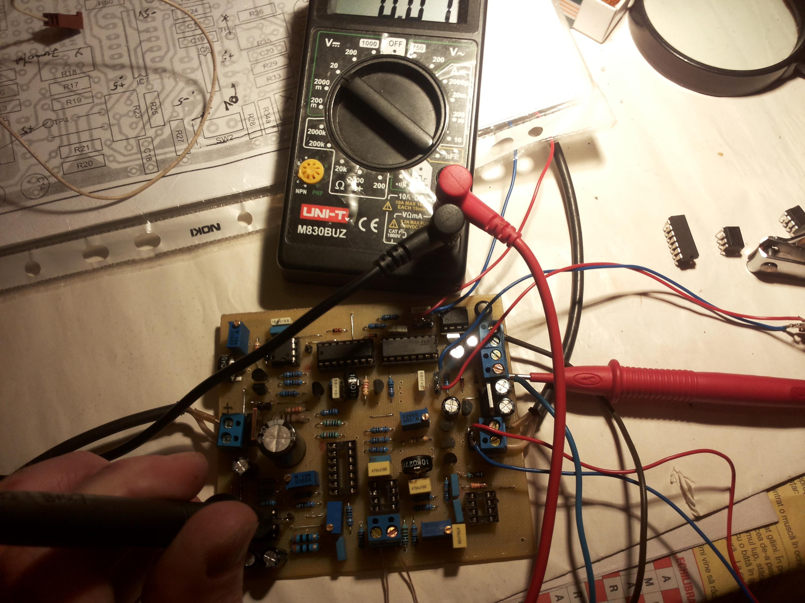

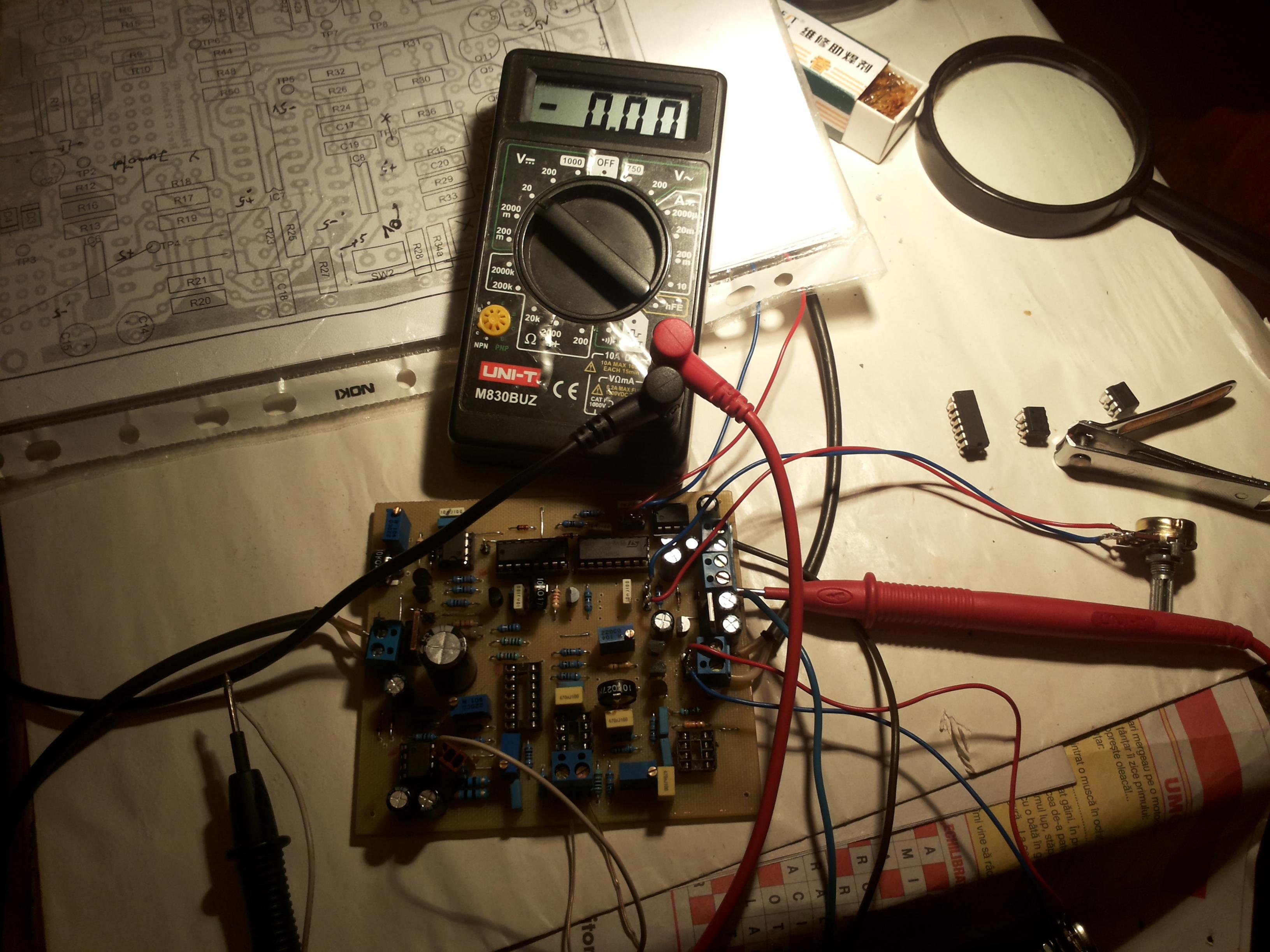

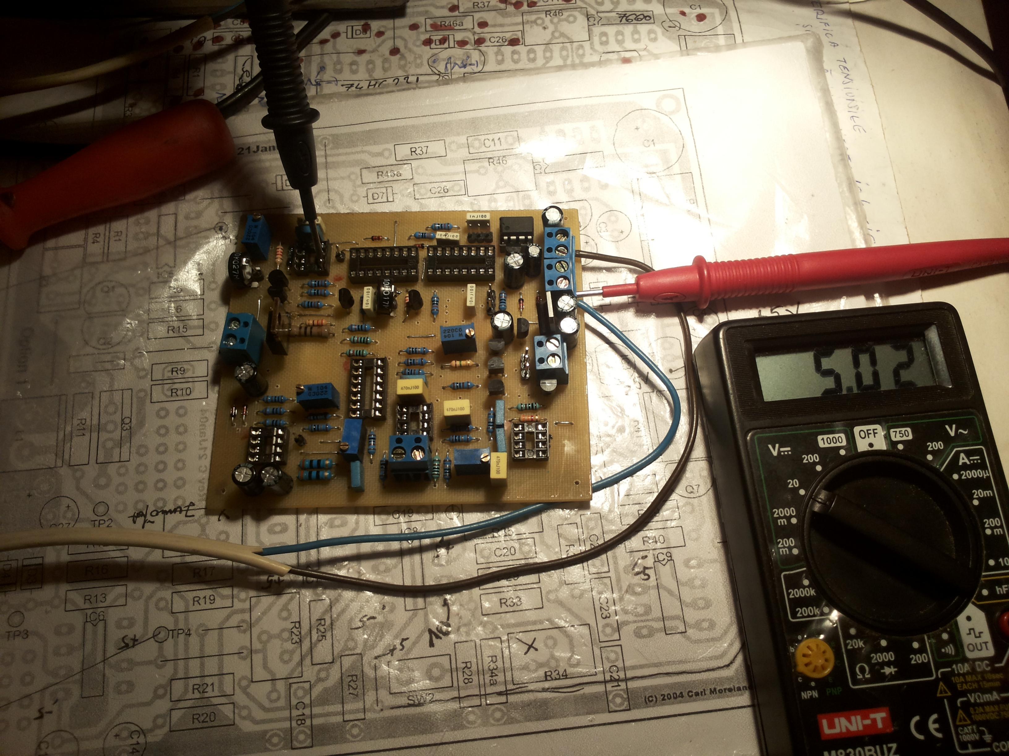

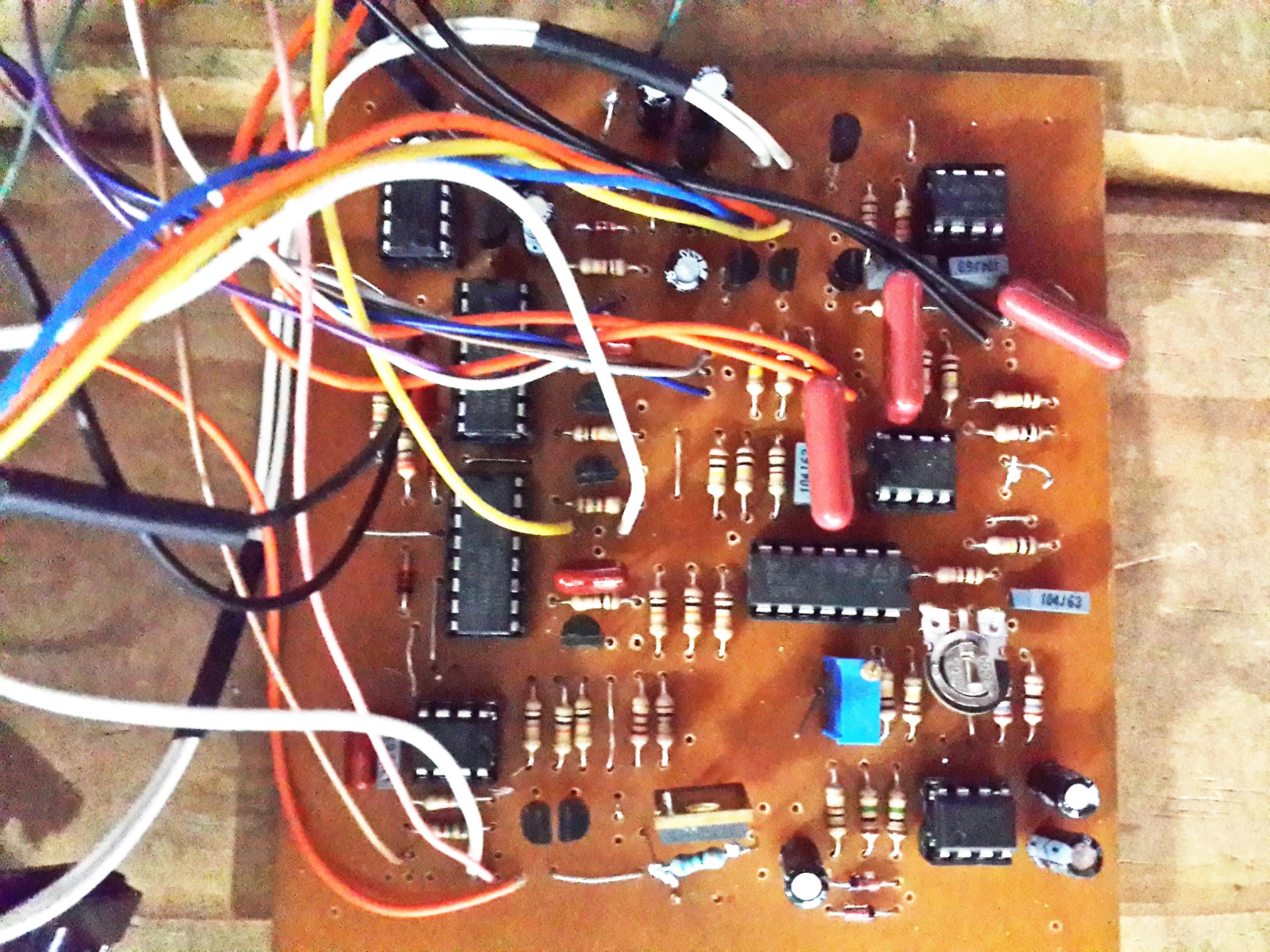

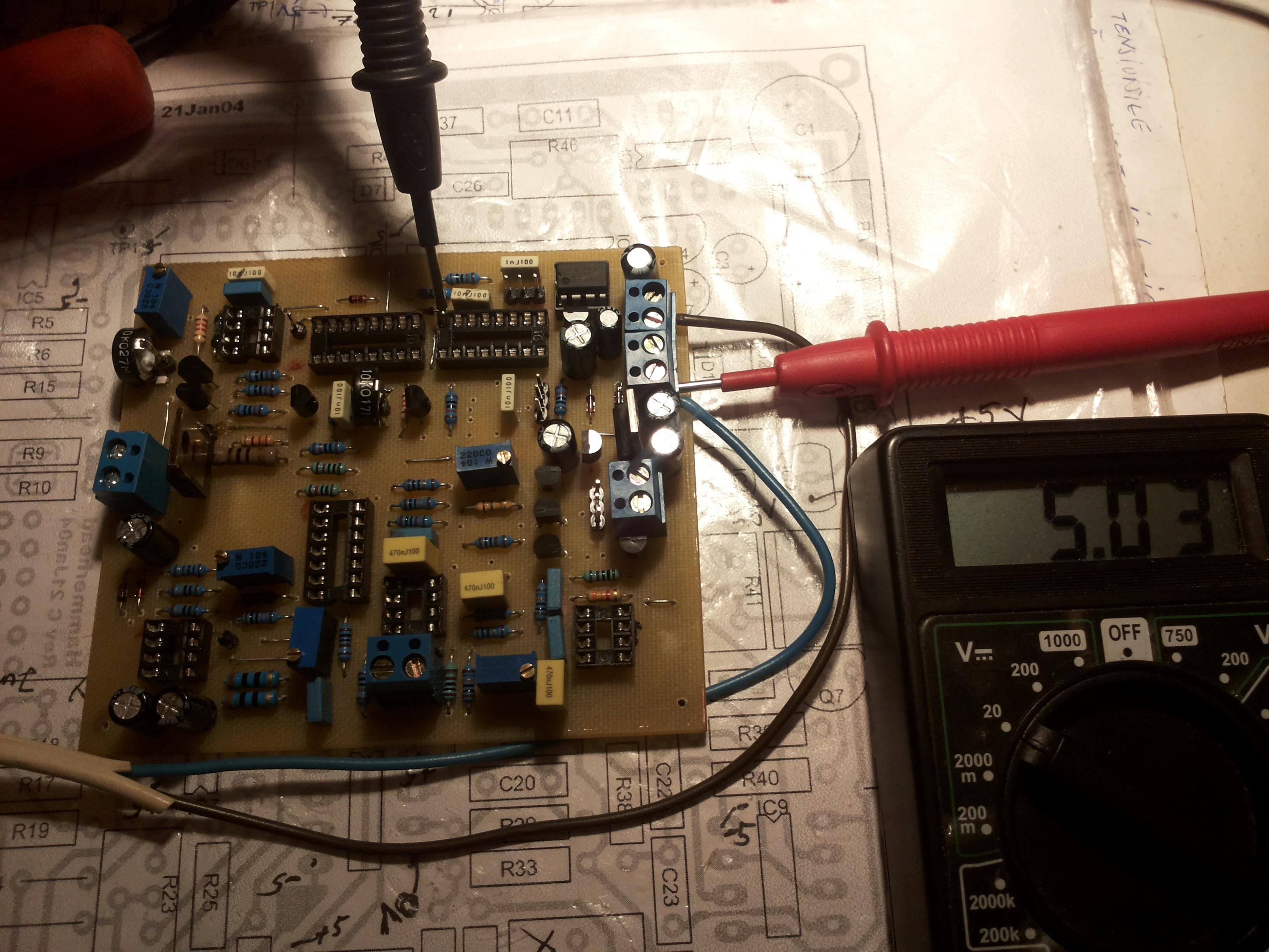

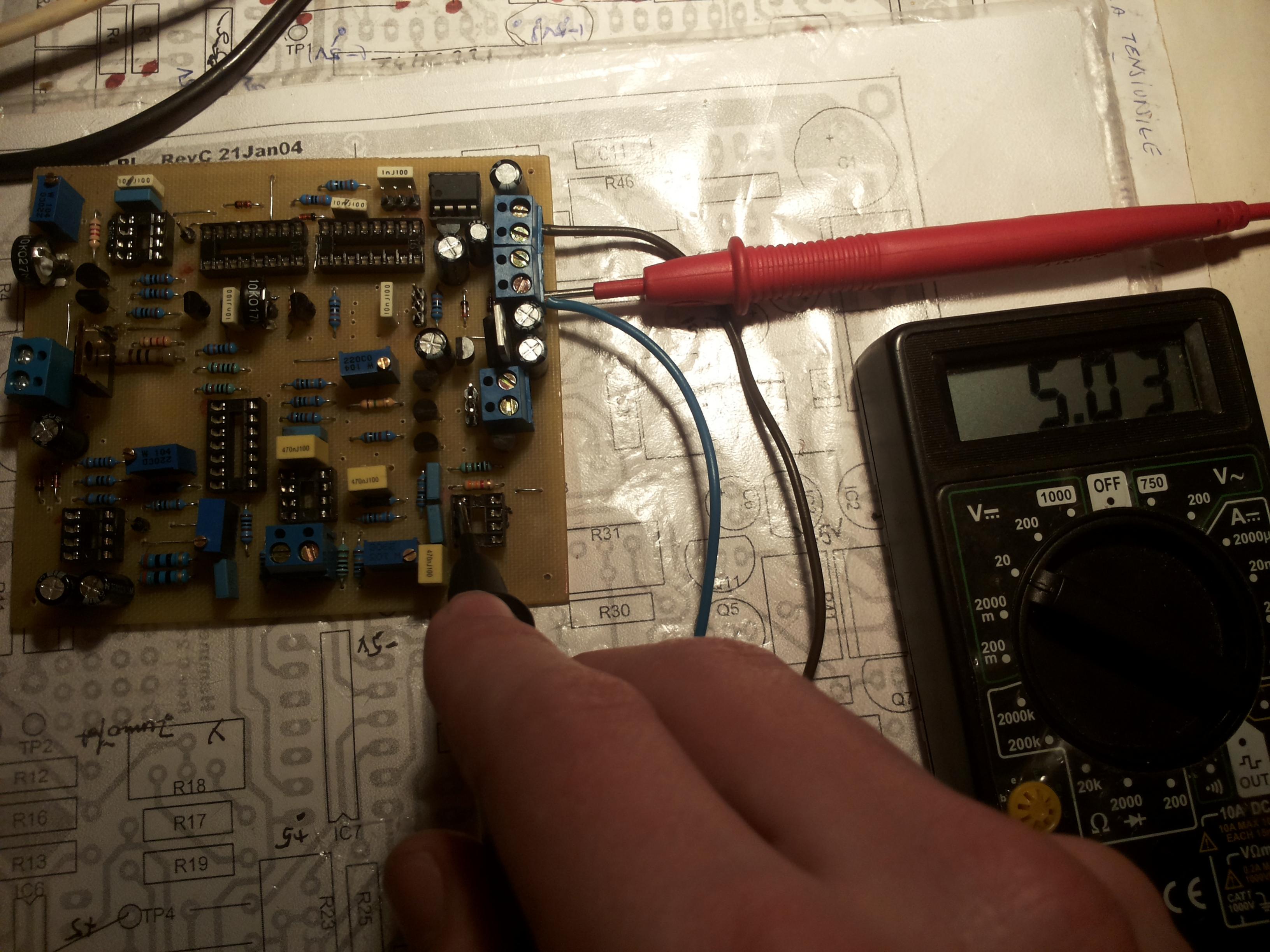

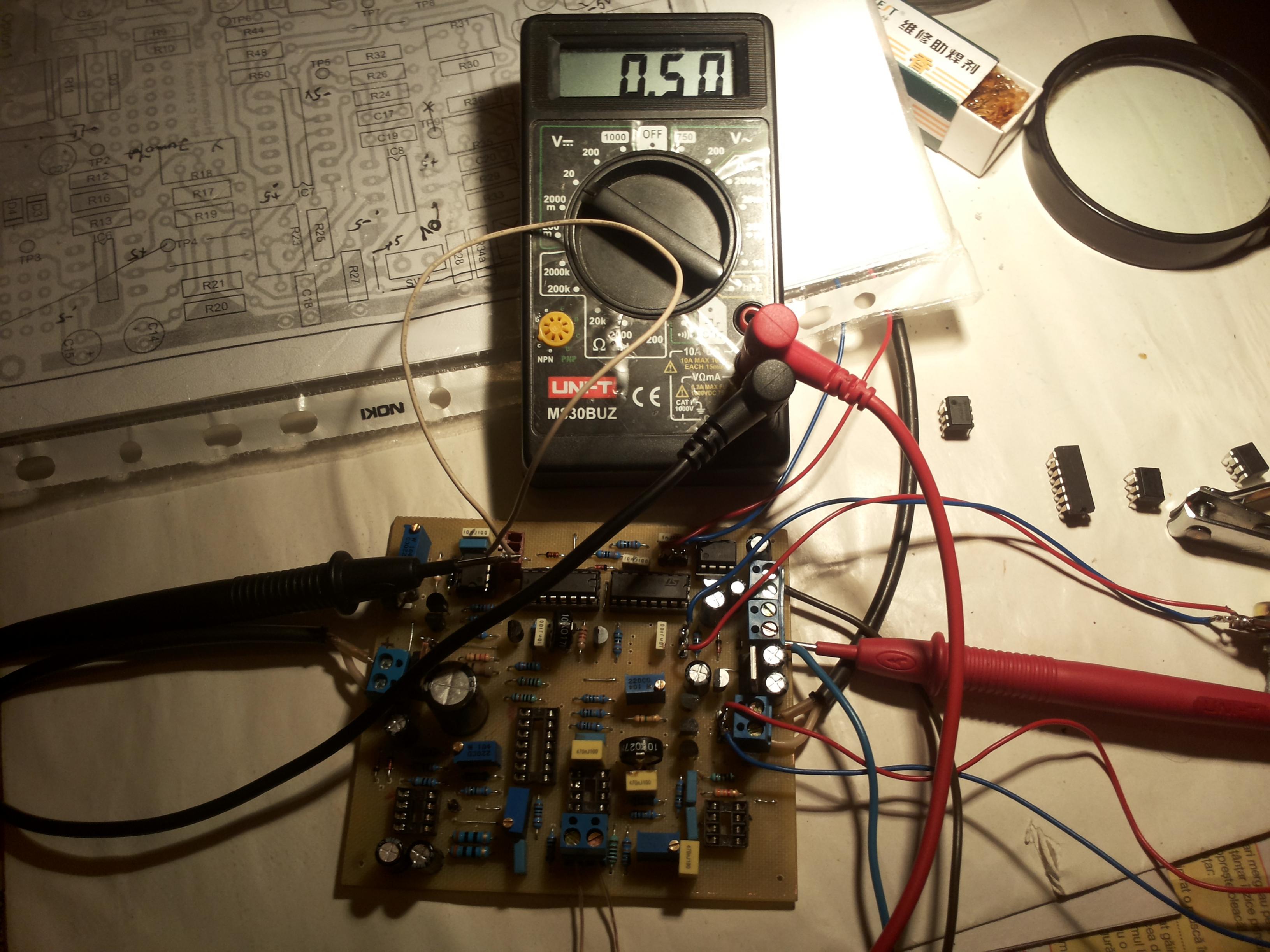

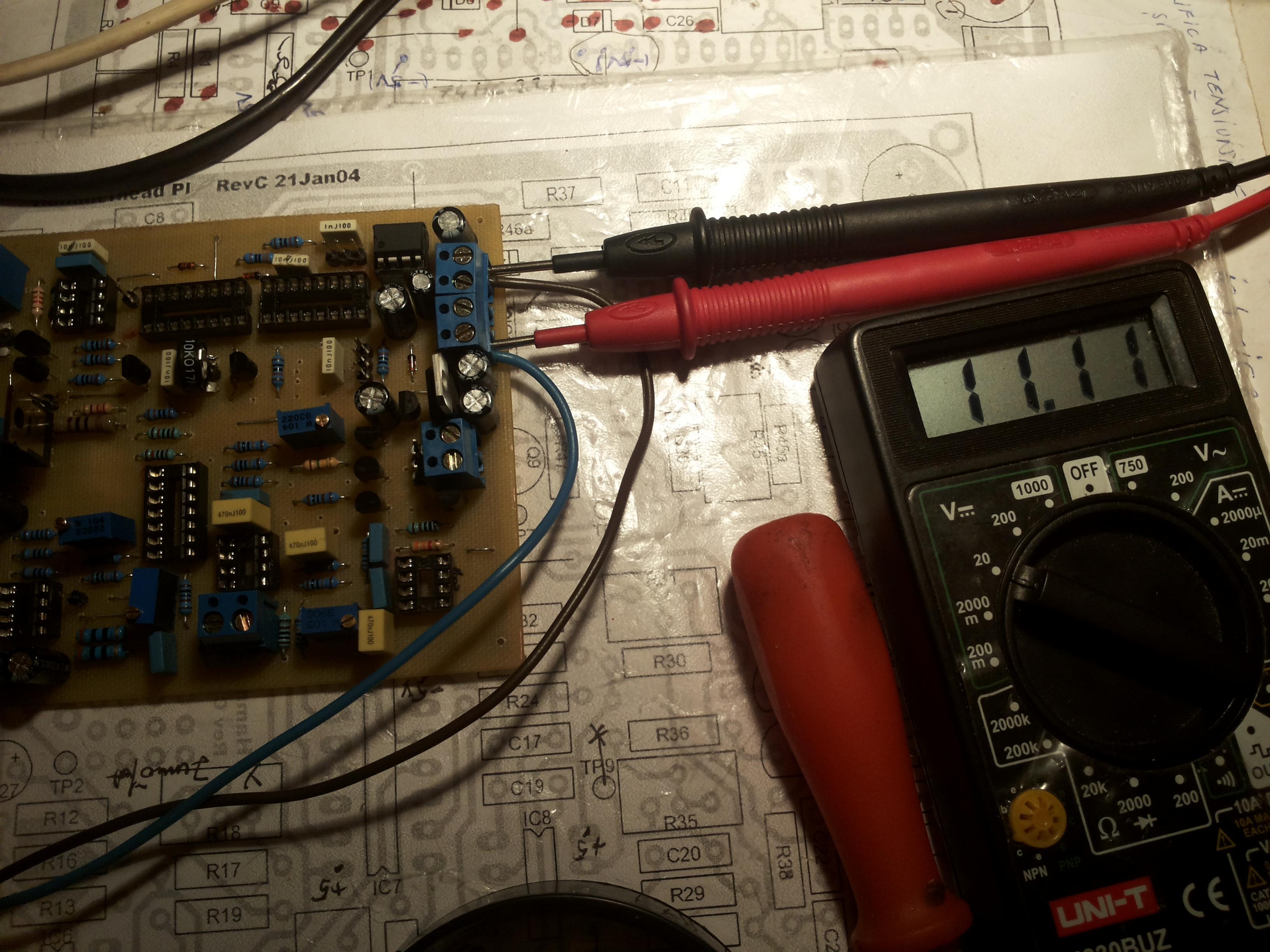

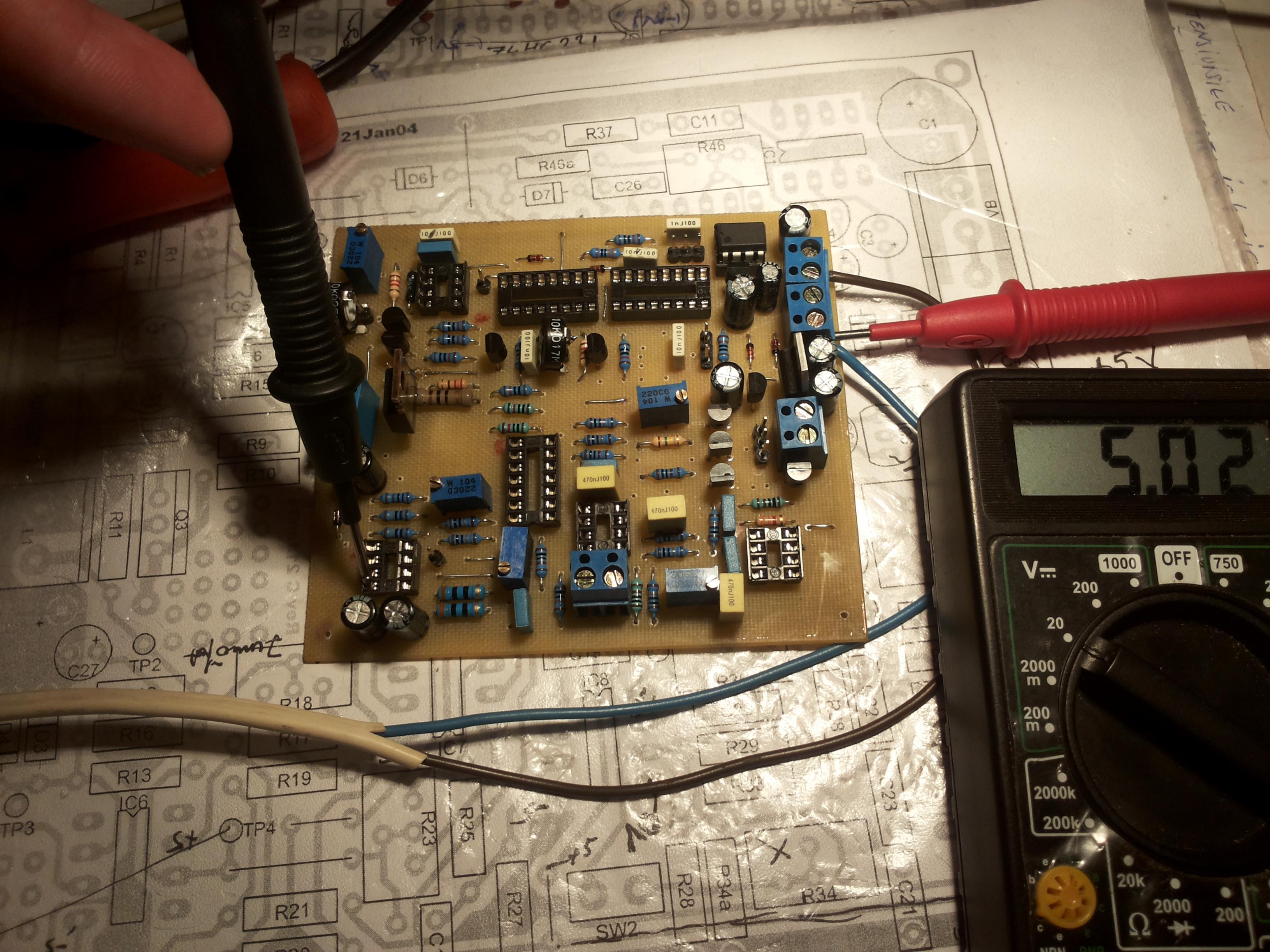

Thank you very much friend. Regarding the forums. I think there should be much information, but I do not understand English. Now I'm using google traslate. I think I'm using some wrong component. What little I've seen, many people change the values of the resistors. I like to see how yours stay. Will you have the final eschema, with all the components you used? I'm lost. I really like this project. But if I'm not English dead! Please. Could you pass me the details of the circuit? Basically my circuit detects fine but after one minute it becomes unstable. Maybe if I see your scheme will solve it. Since you and I am very grateful. I hope you understand that I write, if we take the blame on google! Ha ha ha
Hello friend. Here we got the video, showing the fault. R3 and R42 are half. R46 is I move to stabilize again. You can see, after a few seconds it becomes unstable.
