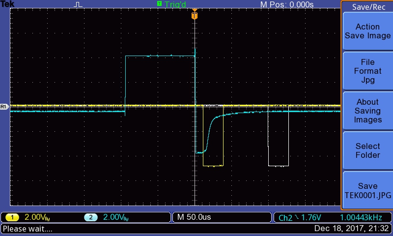

          Here it is Blue is the decay, yellow is primary delay. i couldnt get it to 8us but i got it to around 11us or 12us its probably because the limiting resistor in series with the trimpot. will have to change it later.
          Finally the white is the secondary delay (100us delay).Click image for larger version
            With the Decay out at about 20usec I would move the Delay for the first sample out to about 20usec.
            With the scope running as in your picture try moving metal near to the coil. You'll see that the rising edge of the decay (blue trace) does not move much but as it get above -2V you'll see movement on the trace. Put the First sample there.
            Also note how much the trace in moving where the second sample is being taken. If trace moving then move second sample out a bit more.

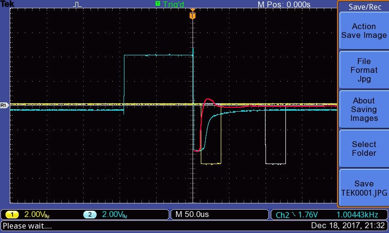

              If it was me, I'd be leaving the timings where they are and just changing the damping resistor.
              IMHO the curve looks overdamped. As you move towards a more underdamped state the decay becomes quicker as seen in the image of the other link I posted earlier. For a more underdamped state of the one we have here, I suspect it would look like this: (with the hand drawn red line)
