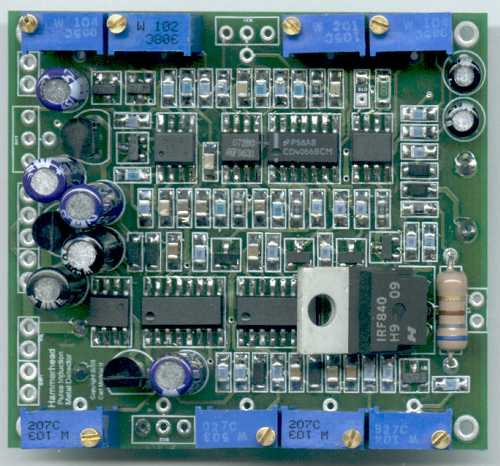

    ...but our fine local post office forgot to put a package notice in my box. I finally asked them to "look around" for it, and they found it.
    SMD parts are down, I'll wrap it up over the next few days and give it a go.

      Alluvasudden, those trimmer pots look huge...
      I'm only bring the threshold, pulse delay, and volume out to panel pots. Plus a switch for auto-retune.

          Re: SMD mistake!!
          Hi Carl i saw a mistake on your smd board.you have forget the conection of pin3 of 555(IC5)to pin2 of HC221(IC11).check it please. THANKS MASOUD.
            Re: SMD mistake!!
            THANKS MASOUD.
            Good eyes!!! Yes, I did forget that connection. Amazingly, that was the only problem. I've built the SMD board, added that jumper, and everything works fine.
