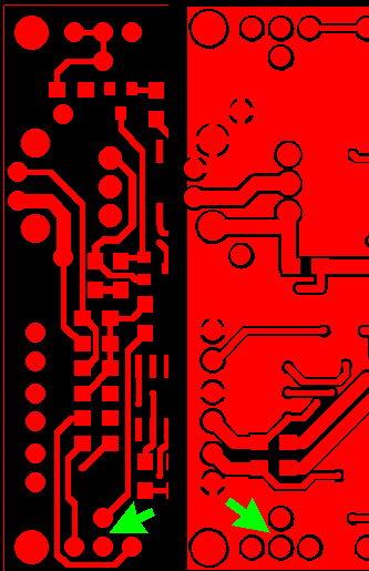

to Carl. small bug of HH-SMT pcb
  • to Carl. small bug of HH-SMT pcb
    hello all and Carl, I found of a track to R18 is absent. then I did open gerber files and there is not the track too. it does not give to set the offset to zero level of op amp.
    yours
    Re: to Carl. small bug of HH-SMT pcb
    You are correct, the two middle pads of the pot should be shorted. I was using a pot with a staggered middle pin, so I missed this. Sorry.
    - Carl
