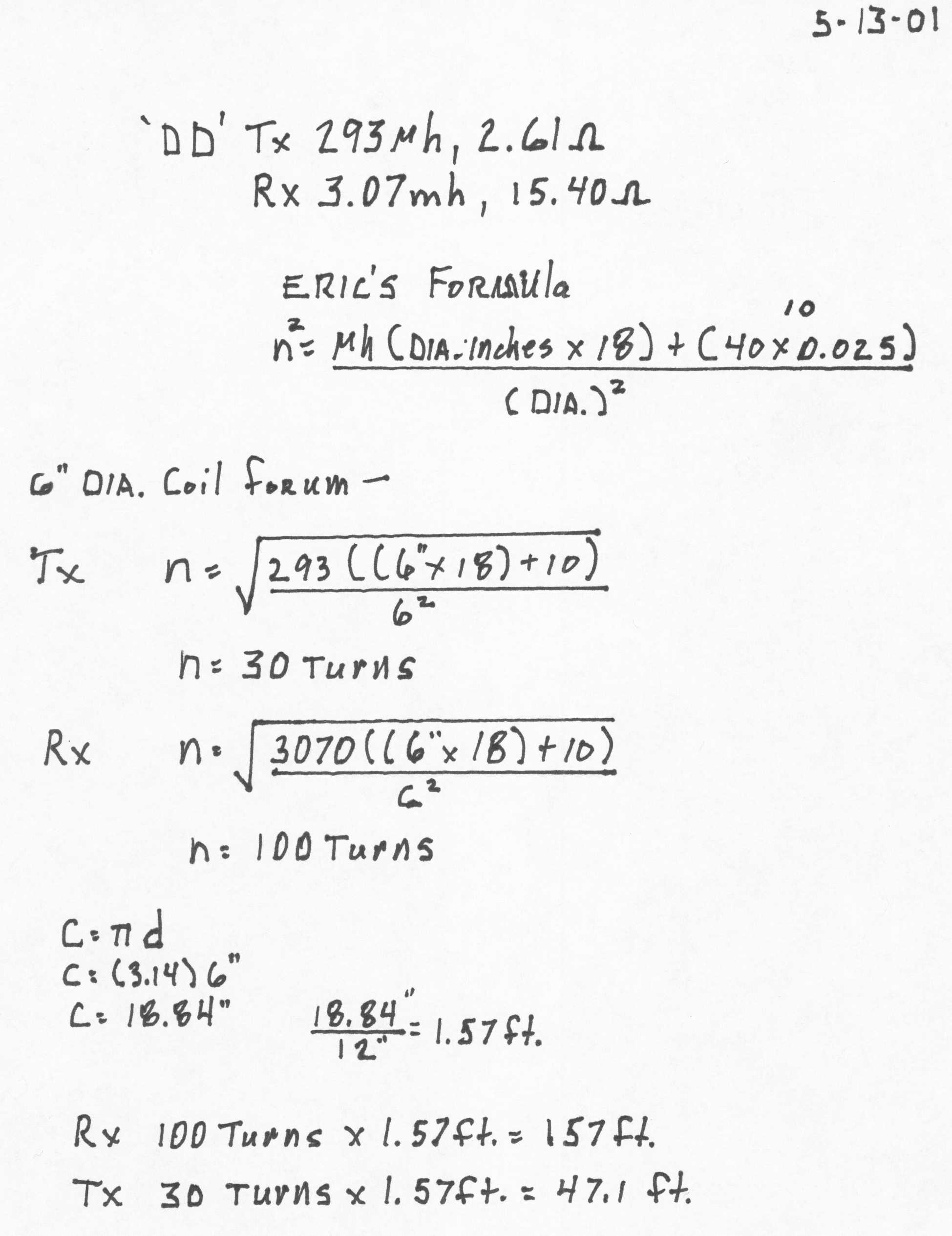

I need information about designing different types of coils (bigger than 10 inches). And do I need do make some adjusment on PCB. Also, what shielding do you recomend? Is it the best to use aluminum pipe from TV antenna, as I heard?
