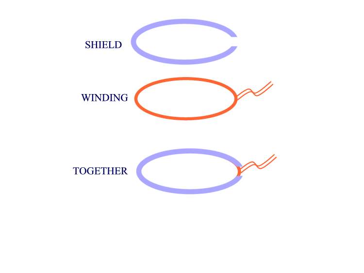

    Hi Red,
    I have used both the lead foil and the polyester tape you mentioned and had good results with both. Don't worry about being able to detect the lead foil when it is waved at a distance.
    Now, the trick to the foil causing little problems is it has to be wrapped around the windings and not just placed in the housing. So, think of the lead foil shielding as a personal winding coat. If this is done correctly, then the lead foil doesn't become a major player in what you detect even though you can detect a strip of it some distance away. When it is close to the winding, other factors come into place and the foil detection is minimized. It does become a bigger problem when working with DD coils.

    Here is an intersting tidbit. I have used metallized ribbon I bought for a few bucks from Walmart also. One side of some of the silvery ribbon is conductive enough that it can be used as a shield. This works fine for electrostatic shielding but doesn't do quite as good of a job of noise shielding. However, if the detector is used away from major noise generators, then this isn't a problem.
    In any case, one should space the shielding from the winding just a little, maybe using spiral wrap or even something as simple as plastic wire loom over the windings. Then place the lead foil over the spiral wrap tightly. Just make sure that everything is tight, so there is no movement between the windings and the shielding.
    So, before giving up on the lead foil, just remember to use it as mentioned and I think you will find it will work just fine.
    Reg
      Here is a pic that, hopefully will display what I mean about the shielding and the windings. Once again, there has to be a space or a gap in the windings along the circumference. The best place to do this is where the wires come out of the coil. Normally, this gap can be quite small, maybe 1/8" to 1/4". I have displayed it larger just to show what I mean. I did not show the spiral wrap in this simplified pic. The spiral wrap would go on the windings and then the shield would go on the spiral wrap.
      Reg
