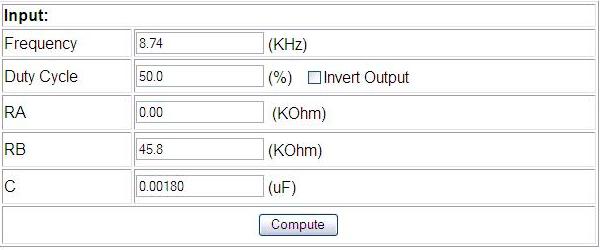

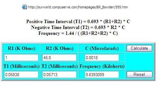

      I use this calculator in Bill Bowden's page. Always this calculator requires the RA resistence. For example, I need a frequency near 8.7 kHz, 50% duty cycle. The second calculator always requires the lowest resistence and show interval times positive and negative in milliseconds. See the small difference:
        You can also easily do the calculation yourself with the following formula ->
        f = 1/T = 1.46/([RA + 2RB]C)
        where RA is the resistor between pin 7 and VCC, and RB is connected between pins 6 and 7. The capacitor C goes from pin 6 to ground.
        The duty cycle D = RB/(RA + 2RB)
          OK, is very easy to calculate with this formula. Thanks.
