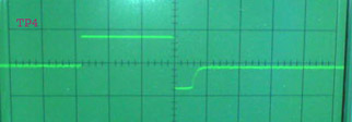

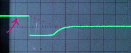

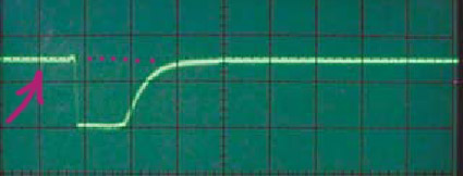

            TP4
            My HH's TP4 waveform has difference with the HH article's waveform.
            Is it cause to changing the TP9 voltage?
            Mine:
            Carl's:
              1843,
              Where did you put the scope probes on the Hammerhead schematic when making the photo that you just posted?
              bbsailor
                I put the scope probe to TP4 and its GND to the +VB.
                  1843,
                  Can you adjust R18 to obtain 0 V at TP4?
                  See the adjustment procedure in Carl's Hammerhead article.
                  bbsailor
                    Yes
                      Yes, I did adjust it to zero.
                        1843,
                        Does this adjustment of 0 V at TP4 make your waveform look like Carl's?
                        If not, look at the waveform driving the the gate of the MOSFET to see what it looks like. First look at the waveform across R6 to see that it is being driven by Q1, 0V to -VB and then check that Q2 is driving the gate of MOSFET Q3 with an adequate drive signal across R9.
                        bbsailor
                          The waveform across the R6 is from 0V to -VB, But the Gate driver waveform is from -3V to -VB.
                          Is it OK?

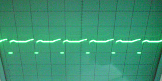

                              Carl,
                              I don't know why my HH TP4 has difference with your.
                              All the my HH problem depends to it
                              It has a maximum at 4V (or5V - depends on coil using) and a minimum at -4V and its remainder is at 0V.
