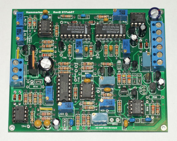

Since enough folks have asked for PCBs, I decided to make another batch. However, I wanted to add a few enhancements to the design. They are:
Attached are the schematic and PCB. Feedback encouraged.
- Carl
- Option for mono coil or seperate TX/RX coils
- Added a diode to the master clock 555 to make it easier to flip the duty cycle. (Useful for active pulldown)
- Added a low battery indicator.
- Changed the audio for non-VCO option. The 555 that is normally used for VCO is now used for non-VCO to set the audio duty cycle when the audio frequency is synced to the clock. You can also use the 555 to run the audio at an entirely different frequency than the audio, useful when you want to use a clock outside the preferred audio range.
