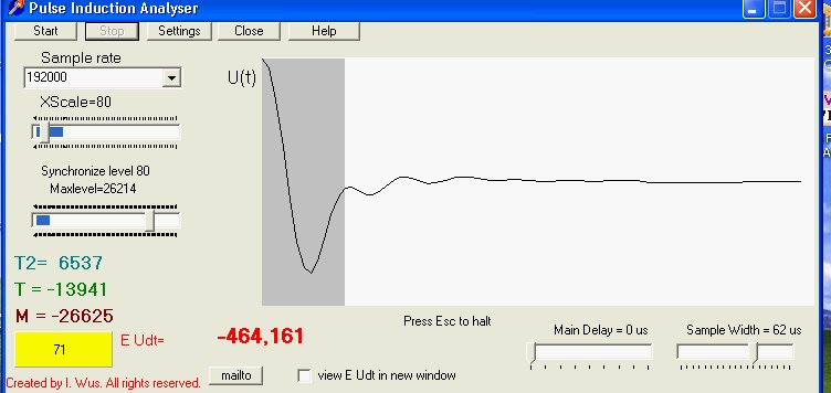

                      • #56
                        HammerHead PI
                        Hi!
                        Using my program (for digital processing) I get the following image at TP4. At it is visible oscillation of coil. How is reason this? May be capacitance of IRF740 or coil?
                        • #57
                          Originally posted by cko47 View Post
                          Hi!
                          Are using the correct value of damping resistor? It looks like the coil is underdamped.
                          • #58
                            Than You for your quick reply.
                            The damping resistor R11 is 1 kom.
                            The bottom peak on the image (in time) lays somewhere within the limits of 30-40 microseconds. It it is too much for search of gold nuggets of the small size. I shall try to reduce the mentioned resistor (R11) up to 680 om
