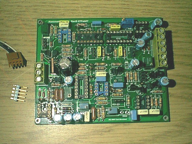

    I thought it might be fun to create a thread of Hammerhead board pics since quite a number of people are building them. Here's mine, not quite finished, waiting on 100k pots and 47u caps.

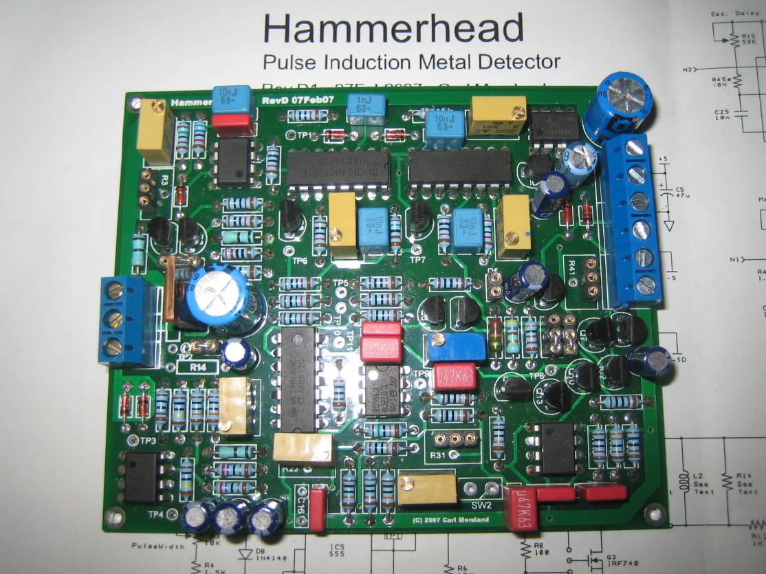

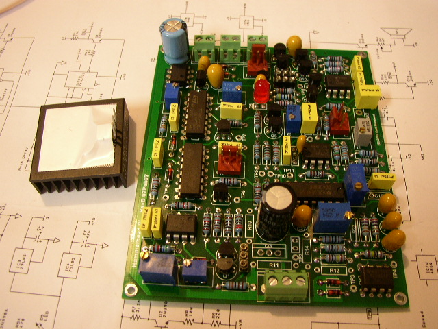

    Here is my version. I am using the active pulldown option. The fet I am using has quite a low Coss but it is only rated for 3A continuous, so I am mounting it underneath the PCB with a very effeicent sink attached. I used tantalums where needed and all resistors are metal film. I still need to finish my monocoil to calculate R11.

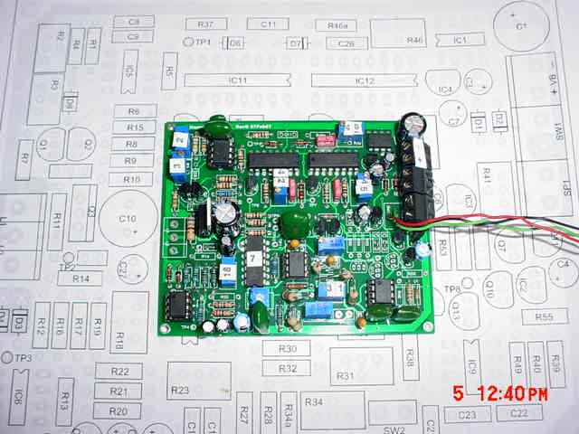

      I've got mine stuffed.
      Time to put away the soldering iron and get out the scope. I used pin headers for the pots that run externally and for the jumpers. The pins came from old motherboards and the connectors from an old VCR I stripped.
      Now I know why I keep all this stuff.

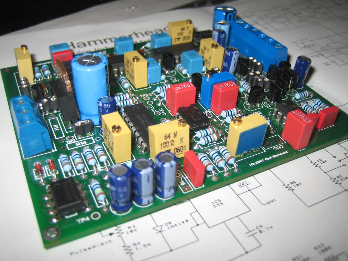

                  Calibrated. Still needs the coil installed and the onboard pots replaced with pin connectors, then into the box she goes!
