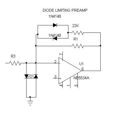

                      One other thing you might want to try is something that I came up with that was posted on another forum and that is to add a diode and resistor combination across the feedback resistor of the preamp. The basic design was posted on the PI forum by another guy to whom I had sent the idea, so I will show it here. Now, if the gain is changed from the original, then the 22K resistor will have to be changed. You could experiment by using a 25K pot, and may find you will have to go down to a low value of 2K or maybe less at reduced gain.
                      What this little circuit does is reduce the gain and speed up the preamp which also allows for a little faster sampling, but more importantly, it reduces the ground signal. In some cases, the reduction is enough that no ground balance is needed, which effectively increases the depth capability.
                      Finally, the IC noise is still a problem when searching for small gold because it interferes with hearing the very weak signals. My little diode circuit allows one to use some other low noise IC's that won't work without it. Right now, I have another IC coming my way I want to try. I have been able to use the AD797 which won't work without the diode circuit, but have had to reduce the resistor value even more. Unfortunately, the AD797 is quite expensive and does require a little more reduction than I would like to use. So, I am always looking for the ideal replacement for the NE5534A.

                        Hi Gef,
                        For some reason the pic of the diodes and resistor circuit across the preamp didn't attach. So, I am trying again. The addition of the two 4148 diodes and the 22K work well on the high gain of the original HH. If the gain is reduced significantly, then the 22K will have to be reduced accordingly.
