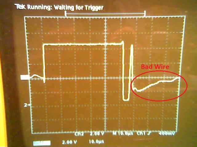

                          Hello Molzar,
                          I also encountered this problem.
                          My previous use AWG 22
                          for this problem I replace the wire email with a small size AWG 28 - AWG 30
                          I found some wire emails have poor results, I do not know why like this
                          Wahyu.
                            Originally posted by Wahyu View Post
                            Hello Molzar,
                            [ATTACH]39481[/ATTACH]
                            Wahyu.
                            That's not due to "bad wire". As you can see in the scope image, the coil is underdamped. You must change the damping resistor to a lower value for that particular coil.

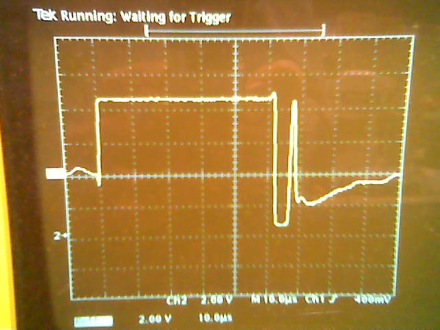

                              Hello Qiaozhi,
                              I have been looking for a critical damping for this problem, but the curve as red circles remain, after I change the wire emails, the curve becomes normal.
                              although coil is underdamped but if you use a good wire,result not like the red circle
                              underdamped for good wire result like this ;
                              Wahyu.
