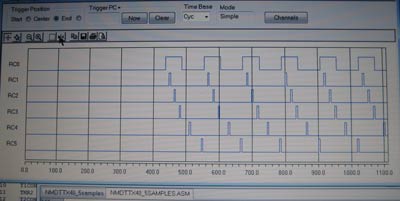

      PIC timing
      Attached the PIC timing

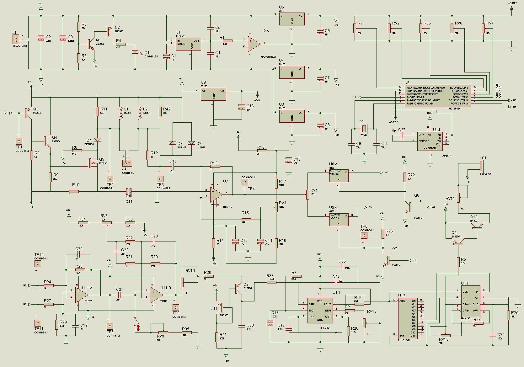

          Hey again, all,
          The schematic below is gettin' about close to copper, I hope. So I'm asking: any thoughts or things anyone thinks I missed?.
          I added the option of the diode/resistor/mosfet combo just to allow for playing with it. So far it looks like the jury is still out on that one.
          I also decided to just go for it and get rid of the original timing circuit.
          I've replaced the 555 clock and 74HC221's with a MicroChip PIC 16F684 and I'm starting on the code now. I should have a few sim results soon.
          The usual LCD display is conspicuously absent.
          I can tell where the knobs are set, and I really don't see the need for a redundant, power sucking LCD display that I'll hardly ever have time to
          look at (hillsides, rattlesnakes, open mine shafts, U/W, et al).
          And now for my 'odd' one,
          I really can't stand the 'growl' of a square wave VCO, so I thought I'd try something different. So... IC10, IC12, and IC13 comprise a voltage to
          frequency sine wave generator for a smoother sound (I hope).
          I've ordered the chips to test this idea out on my working HH, we'll see.
          I have no idea if the transistor pair still needs to go between the final op amp and the new VCO circuit or not. Any ideas? Thoughts?

            U14
            Well, I noticed one glaring error...U14 should be at V+ for the pwr pin, not at +5vD, oops. There's probably a few more. The sine wave vco parts should be here by Sat. or Mon., we'll see how that idea works then.
            BTW, Here's the thinking on the VCO sine wave circuit:
            IC13 is a switched-capacitor lowpass filter. The clock frequency, provided by IC10, determines the filter's 3-dB corner frequency in the ratio of 100:1. Thus, the corner frequency is 100 Hz if IC13's clock frequency is 10 kHz. Meanwhile, IC12 divides the clock frequency by 64 to provide the input to IC13. Because the input frequency is higher than 1/100th of the clock frequency, only the fundamental of the square-wave input can partially pass through the filter. The fundamental passes through the filter with about an 8-dB loss. The total harmonic content is lower than 60 dB.
            That's the plan, anyway,
            Laters, GTB

              It would be good to use a MOSFET driver to drive Q5. Much faster switching than the transistors.

                Hey there, Tinkerer,
                Not a bad idea to try.
                I'll use TO-92 sockets to allow for some playing room with the choices on Q4 and Q3 (and SIPs for the biasing resistors).
                I also realized that I don't need the X-tal for clocking U6. I originally planned on using the output of R36 to drive an A to D pin on the pic chip for Sq wave audio out from another pin (much like the orig 555 setup). That required fast clocking on the PIC.
                Since deciding to try a separate sine wave output circuit (U10,U12/13), there isn't any reason for 20mHz clocking on the PIC.
                The LM331 should handle V:F square wave gen fine without the pwr grid spiking of the 555 (since that's what it's designed to do...). And hopefully, I got the sine wave gen circuit right*.
                That freed up a couple pins on the PIC. So...
                I've decided to add a SPDT switch between +5v and GND to IC6 pin RA5 (11) to toggle master timings between large and small coils (as to the effects of RV1-2, RV5-7. {Freq, Pulse Width, Main Delay, Sec Delay, and SecDel Width})*.
                As I get some code together, I'll post it for those following my antics.
                *ANY input is welcome (come on other guru's...)
                Thanks again for the input, Tinkerer. GTB

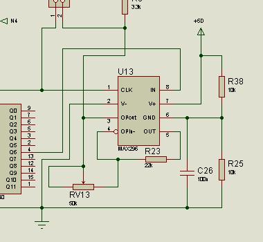

                  oops - U13 fix
                  Looks like I missed another one. Here's the fix for U13. I musta been pretty tired to forget/messup the pwr pins, duh.
                  Hopefully, that's the last of the dumb mistakes (uh huh).

                              Originally posted by GT Blocker View Post
                              Input, anyone? Thanks, GTB
                              You should avoid using junctions on crossing wires, like for instance:
                              U1-C4-C5-R1, R32-R31-R30-C23 and so on.
                              Some pins are left unconnected like U2:A for instance, most CAD software will generate an error flag in such situations.
                              Sometimes it's better to draw the inverting input of the OPAMP on the upper part and the non-inverting lower down. While that's not critical it does improve the reading of your schematics.
