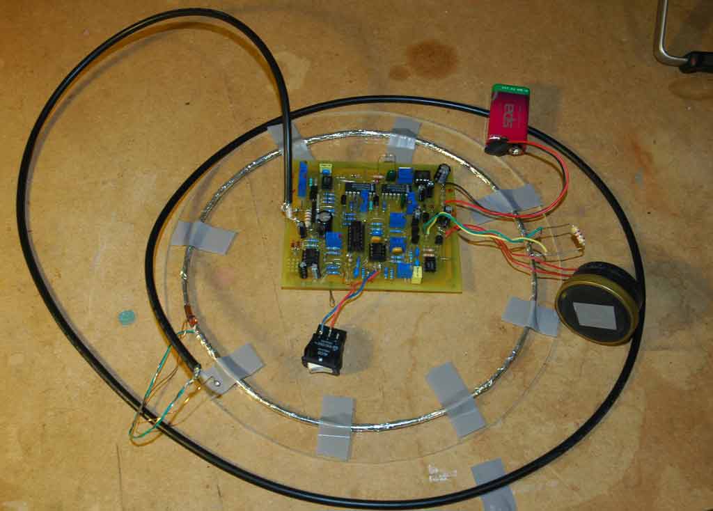

    Hi All,
    I've done some tests with my new HH board after tuning. I am interested if other people obtained better results.
    The coil is not properly made (29 turns 0.5mm enamel copper wire, coil diameter 200mm), shielded with aluminium tape straight over the wire).
    I use 1.5 meters of coax cable, 50 ohm impedance.
    Here are the results:

    I shielded the board into a kitchen aluminium pot put to the ground, lid included
    Large metals are detected from about 1 meter.
    I am not happy yet about the circuit because it still comes up with some noise every few seconds, although it wasn't too bad while shielded.
    I took the contraption for a test outside, in the yard. I couldn't find any place where to put the coil on the ground without beeping. Either the ground affects it, either there are plenty of junk metals all over the place (it can be possible). It was dark outside, I will do some digging tommorrow.

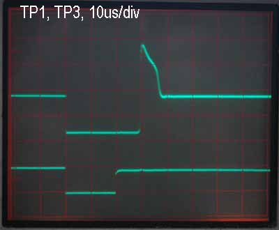

                Thinkerer,
                Thanks again for explaining how the alu foil acts, your pointed what I have to focus on. I will post another email with heaps of CRO shots, because I am not very happy with the high noise level at TP4 and about the idle audio chattering that I can't get rid of.
                In order to detect the alu foil, I already decreased the pulse width close to the minimum. At the moment, I have a Tx Pulse Width of 29us and the Pulse Amplitude is only 175V (I can easily get over 350V if I increase the pulse width - I set up this lower voltage just to decrease the delay time, to measure the aluminium foil).
                Ray-NM had a look at the photo of my device and noticed how the coil was built, and he is right about all the problems noticed. I am also aware of these matters. I am actually using a 12V regulated power supply, the battery was for some testing I've done outside.
                My coil has a diameter of 20cm, I think it has 29 turns with 0.5mm diam of enamelled wire. The sticky aluminium foil is placed straight over the wire, with no spacer in between. It has 0.492mH and the capacitance measured between the shield and the coil is 407pF (which I think is very high - but expectable, considering there is no spacer). I will read again the article about coils of bbsailor and try to make a better coil. I have to find some suitable spacer and apparently aluminium foil is not suitable for a fast coil. I have the chance to measure the self-resonance of a coil at work, which I will do later.
                Ray, the gap between the end of the shielding is about 14mm. Do you know how does this distance affect the coil and why should I try with a larger gap?
                Thank you both for your feedback, it is much appreciated.
                Nicolae

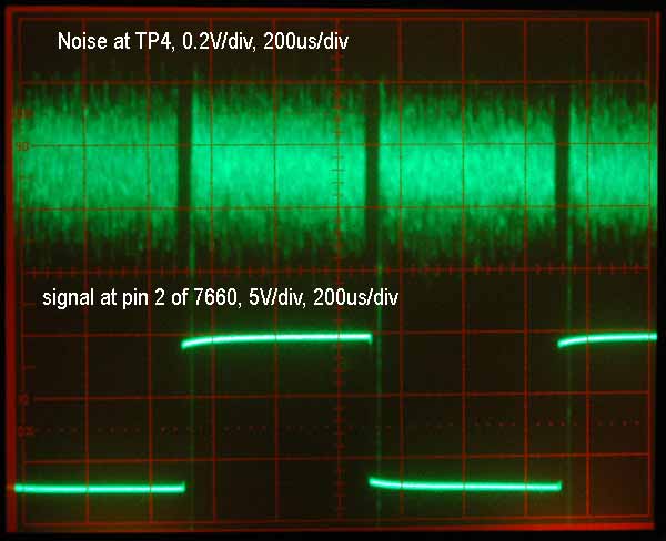

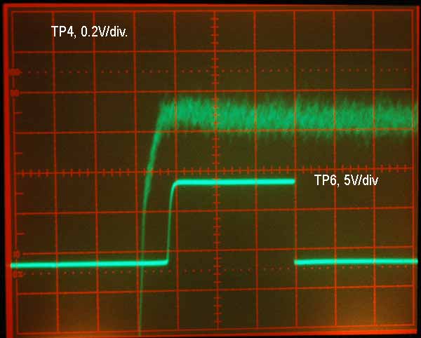

                    You may want to check the frequency of the noise on TP4 and make sure it's not power supply noise coming from the 7660's oscillation. Also, the gap in the shielding should be small as possible without touching.
                      Originally posted by hobbes_lives View Post
                      Nicolae,
                      Hello Hobes,
                      The noise frequency is much higher than the frequency of 7660 (which is also synchronised with the circuit). The noise has a period of 5us, which means a frequency of 200kHz.
                      Just to remove any doubts, I will replace 7660 with a 9V battery.
                      About the gap in the shielding, I decreased the gap distance to just a few mm. Not much change.
                      Nicolae

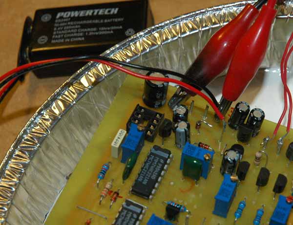

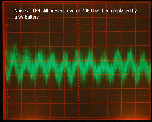

                        Just to confirm the noise is not caused by 7660, I removed it, I raised D2 off board and applied 9V to pin 3 of IC2.
                        The noise is still present, it didn't change at all.
                        To me the noise is more a self-oscillation of the NE5534. I will remove the socket of IC6 and see how the noise is affected.
                        Nicolae
                          Hi All,

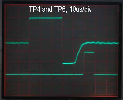

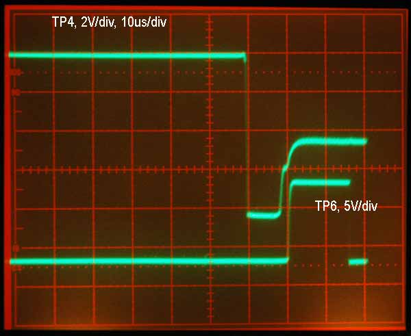

                          It looks like I found a convenient way to reduce the noise, increase the sensitivity to varios targets, including the 1 square inch aluminium foil, maintaining the same setup (the same bad coil I was using).
                          The solution was pretty simple: I added a 100k resistor on top of R13 and now the circuit is much more stable (I don't get all kind of random screaming noises when no target is nearby, as before). Maybe Carl should have added a pot to adjust the gain of IC6 as well.
                          Interestingly, I can adjust the circuit for even greater sensitivity (beer cap detected at 23cm and 1" square alu foil at around 2cm).
                          You can notice that also the pulse at TP4 is about 8us width, compared to about 12us before.
                          I don't know why the pulse now has that distortion on it, I will investigate (it is not due to pulse at TP6). I found out with big surprise that lowering the value of the coil resistor R11 increases dramatically the width of the pulse (I would have expected rather the opposite, or no change), so there are multiple advantages in using a resistor as high as possible.
                          Nicolae
