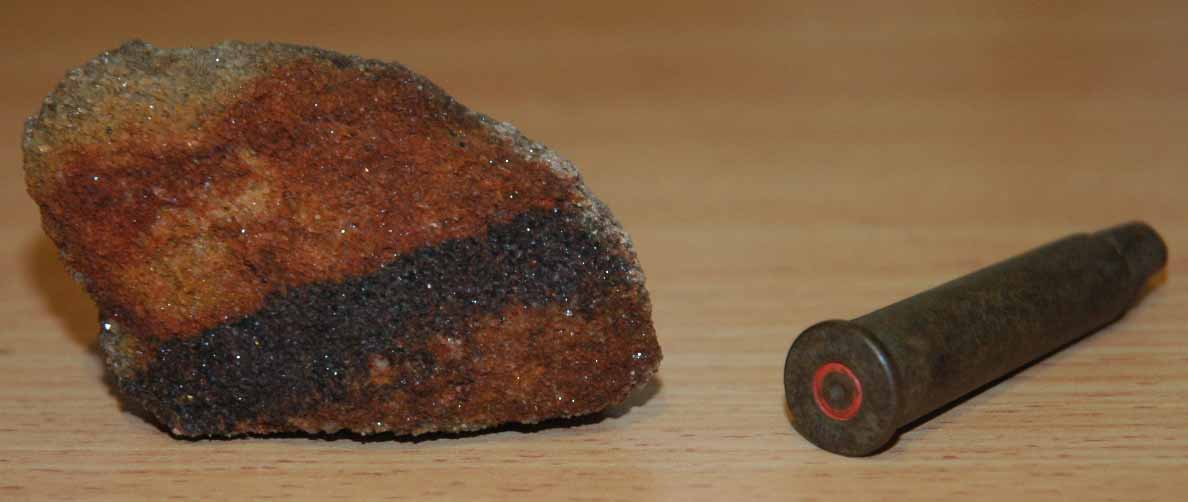

    The first few signals I dug were some hot rocks. I took them home. One of them wasn't actually a hot rock, but a piece of construction concrete, with a bit of rusty metal showing on an edge. I used a file to confirm that was metal. That piece looked exactly like a natural rock, it must have been sitting there for quite some years.
    The other two seem to be natural hot rocks. I split one apart with the hammer. It has a sandy constitution and has a colour close to a brick, with a dark band going through it and it shines in the light, like it has microscopical mirrors in it (maybe mica, I don't know). I will attach a photo for the ones curious to see how it looks like (and yes, I live in Australia, the land of hot rocks! ).
    The other interesting thing I found today was a riffle shell. I checked with the magnifier on the back and it has written .303MK8Z and what it seems like Russian characters - PPU-85. To me it looks like a shell from AK47. This is to prove how far the Russian Mafia has spread!
