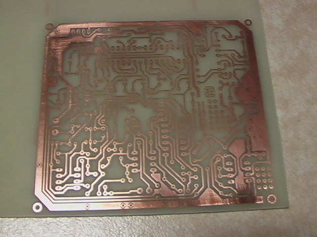

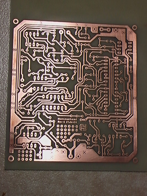

    Hi guys ...I have started th hammerhead project (wish me luck ) ...yesterday I made the PCB
    ...today I have just finished drilling the holes....

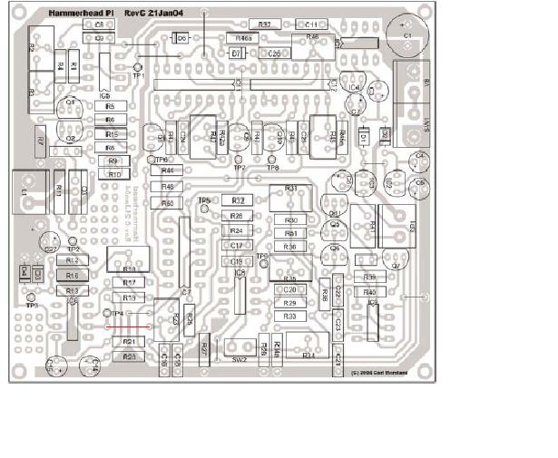

              Hi Carl thanks very much for your reply...I am going from the HHv1p5.pdf
              I was frantically trying to work things out. I am pretty new at all this so please bare with me...I am working off HHv1p5.pdf page 12 figure 18 I cannot work out where to connect the C10 to and its polarity.I have attached the pcb diagram from your booklet...can you please mark on the picture where to connect C10 to....Thank you
                here is the pcb option1 below
                    Also Carl R8 is in the parts placement diagram but not on the parts list ,should I leave this one out aswell ?If it is to be put in what is the value please
                      R8 is shorted. You are looking at the all-inclusive parts diagram, not the Option 1 version. Print out the Option 1 PDF and it will be much clearer.

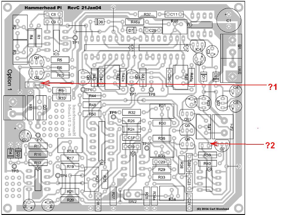

                        I am still not sure where C10 goes or connects to or if it is off the board can you please help me where it is to go...and also I have added a diagram below
                        with to things in it that im not sure about...they are marked ?1 and ?2
                        I am assuming that?1 is just a little jumper
                        and ?2 has nothing there just left empty is this correct please ......

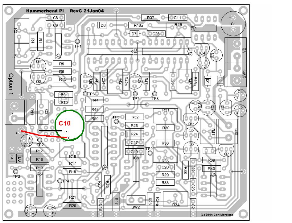

                          I think C10 goes here am I right or wrong Carl(picture below)
                            You are right about ?1 and ?2, and about C10. 79L05 should be easy, look for slight name variations like LM79L05. Same for the 7660... look for any kind of "7660". IRF540 will work fine.
                            - Carl
